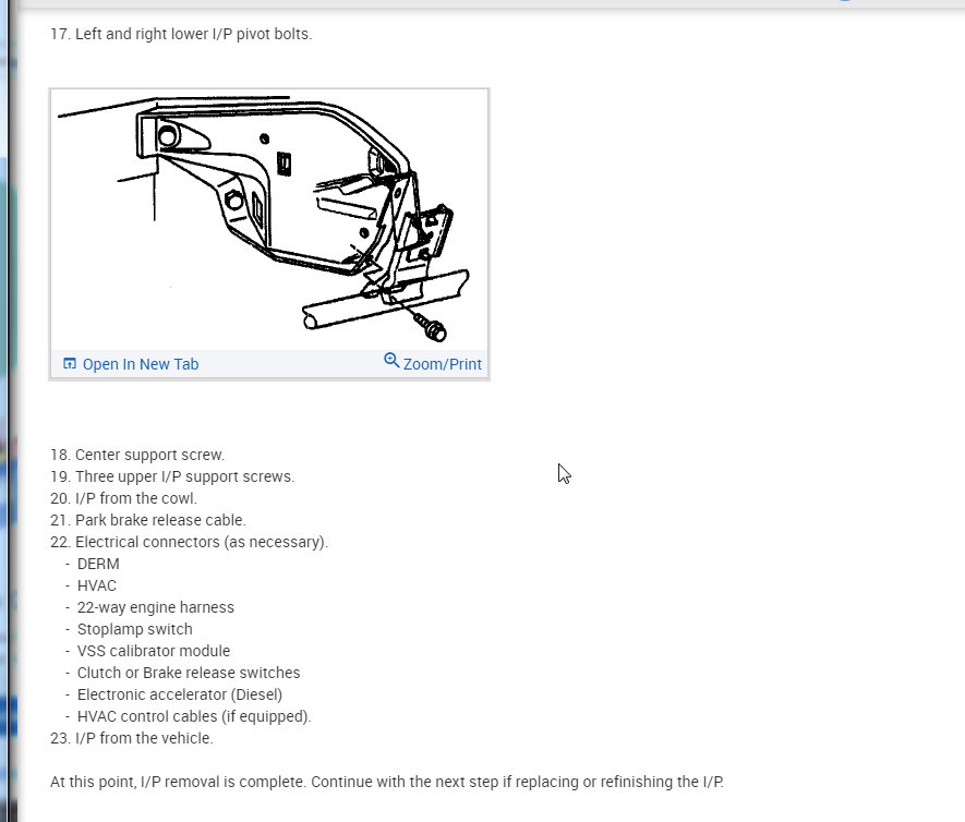

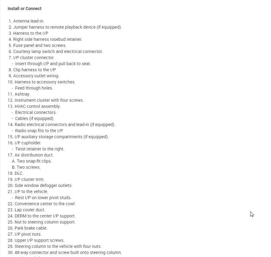

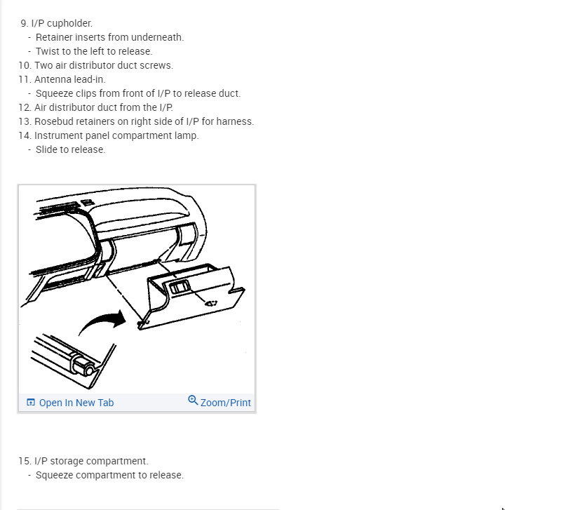

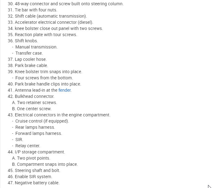

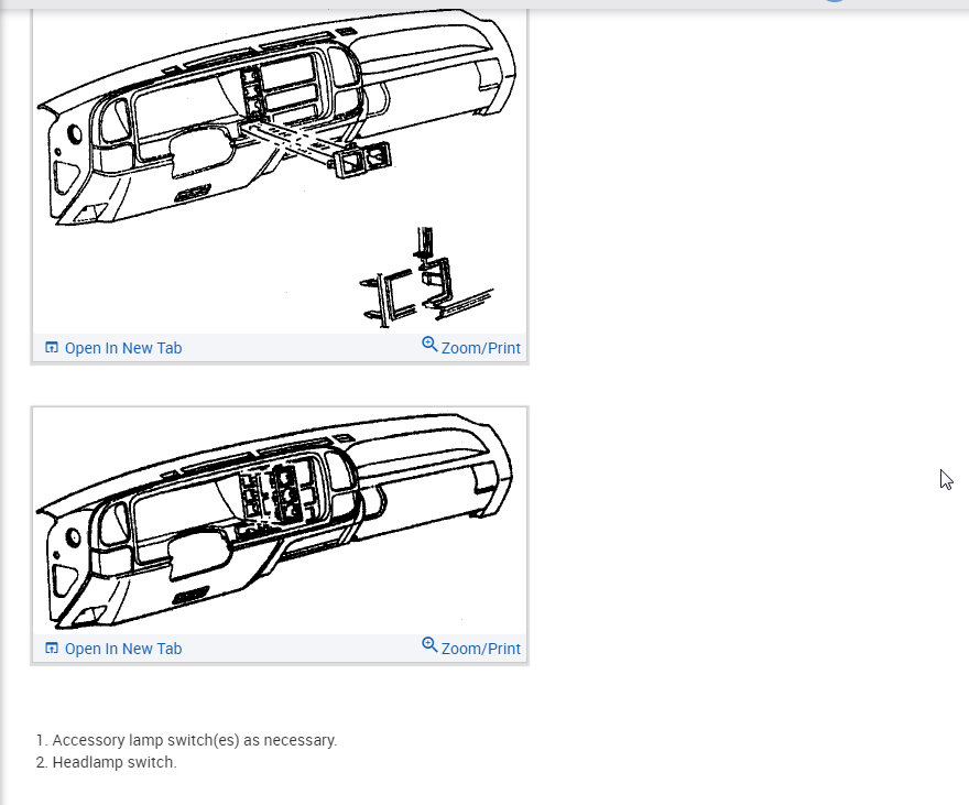

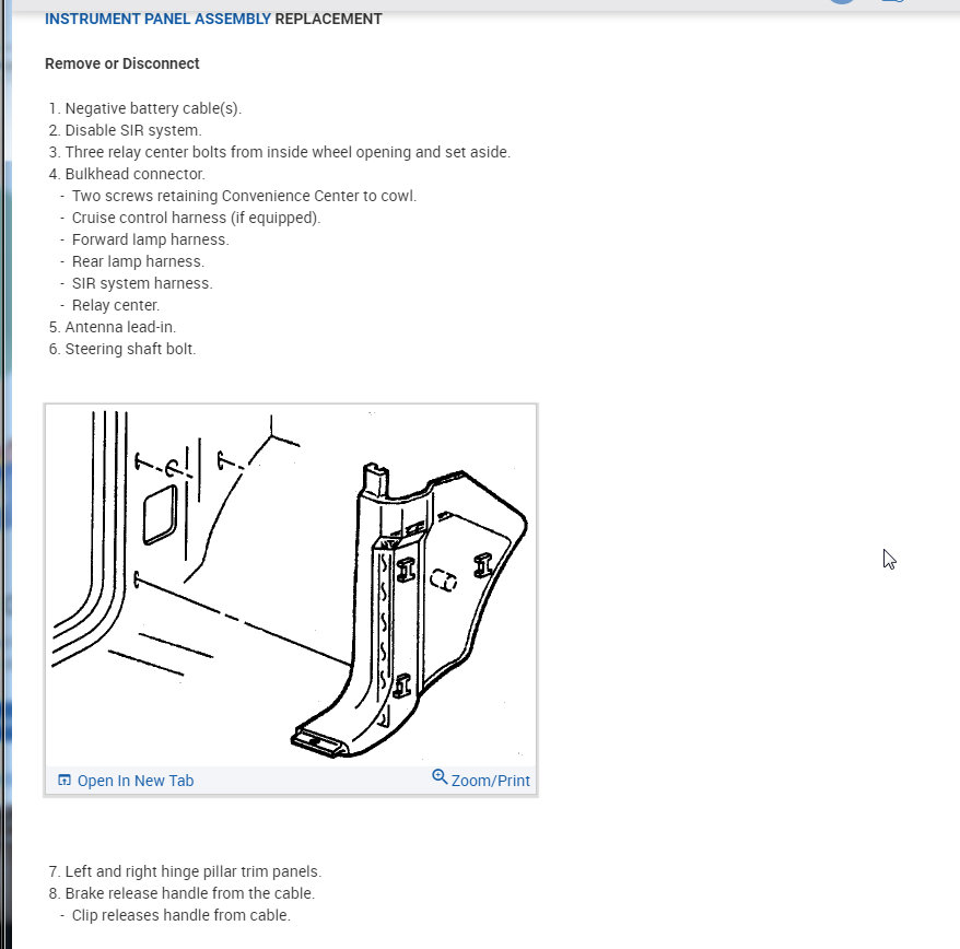

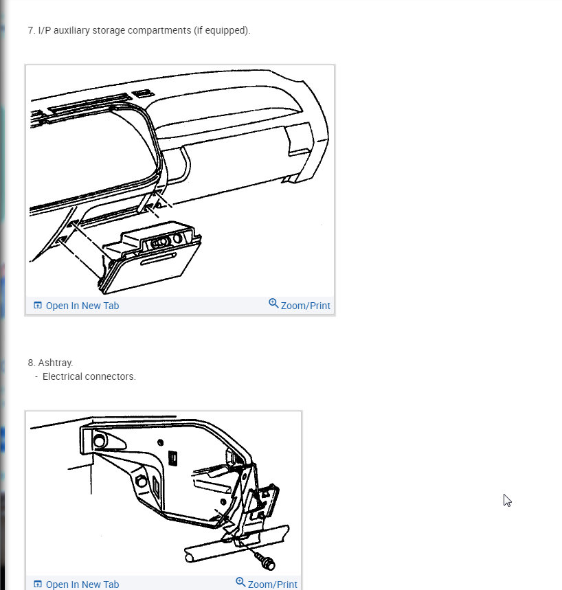

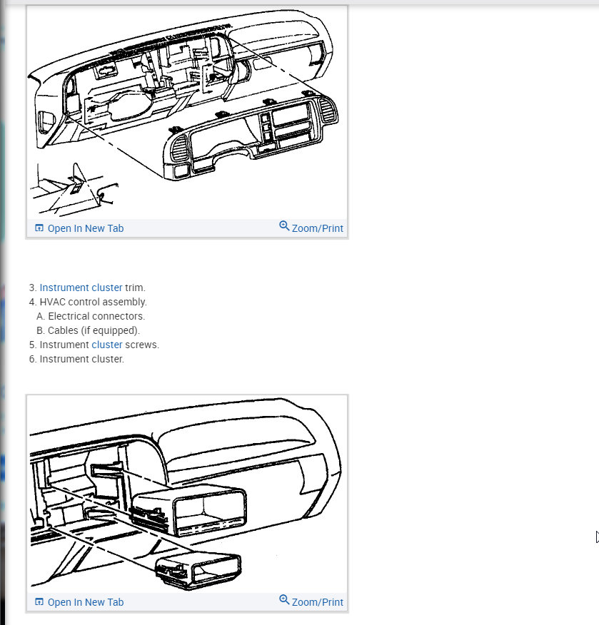

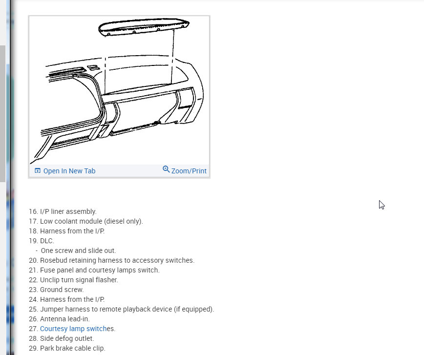

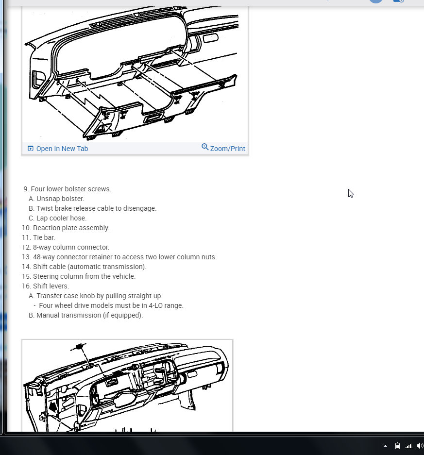

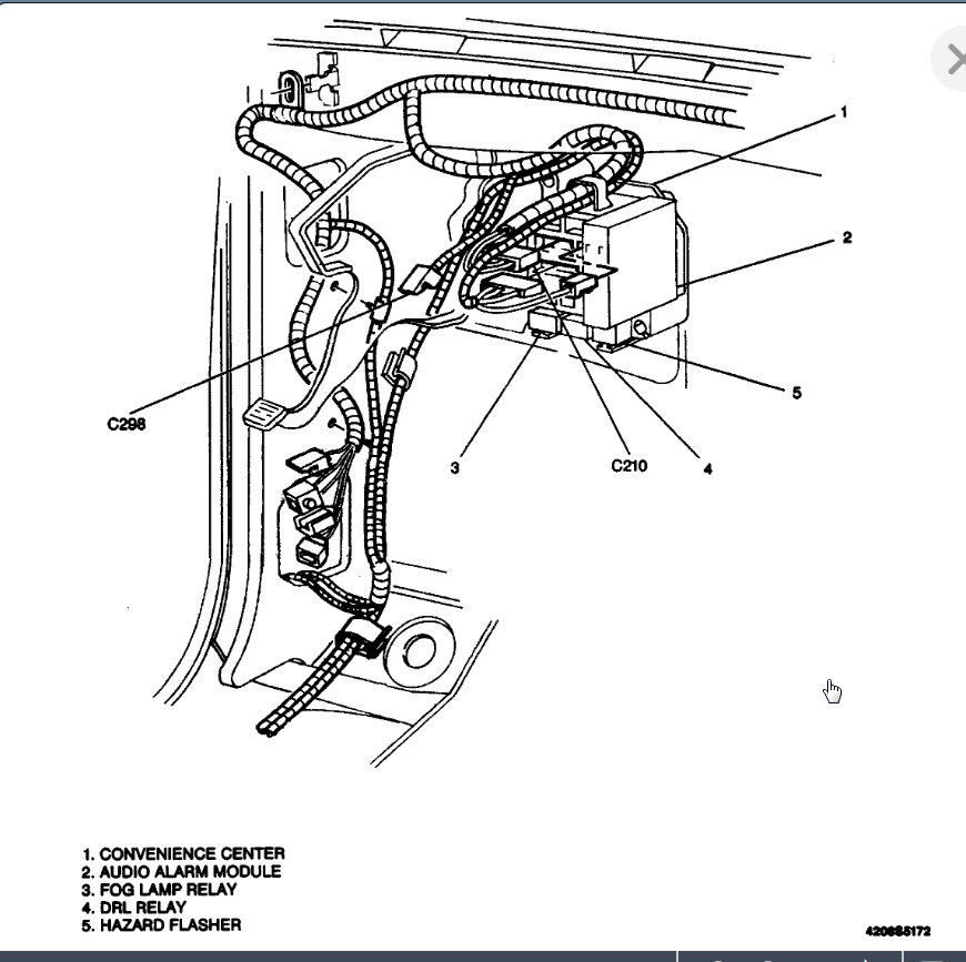

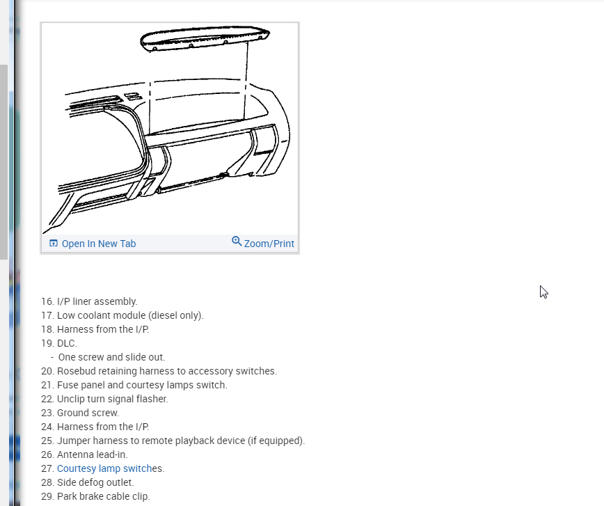

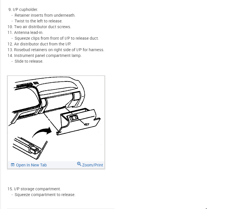

How do I remove the convenience center?
I have a short in the pin feeding power to the seats and door locks inside the convenience center, and need to remove it to make a repair.
Jul 17, 2020 at 7:15 PM
Looks like the way to get this out is to remove the instrument panel/dash. I attached the process for this and let us know if you need more info. Thanks
Jul 18, 2020 at 10:24 AM
GEORGE HUFF
Holy cow!
Okay, I will check it out.
