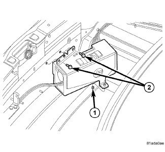

Here are the removal directions for the pump. The attached pics correlate with the directions.
_____________________________________________________
REMOVAL
pic 1
NOTE: The hydraulic system uses ARAL VITAMOL ZH-M fluid. When replacing components or topping off system due to leak, make sure to use only approved fluid. When adding fluid See: Convertible Top > Symptom Related Diagnostic Procedures > Water Leak Test .
1. Disconnect the battery negative remote cable.
2. Open decklid.
3. Remove the spare tire cover/floor panel.
4. Remove the rear trunk trim.
5. Remove the spare tire and jack.

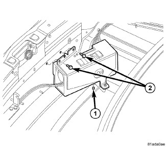

6. Remove the two bolts (2) from the pump assembly.
7. Separate the pump from the bracket:
a. Unwrap the insulation.
b. Disconnect the electrical connector and un-clip the push pin.
pic 2
pic 3

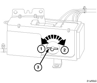

8. Release the pump pressure valve by turning it counter clockwise (1) two rotations.
9. Remove the bolts to the line retaining plate.
10. Move the lines and retaining plate out of the way.
11. Remove pump assembly from the vehicle.

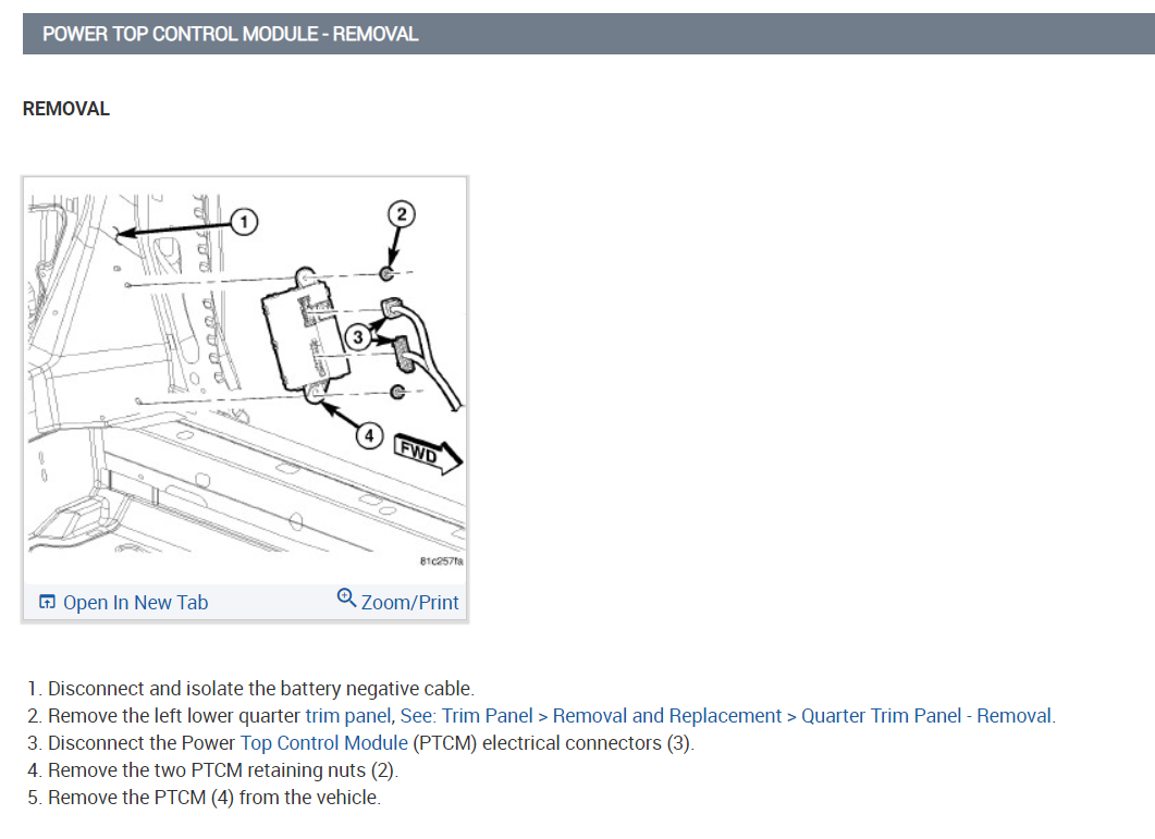

  • 55,402 POSTS

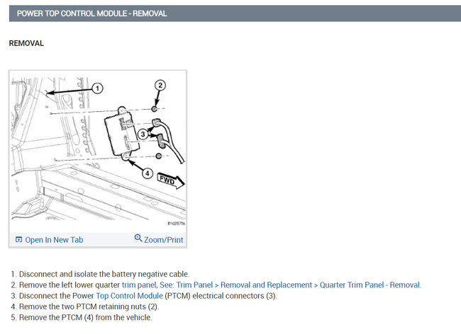

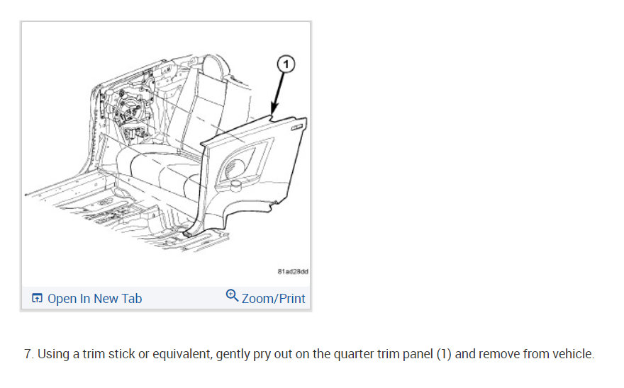

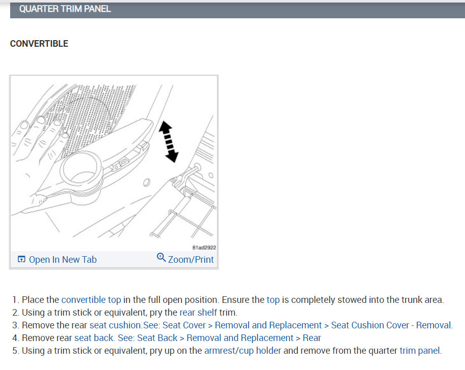

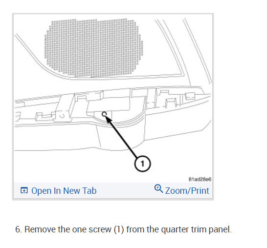

it is common for the control module to go out. here is how to replace it. Check out the diagrams (below). Let us know what happens and please upload pictures or videos of the problem.
