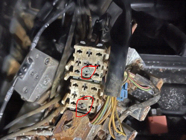

Looking at the last pic, it appears there are two places that could have a broken pin stuck in them. See pic below. Keep in mind, it's a little more difficult looking at a picture, but I believe that is what I'm seeing.
See pic below and let me know if that is what you are questioning.
Friday, December 17th, 2021 AT 7:54 PM
DIVIDES
  • 898 POSTS
Yes, that is what I think. Water or moisture has gotten in and caused corrosion on the wires as well as the pump. I ordered a harness, these relays and a pump. Thanks for your help.

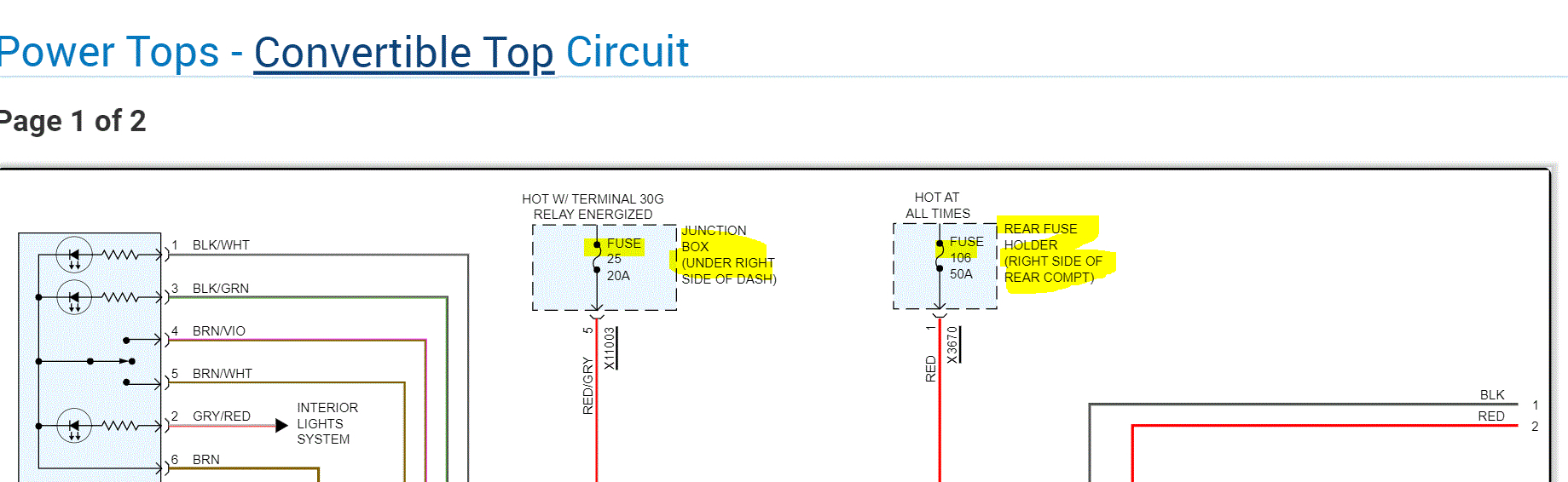

Once I replace it all, are these fuses to the top? Some may have failed due to the shorts or water, if you can let me know.
Saturday, December 18th, 2021 AT 9:30 AM
  • 109,885 POSTS
Looking at the wiring schematic, I see two fuses. One is under the right side of the dash and the other is in the right-side rear of the vehicle. I attached a portion of the wiring schematic identifying fuse number. The entire schematic is listed above.
See pic below.
Saturday, December 18th, 2021 AT 10:29 PM
DIVIDES
  • 898 POSTS
Replaced pump and harness and relays, all good now. Thanks for all your help.
