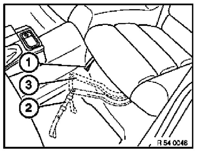

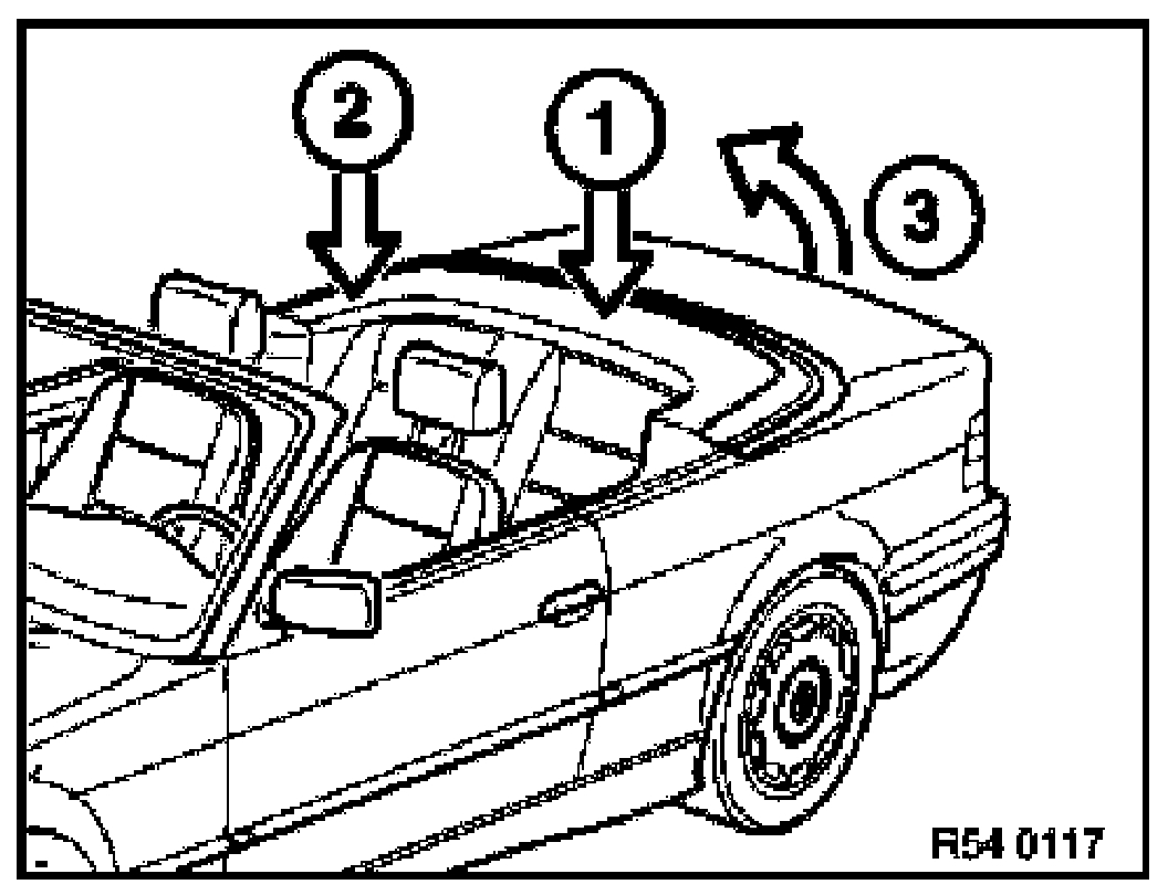

My convertible top is not working. the fuse is fine, motor seems to be fine, but I think the previous owner disengaged it somehow.

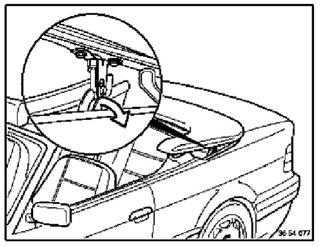

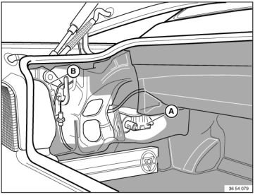

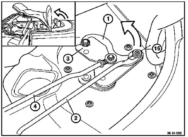

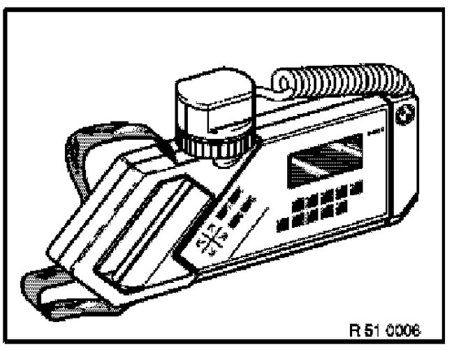

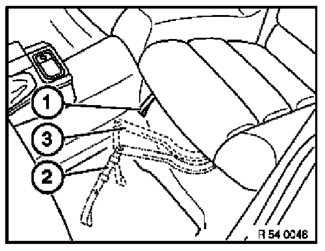

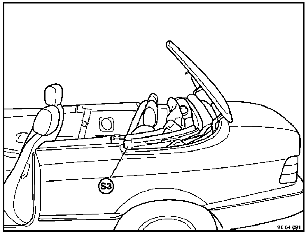

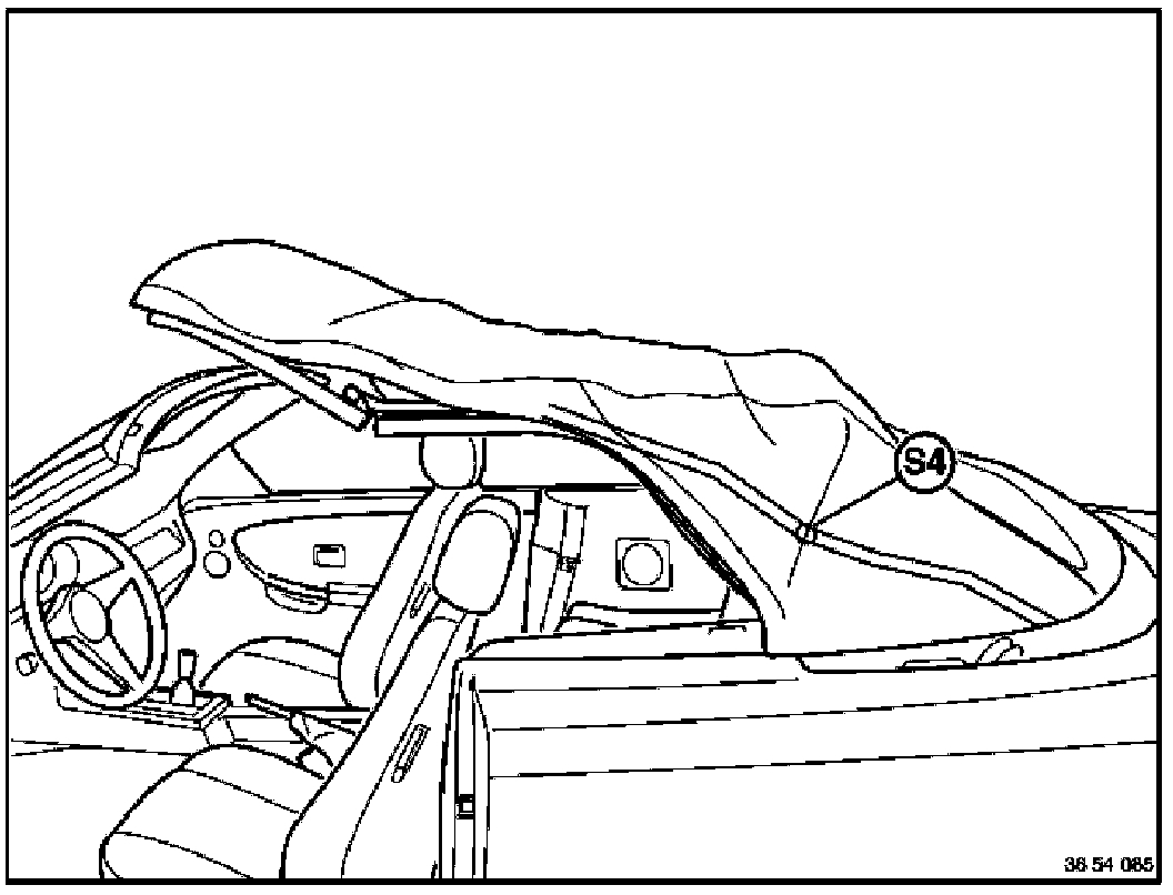

Do me a favor. Try this initializing process to see if it resets it. The attached pictures correlate with these directions.
__________________________________________
Initializing EM convertible top after emergency release (convertible top unlocked)
Connecting up drives:
Both drive units are unlocked and access in trunk is not possible (electrical forced locking of trunk lid).
Picture 1
Open side windows.
Turn central handle and raise convertible top over dead center point, microswitch (S4) cuts in (convertible top not overstretched).
Picture 2
Raise clamping bracket into upright position.
Picture 3
Open convertible top cover manually and store in convertible top box - micro-switch (S3) cuts in (convertible top stowed away).

Removing left luggage compartment trim,
Push motor (A) for convertible top drive upwards, engage and allow to locate.

Pull motor (B) for convertible top lid drive inwards, engage and allow to locate.

Initialization without diagnosis:
Prerequisite:
Convertible top stowed in convertible top box and drive units connected up.
Turn ignition lock into "0" setting.
Move convertible top switch into "open" position and hold down.
Turn ignition lock into "R" (radio setting) setting.
After approx. 10 seconds, the convertible top lid starts to close.

Emergency actuation of convertible top:
Open side windows and left door.
Push left front seat forwards and fold down.
Note:
No-one must be sitting on the rear sitting on the rear seat at this time.
Picture 11
The release lever is located at the left under the rear bench seat in position (1) (rest position). If necessary, lift up rear bench seat.
Pull release lever forwards with grip into position (2) until both drive units disengage audibly.
After being released, the release lever returns to position (3).
Caution!
When drive units are disconnected, only drive with convertible top closed (it is then not possible to lock the convertible top lid).
The convertible top lid and convertible top can now move freely.
Installation:
Before engaging the drive units, slide release lever fully back into position (1) (engagement not otherwise possible) and allow bench seat to reengage.
