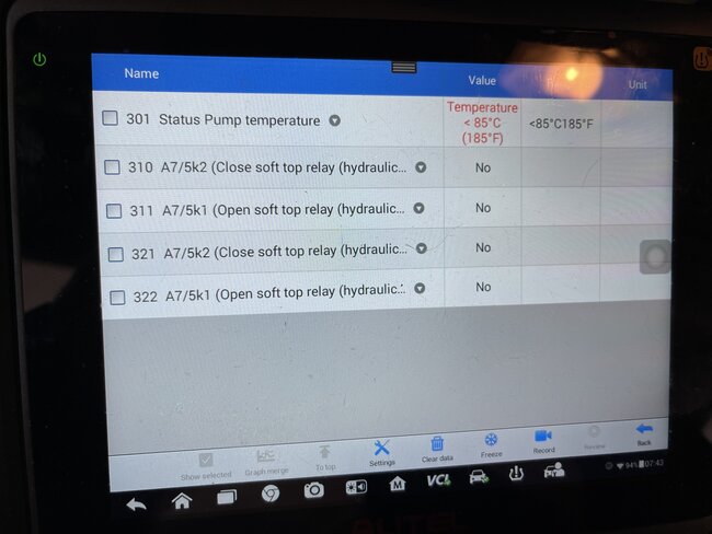

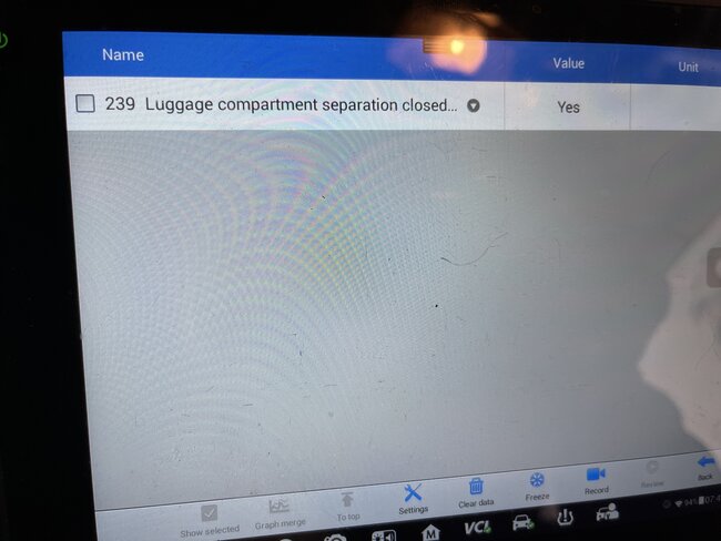

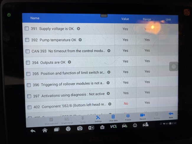

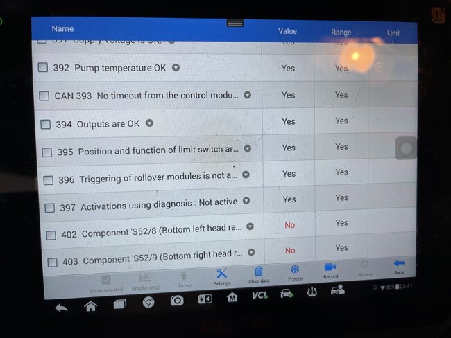

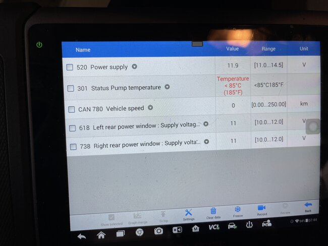

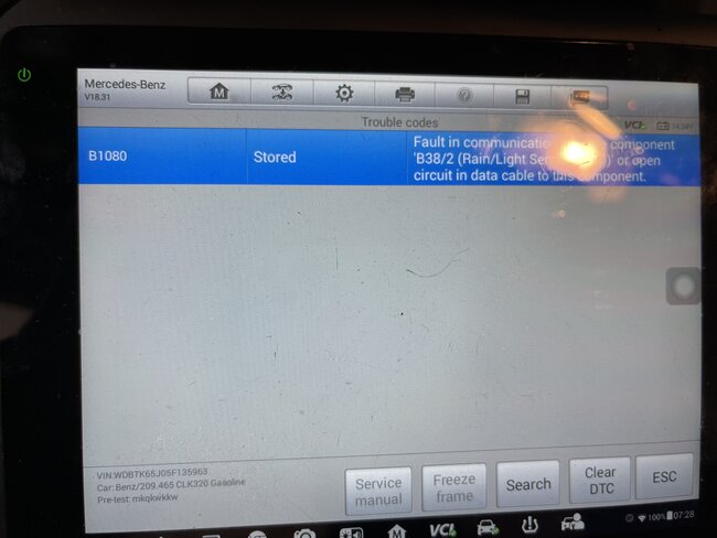

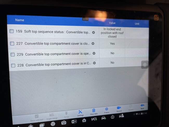

It keeps giving a message to visit shop after it makes an unlatch sound, but nothing moves. I know fluid is low but even so it should at least try to move and show a sound of hydraulic. I can't get any codes.
Nov 3, 2023 at 1:36 AM
BHAMDOC1973
  • 2,007 POSTS
Also, if i hit the close button makes this sound.
Nov 3, 2023 at 1:37 AM
BHAMDOC1973
  • 2,007 POSTS
No codes.
Nov 3, 2023 at 1:45 AM
  • 55,743 POSTS

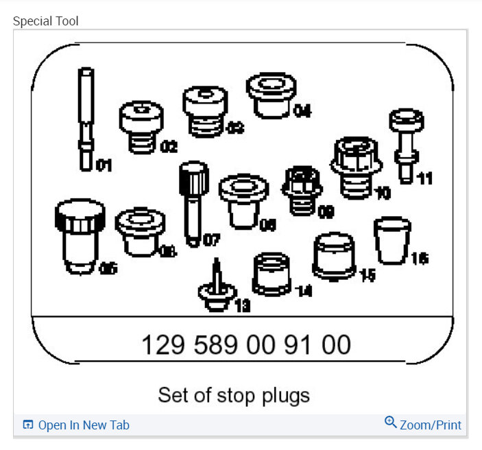

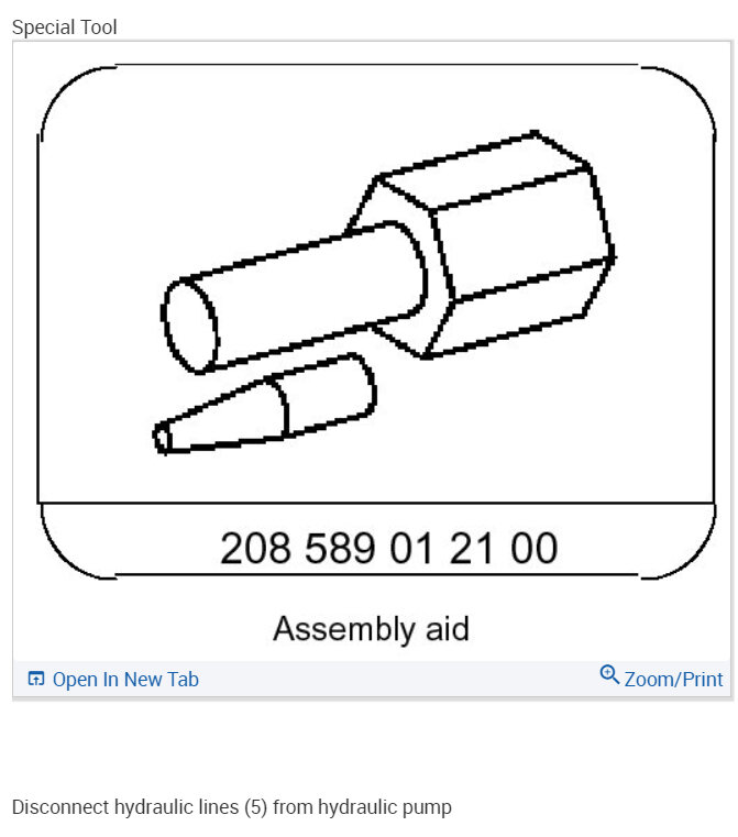

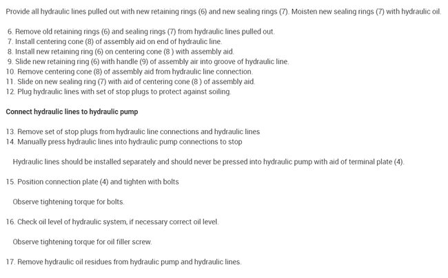

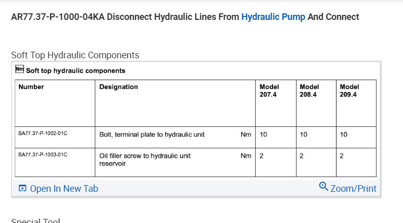

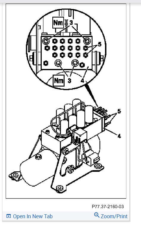

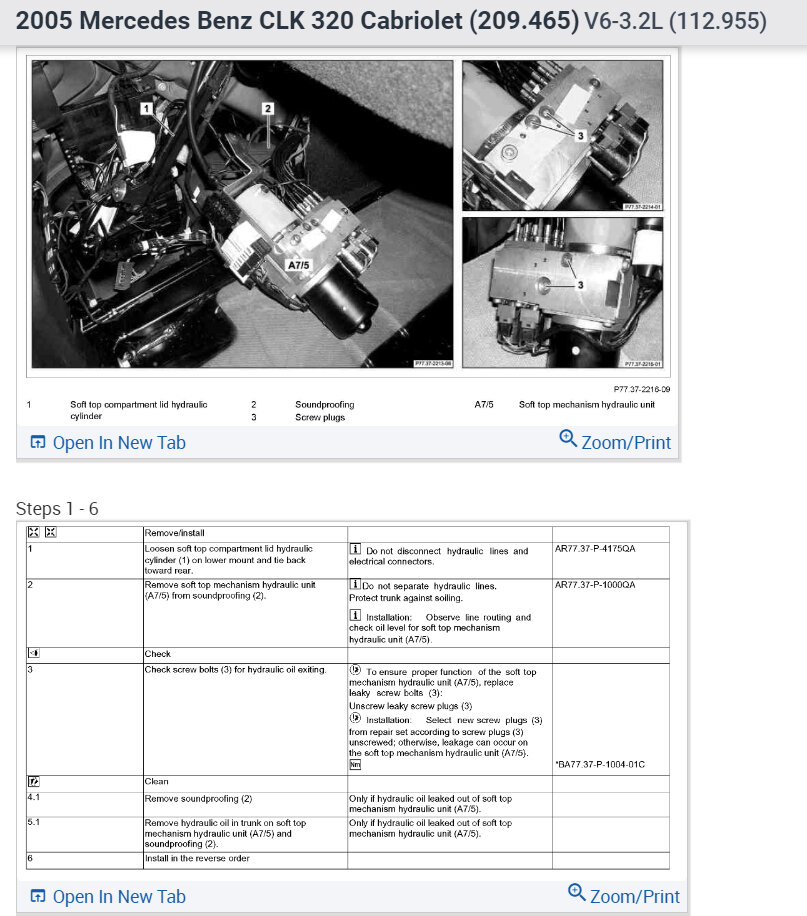

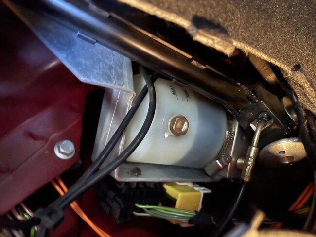

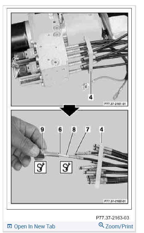

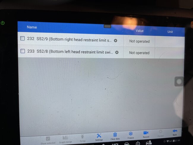

It sounds like the motor is weak which is common, also I see in the video the headrests seem to be hitting the top? The system self-bleeds, here is how to change the pump motor control module. Check out the images (below). Please let us know what happens.

How to put the headrest down on these?
