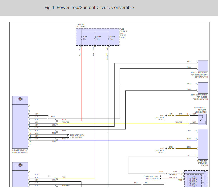

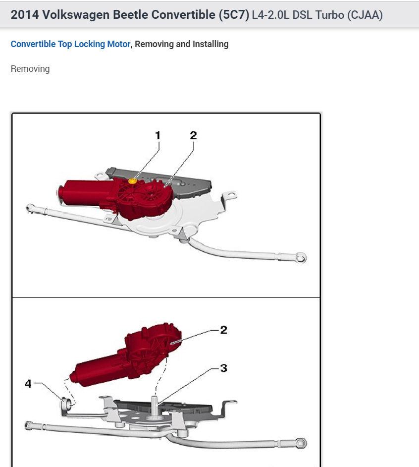

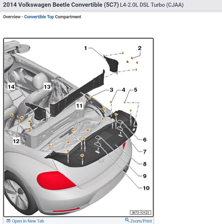

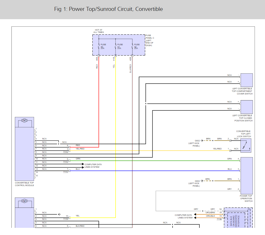

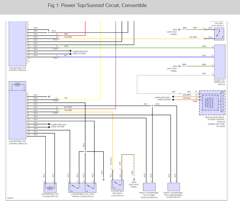

I can get it to go off by re-closing roof but it will start going off again. Replaced top lock motor and assembly.
Dec 14, 2018 at 10:30 AM
  • 55,412 POSTS

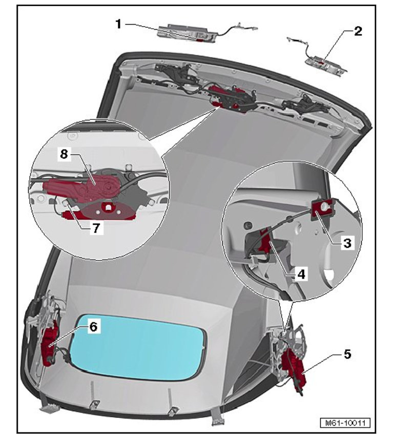

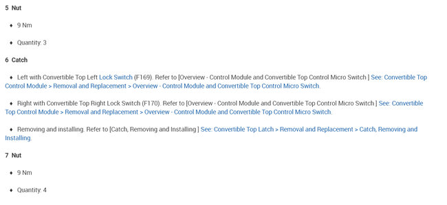

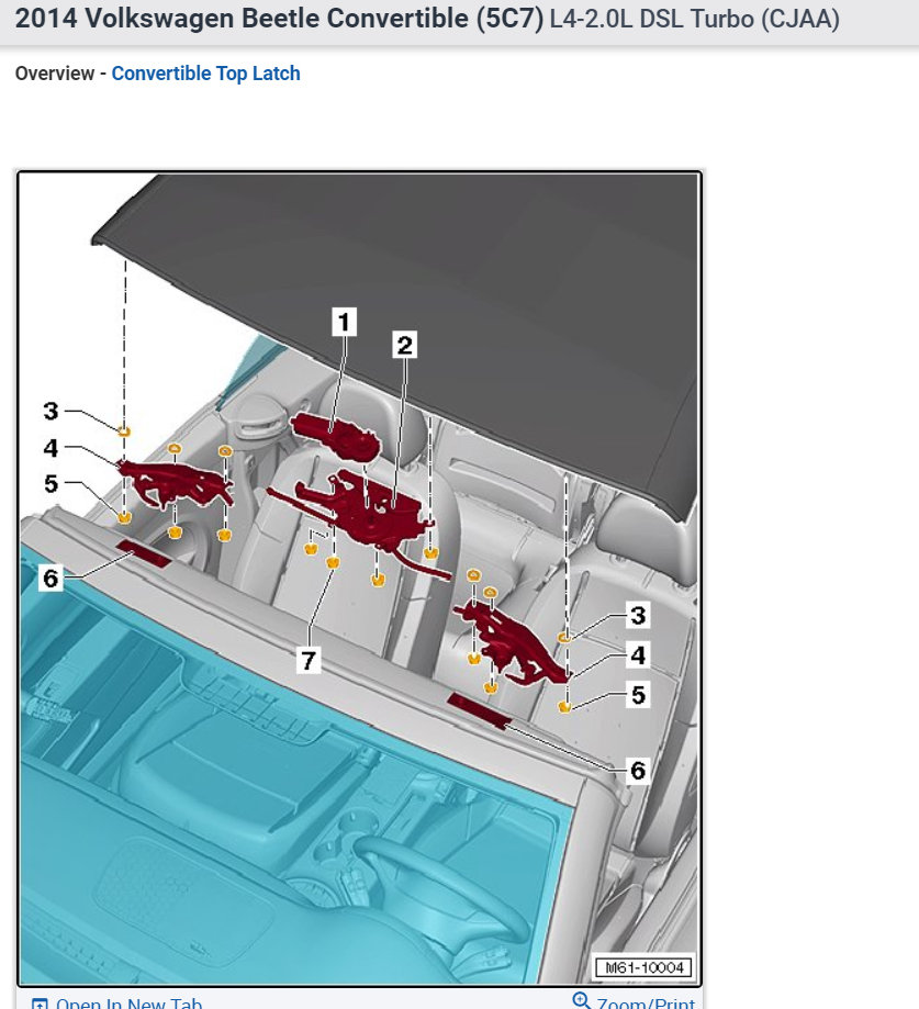

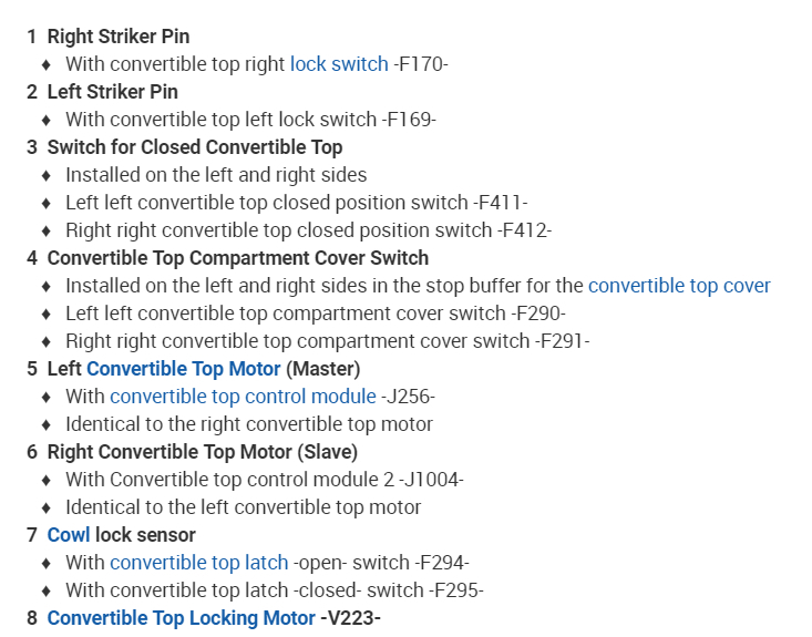

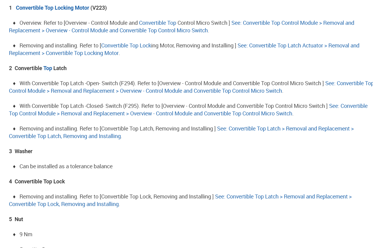

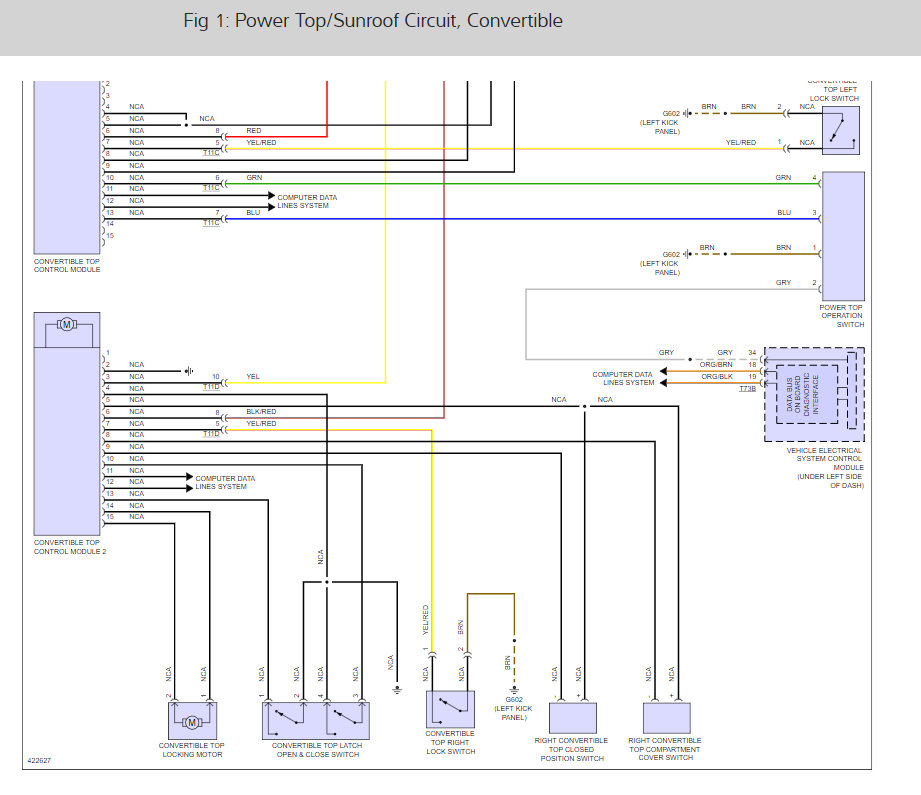

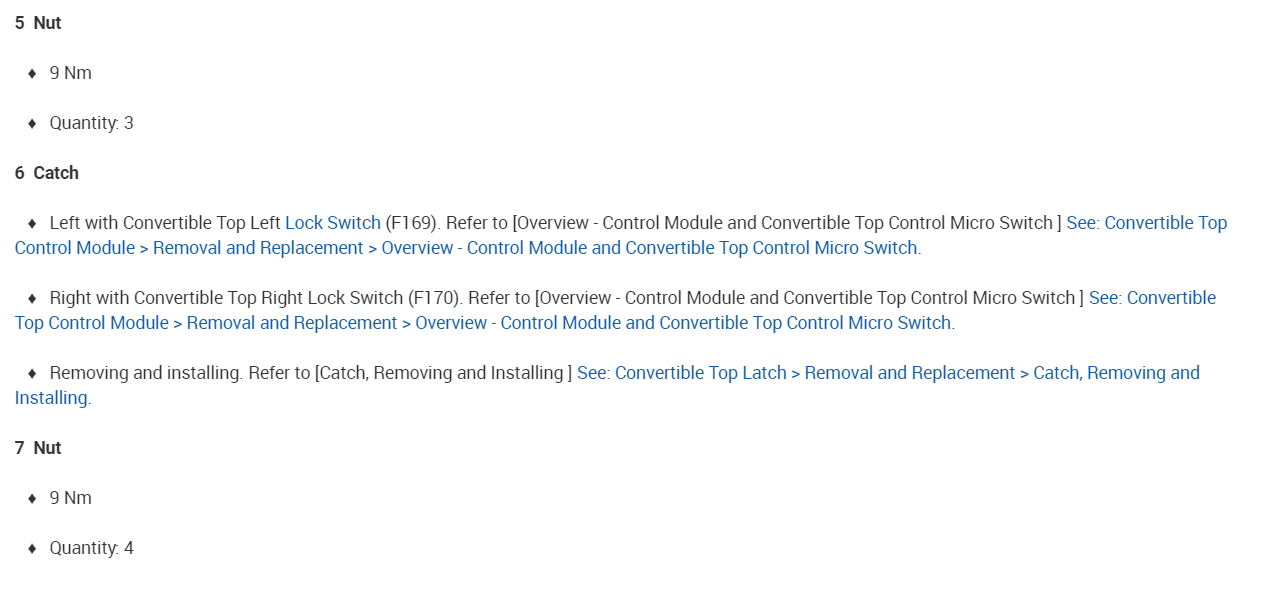

Did this start happening after you replaced it or before? It sounds like one of the top position switches is out. Here is a guide to help you test them and the top wiring diagrams so you can see how it works:
Dec 17, 2018 at 2:45 AM
TIM15212
This happened before replacing top lock motor and assembly. Dealer diagnosed it wrong. Where do I find top position switches and can I replace them?
Dec 17, 2018 at 2:06 PM
  • 55,412 POSTS

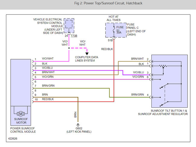

Sorry, I should have included those diagrams. Here they are now. Let me know what happens.
