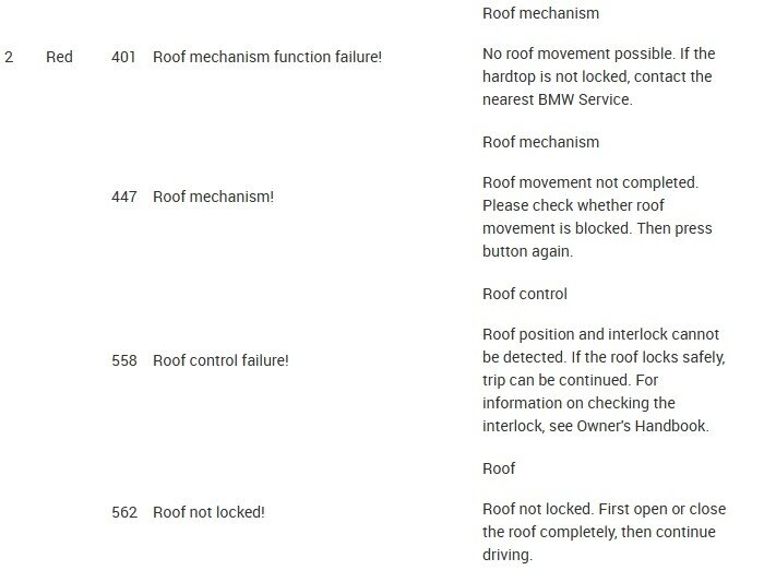

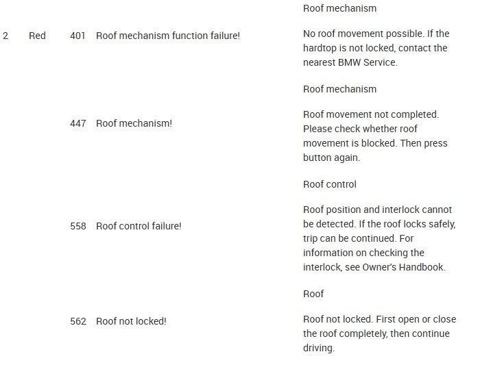

Button is pressed red light flashes.
Jun 7, 2024 at 6:22 PM
STEVE W.
  • 15,344 POSTS

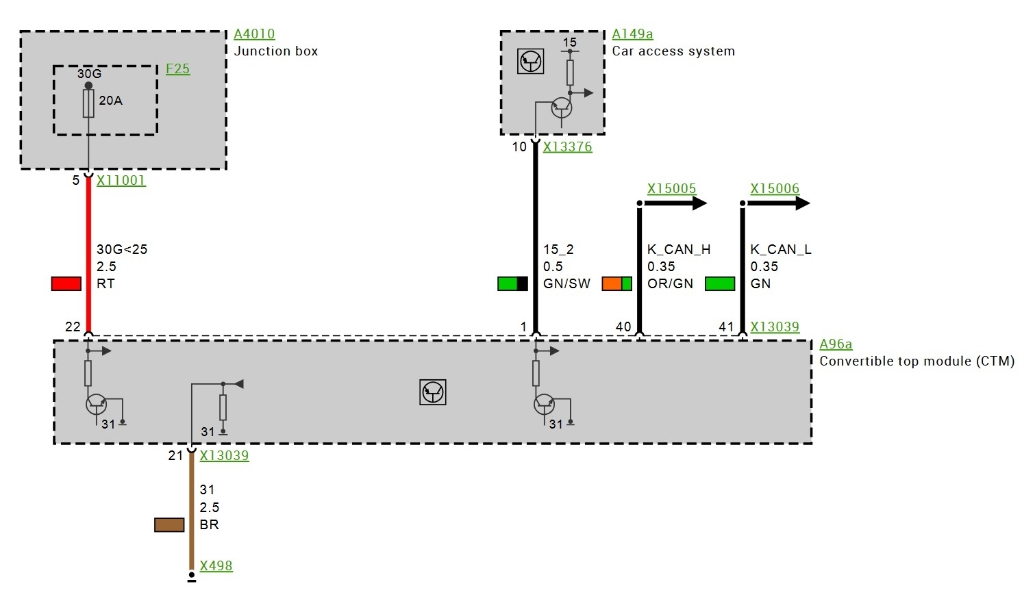

When the button flashes look at the driver info center on the dash. It should show a message and a code. From there you need a dealer level scan tool that can access the body and roof control modules to access the fault data it has. There are multiple switches and sensors that could be at fault stopping it. The only other item is fuse 25 in the junction box under the glove box. It powers the top module. Beyond that you need the info from the control modules to see what they say. You will also need the scan tool to do any repairs as the top has to be placed in different positions for sensor testing which the tool guides you though.

The code says soft-top module CTM I don't know what that means and how to fix it.
Jun 7, 2024 at 11:27 PM
STEVE W.
  • 15,344 POSTS
That means it sees an error in the control module that runs the convertible top. With that error you will need a scan tool or access to one that can do the testing that the OEM units can. There are not many that can handle that because BMW likes to keep things close. However, I suspect that the module will need to be replaced and programmed to work in your car.

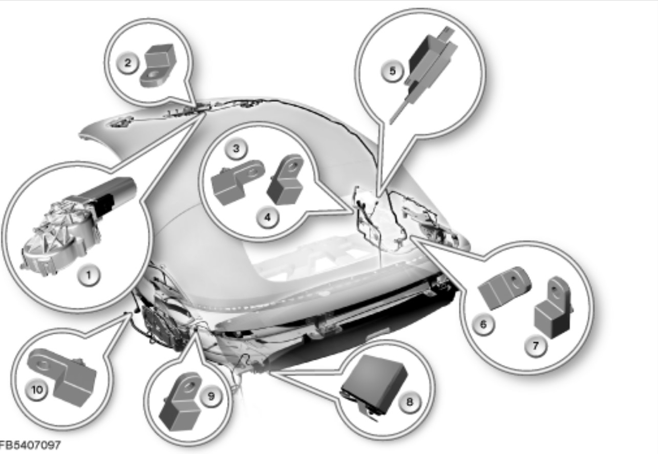

Good morning, my friend. I noticed the light on the dashboard shown that top is not fully closed and not fully open. It's just open a little bit and it won't close and it won't open completely it stuck.
Jun 8, 2024 at 7:49 PM
STEVE W.
  • 15,344 POSTS
That would be related to the other problems. With a scan tool it's possible to "talk" to the different modules and in most cases, you can look at the sensors as well. So, if you know that the top should show say 4 sensors as closed and 2 open when the top is fully locked but in scan data it shows 3 closed and 3 open you know to look at the sensor that is wrong.
