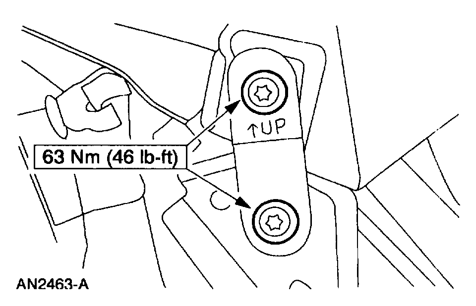

Someone was purchasing my 2001 Mustang Convertible from me. I told him the top shouldn't be put down until the hydraulic fluid is replaced. He did it anyway and in the process of forcing it down he bent the top frame. We got it back up but there are gaps and it is bent too far that there is a huge gap in between the door and the top. Is there a way to fix this or do I need to replace the whole thing? If I do need to replace it, where would I be able to purchase what I need?

You can attempt to bend it back but depending on how many spots it got bent in it can be an exercise in futility. My suggestion would be a replacement frame. There are some available on eBay (see link below) and at car-part.com you can search for them at local salvage yards.

It sounds like the side rails are bent. Not being there to actually has happened, I'm going to suggest two things. First, remove the rails (which is a nightmare), determine what is bent and try to straighten them. Or have the framing replaced, which won't be cheap. Honestly, I'm not sure where you are located, so I have no idea who can fix it for you.

Here are the directions for frame rail removal and replacement. They include adjustments and how it works. Basically, total removal procedure. The attached pictures correlate with these directions.
Convertible Top Assembly-Side Rail, Folding Top
Vehicle Body and Frame Roof and Associated Components Convertible Top Service and Repair Procedures Removal and Installation Convertible Top Assembly-Side Rail, Folding Top
CONVERTIBLE TOP ASSEMBLY-SIDE RAIL, FOLDING TOP

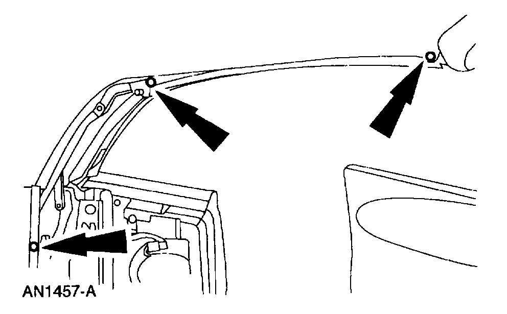

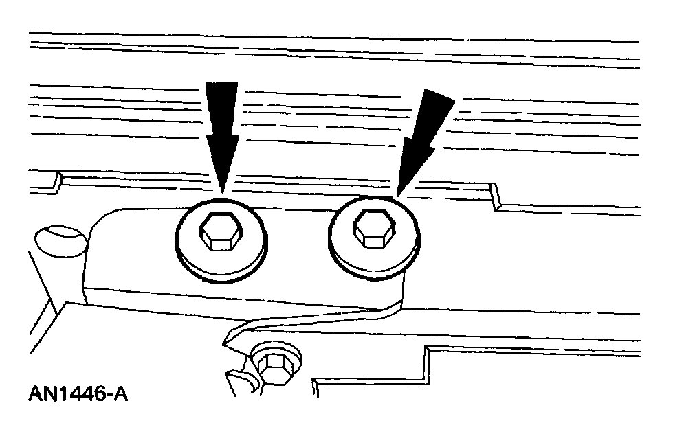

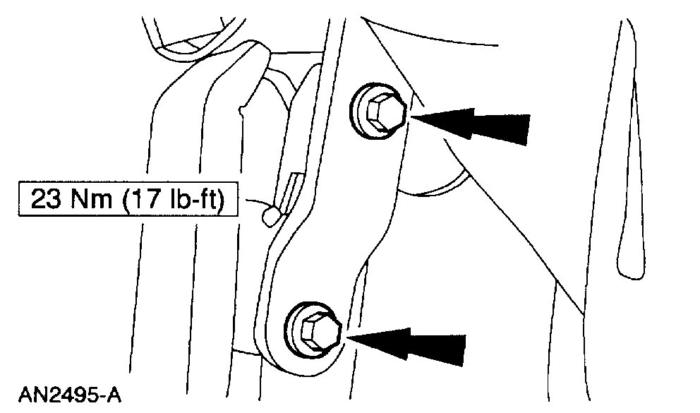

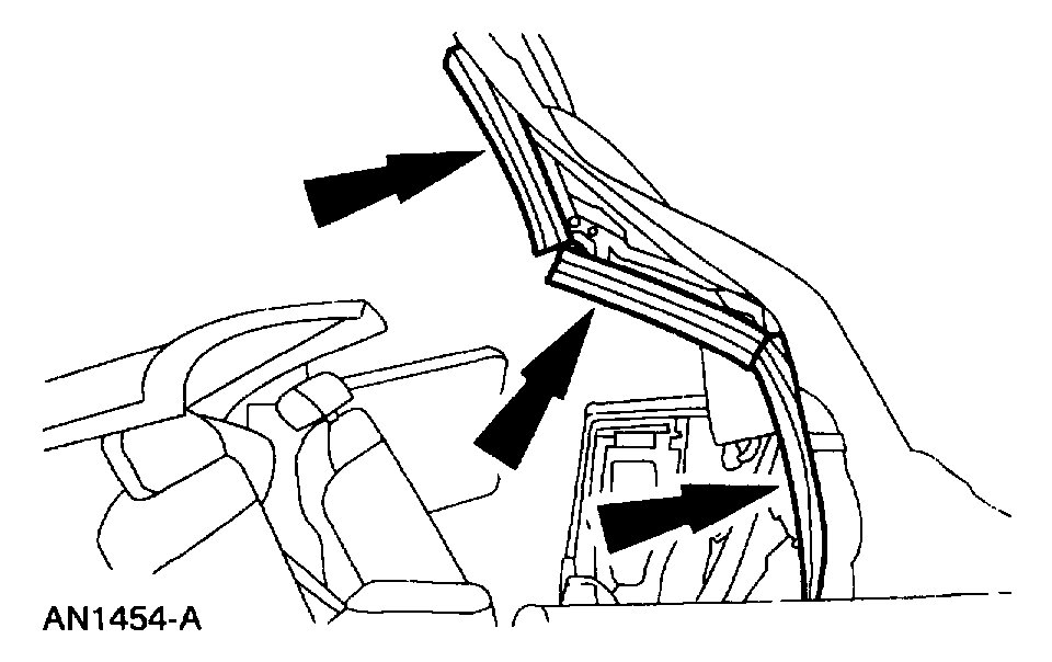

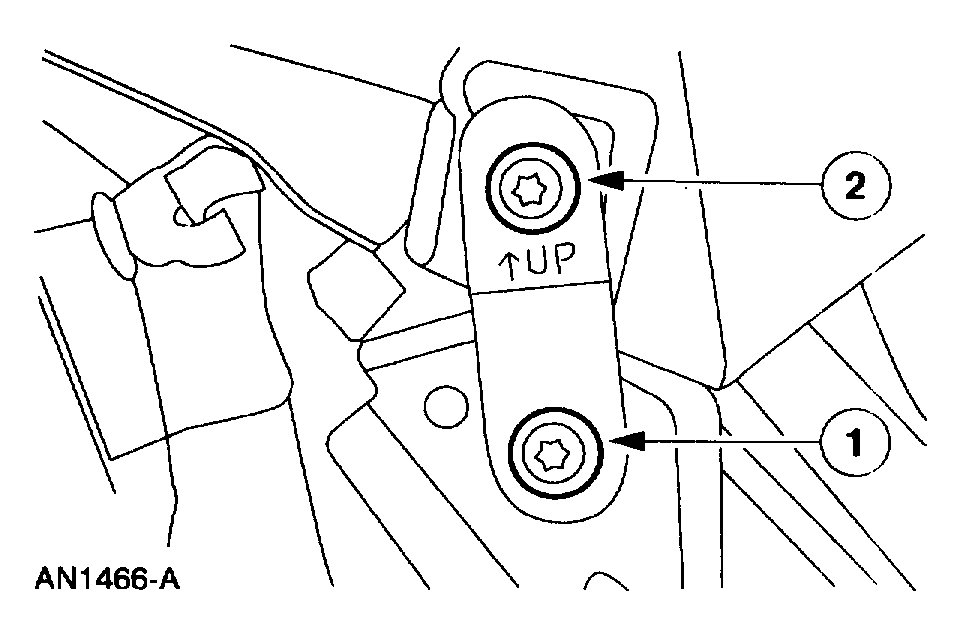

1. Remove the side quarter trim panel.
picture 1

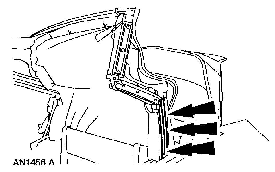

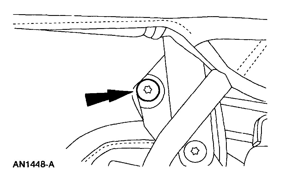

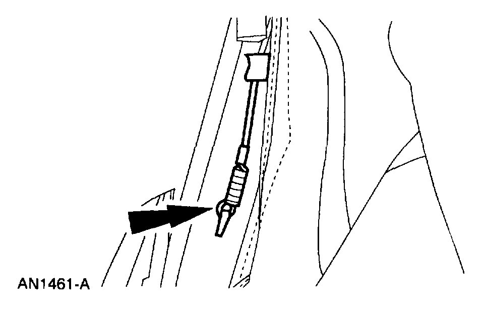

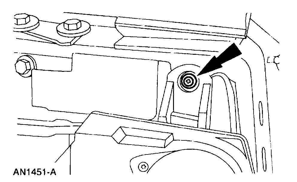

2. If necessary, remove the bolts.
picture 2

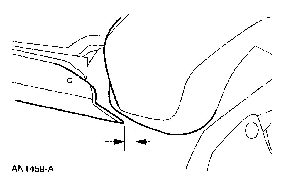

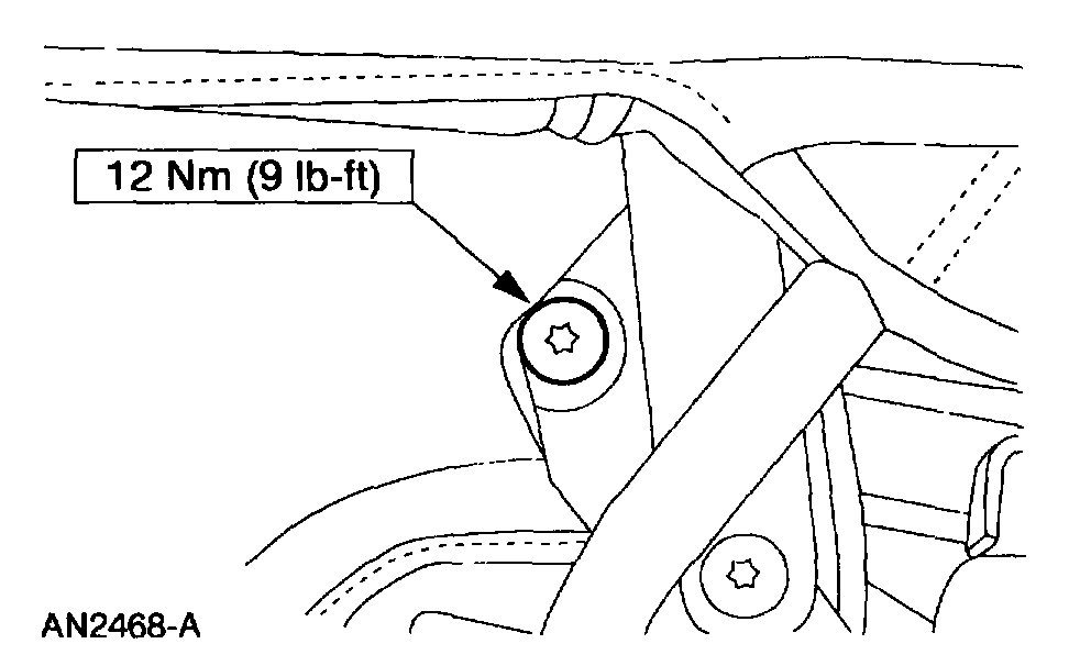

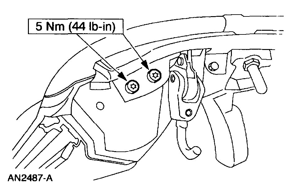

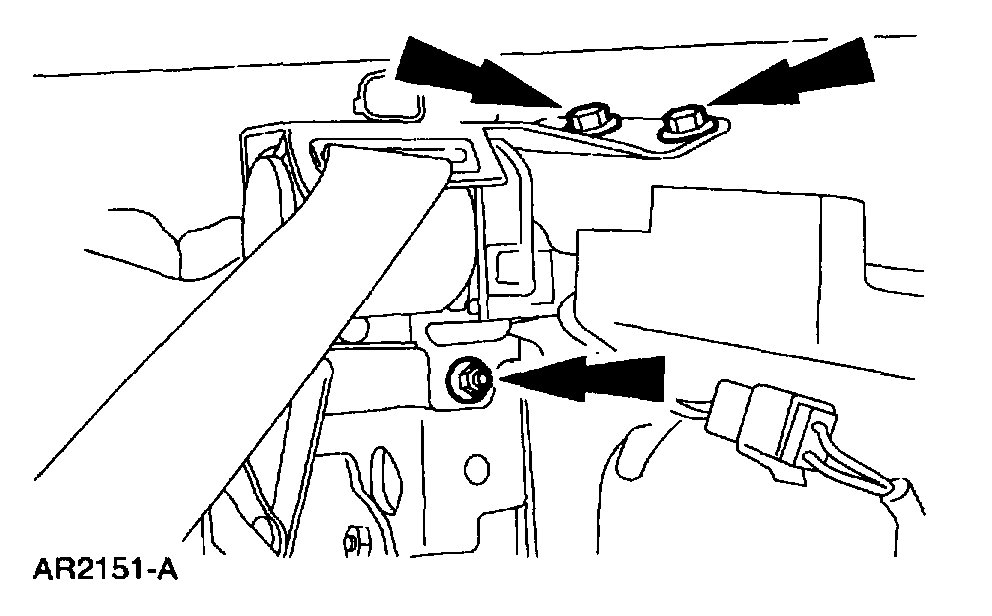

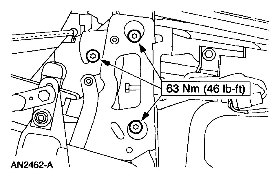

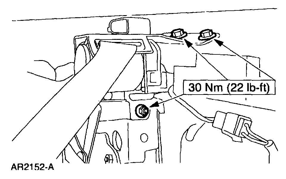

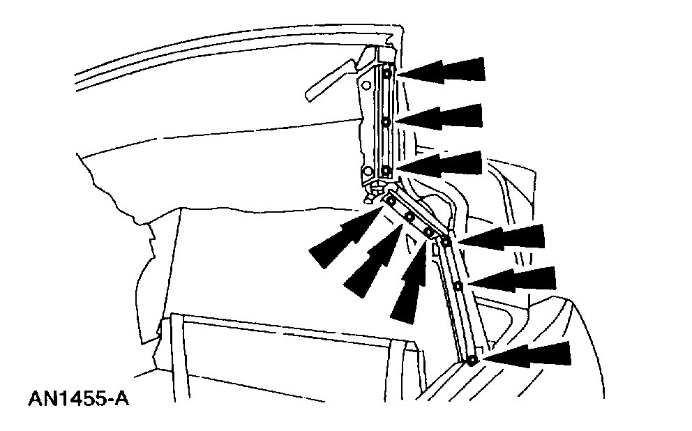

3. Remove the nut and bolts and position the front safety belt retractor aside.
picture 3

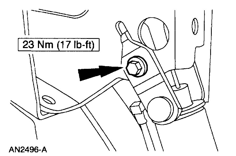

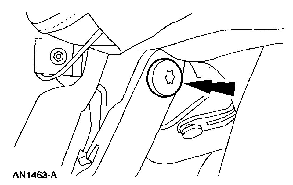

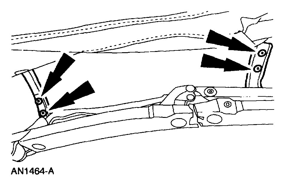

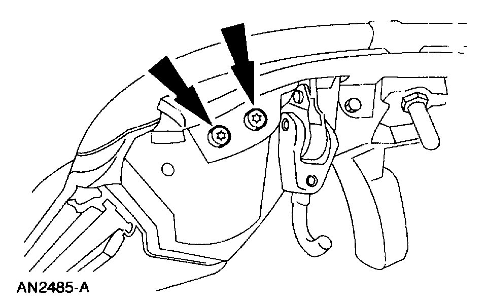

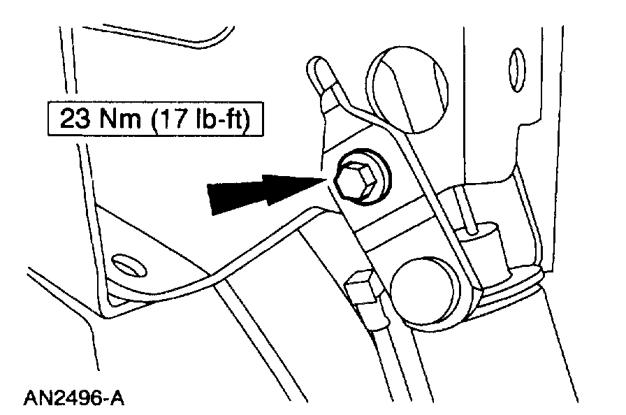

4. Remove the two cylinder rod mounting bolts.
picture 4

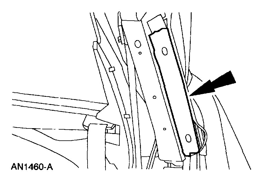

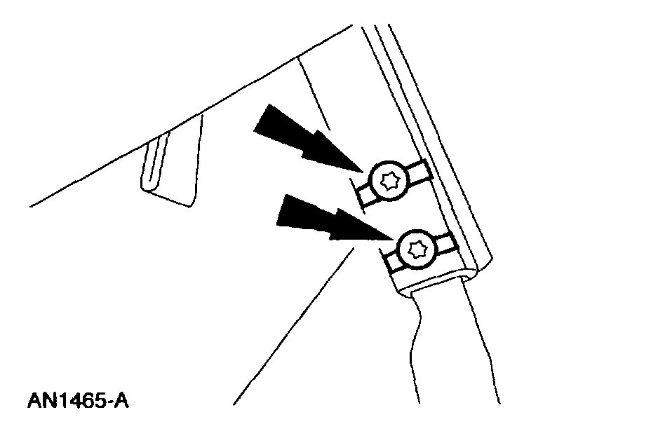

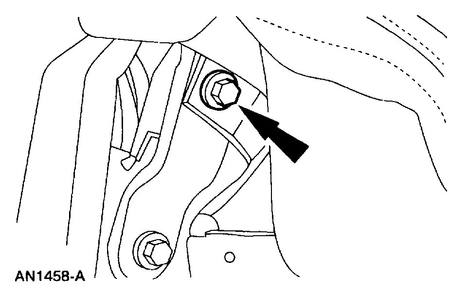

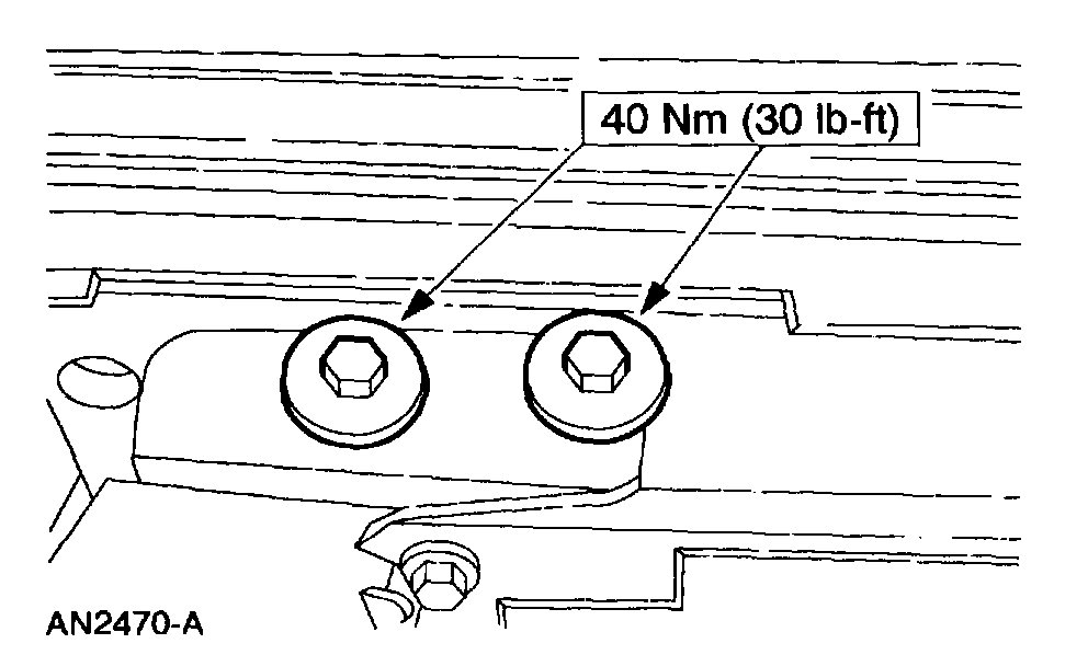

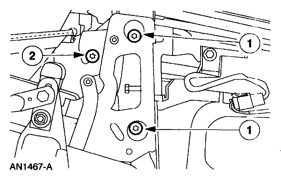

5. Remove the cylinder rod mounting nut.
picture 5

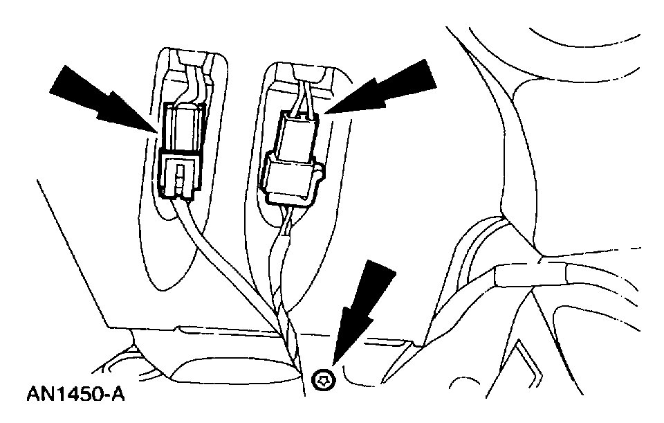

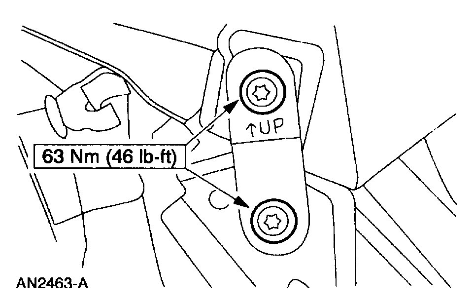

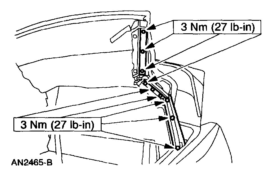

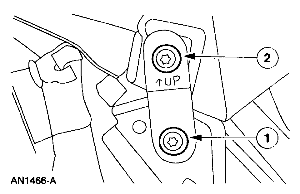

6. Remove the screw and disconnect the two electrical connectors.
picture 6

INSTALLATION
picture 22
1. Position the side rail and install the bolts.
picture 23
2. Connect the mounting bracket and install the bolts.

20. Position the cylinders and install the nuts.
picture 41
21. install the two cylinder rod mounting bolts.
picture 42
22. Install the front safety belt retractor.
picture 43
23. Install the bolts.
