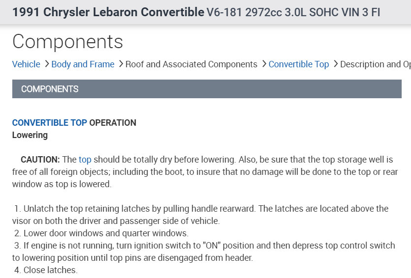

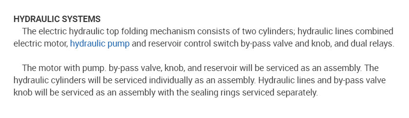

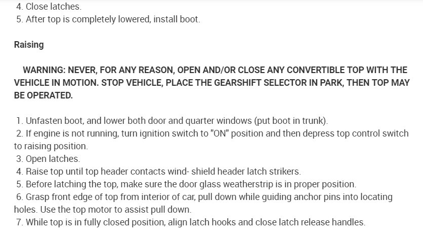

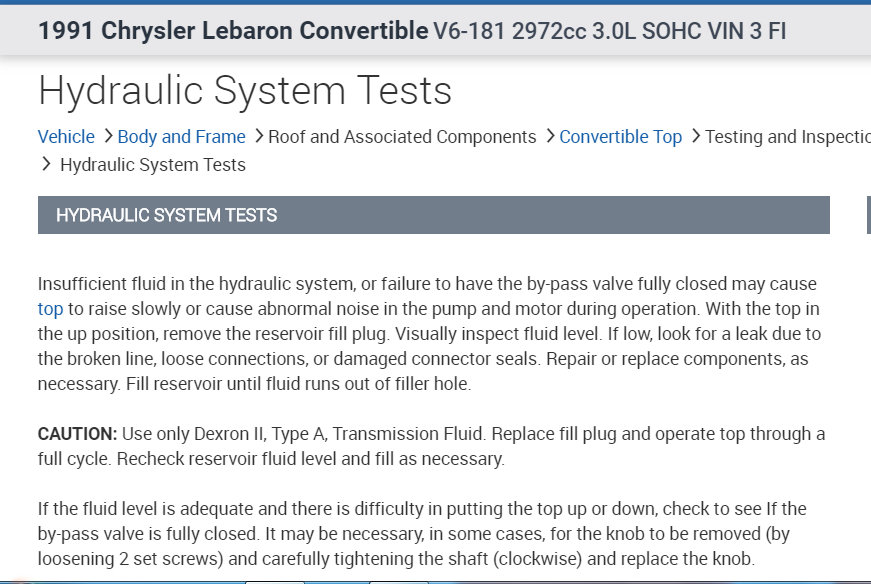

I am unable to locate where fuse is for convertible top. need to know location of fuse to check. if fuse is fine what is next step?
Apr 16, 2019 at 5:36 AM
SCGRANTURISMO
  • 4,897 POSTS
This could be a problem with the hydraulic system that raises and lowers the convertible top. Check to make sure that the fluid level is to specs and that there is not a leak in the hoses somewhere. I have included in the diagrams down below a description of how the convertible top works and troubleshooting guide. Please go through this information and get back to us with what you are able to find out.
