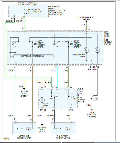

I have a question, so I have this 2000 s10 manual basic model. I have the power windows and power locks with switches and a harness, but the harness is not the right one and I want to see if there’s any diagram or videos on how to make my electric power windows and locks work with the switches.

I attached the wiring schematic for the windows, locks, and power supply below. I noticed there is a separate power supply, which is a 30-amp circuit breaker. It should be located under the dash. I suspect that is something you will need to purchase and install.
Please review the schematic and let me know if it helps. Here is a link you may find helpful when doing this:
See pic below.
