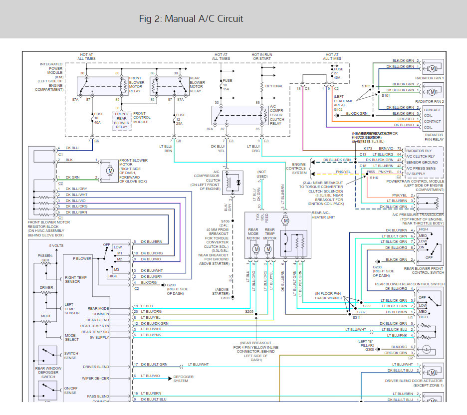

Not working control panel and not working turn lights, alarm lights. Speedometer is okay, fuse, okay, turn relay okay (works on 3.3 Grand Voyager) . Needed wiring diagram, to find wires by color and voltage on connector pins.
Jul 26, 2019 at 6:22 AM
  • 55,732 POSTS

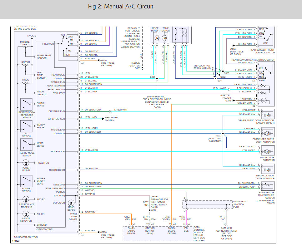

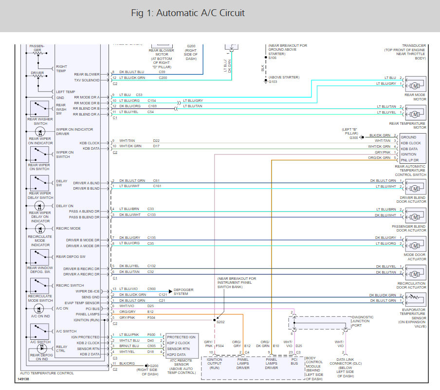

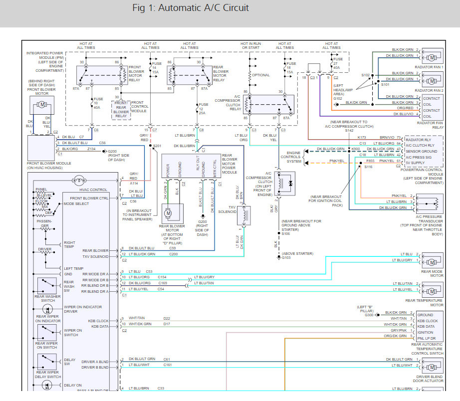

If the fuses and grounds are good it sounds like the climate control panel might be out . To be sure here is a guide to help you check power and grounds with the control panel wiring diagrams below:
