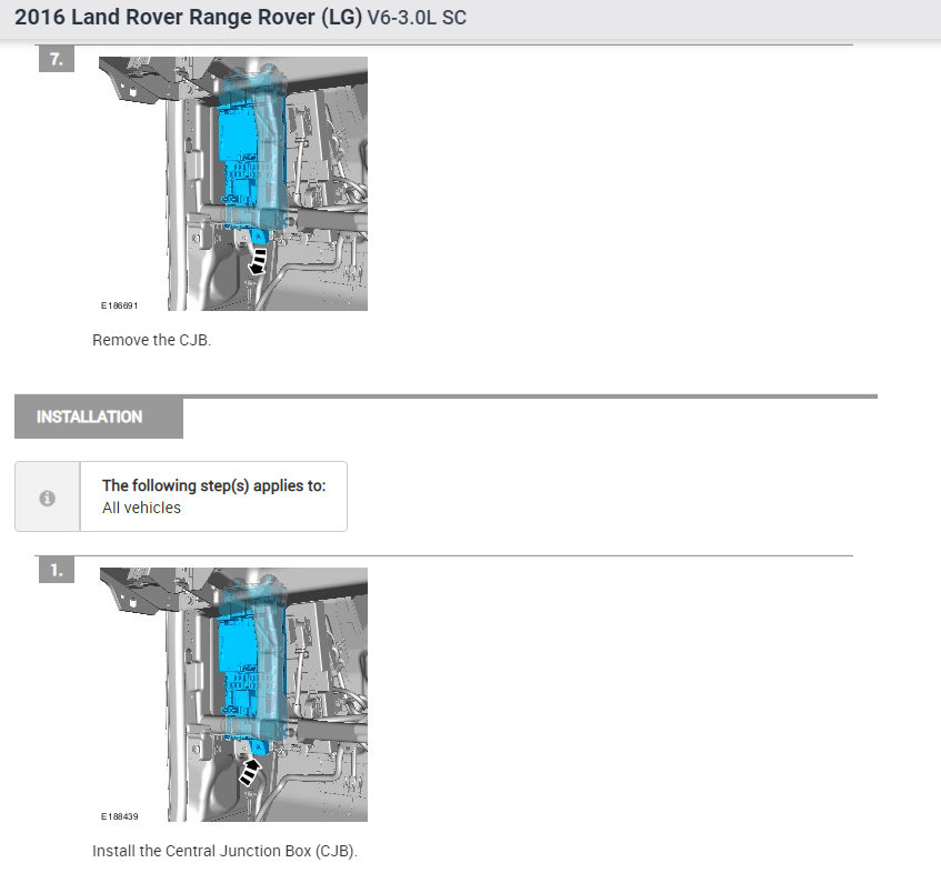

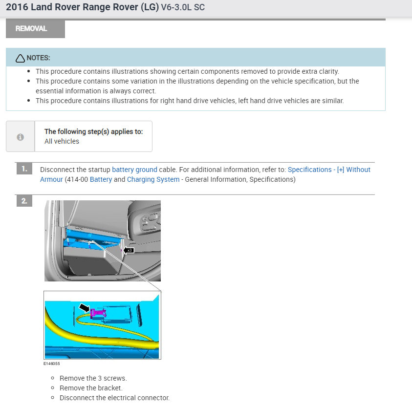

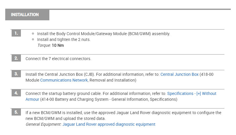

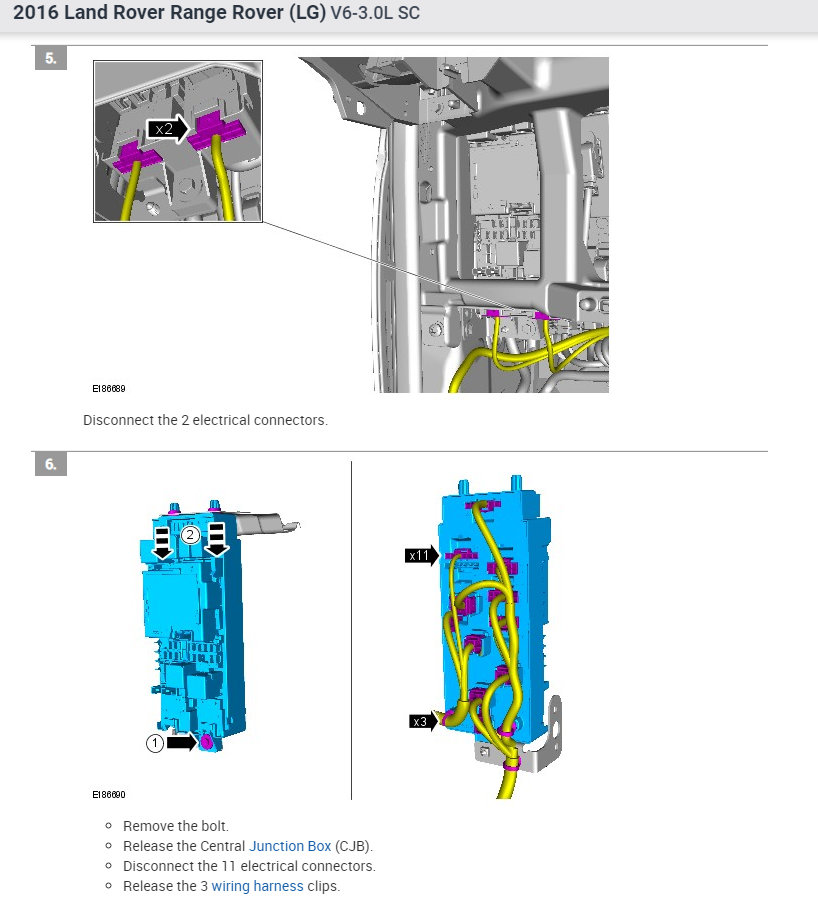

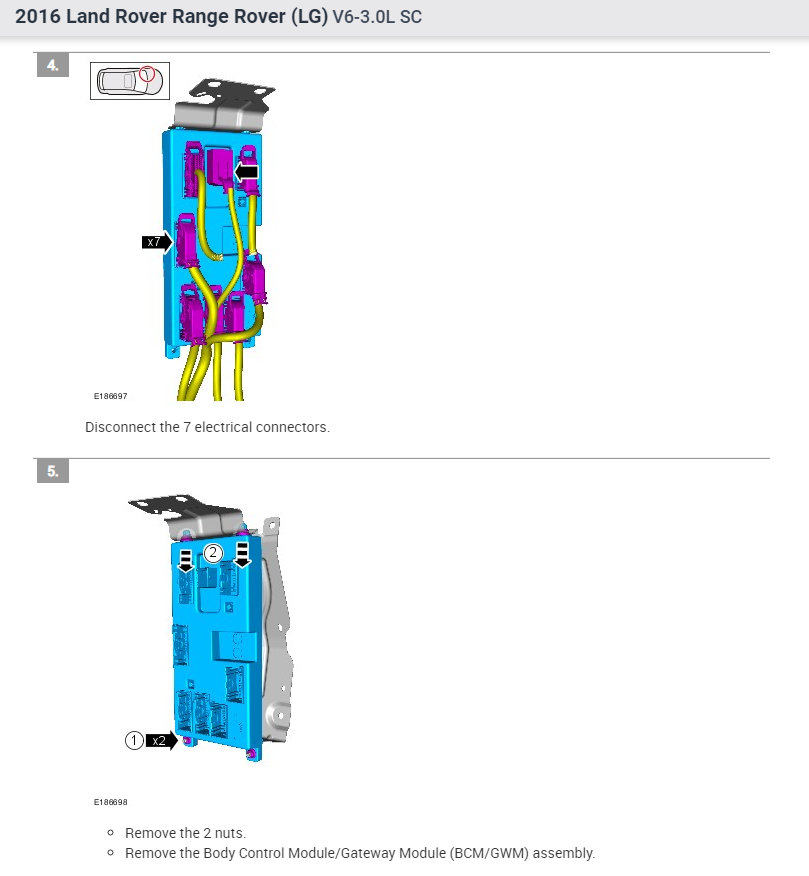

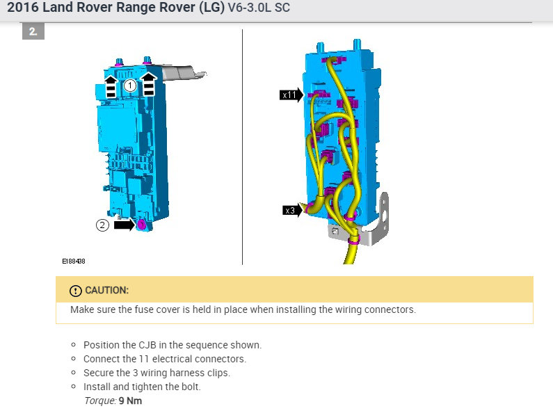

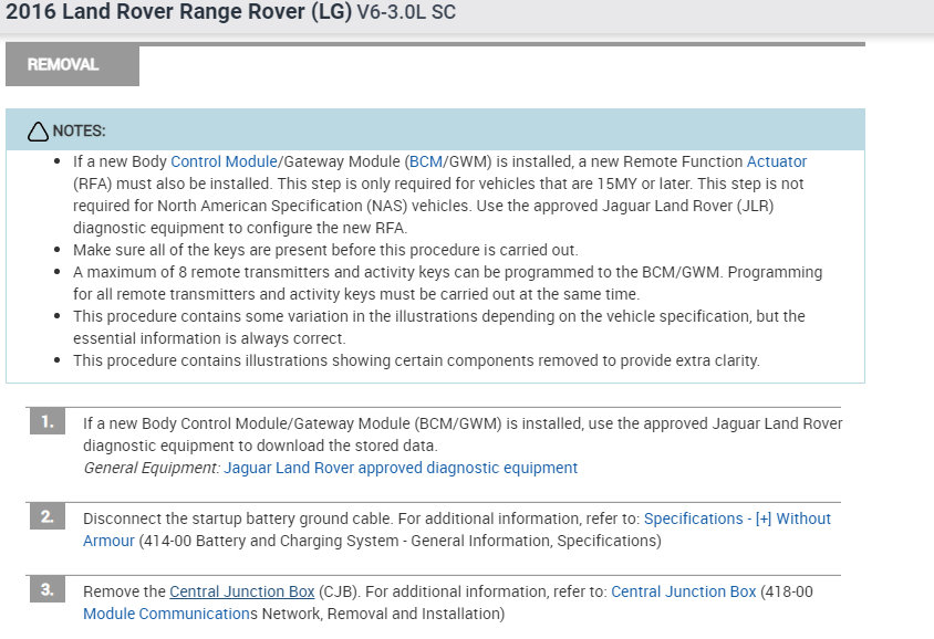

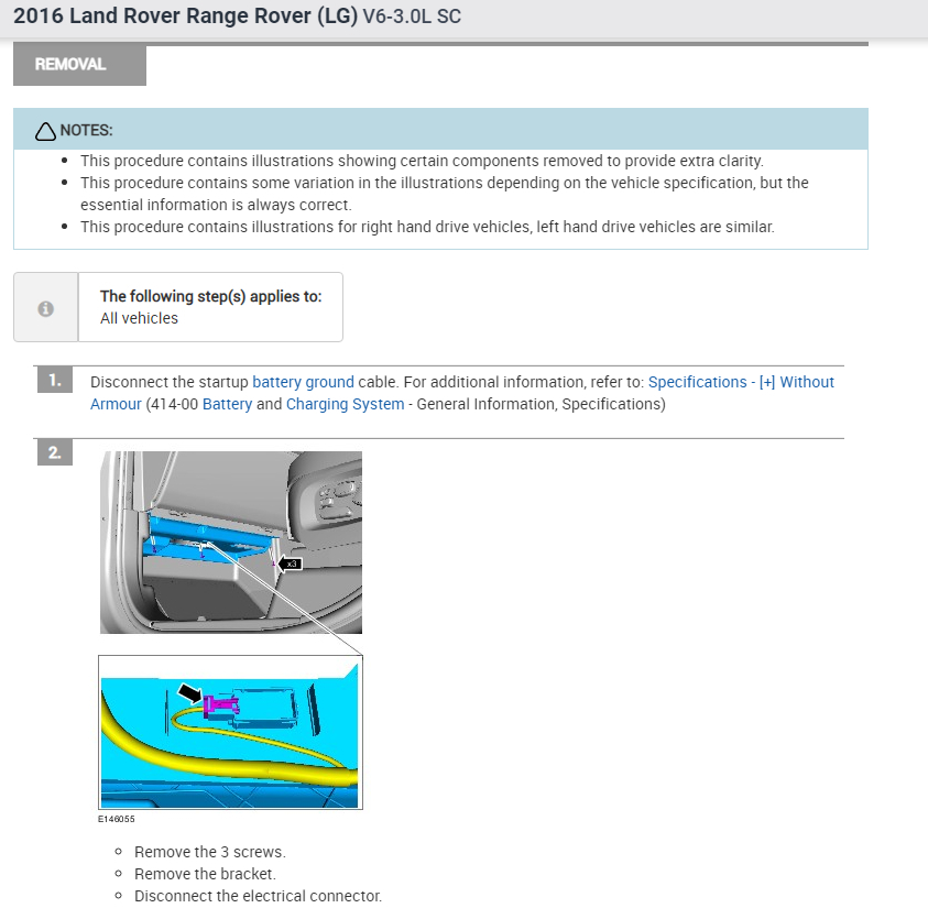

need to know where the BCM (control module) is located.
Jun 30, 2022 at 11:00 PM
SQM
Experienced Mechanic
6,383 POSTS
The BCM is located under the dash.
You will have to remove the central junction box to access it.
I have attached diagrams below for your reference.
Let me know of any questions.

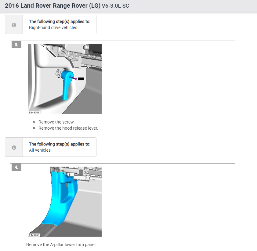

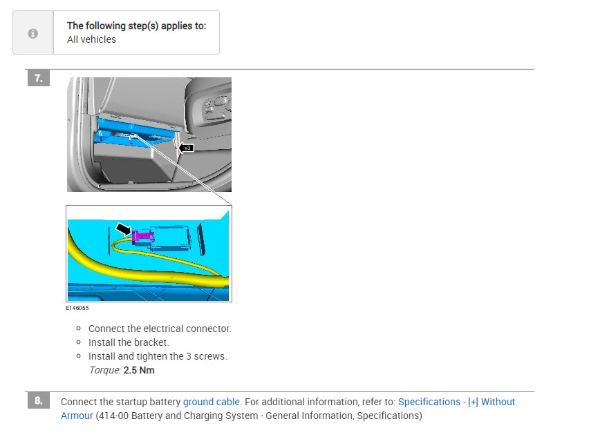

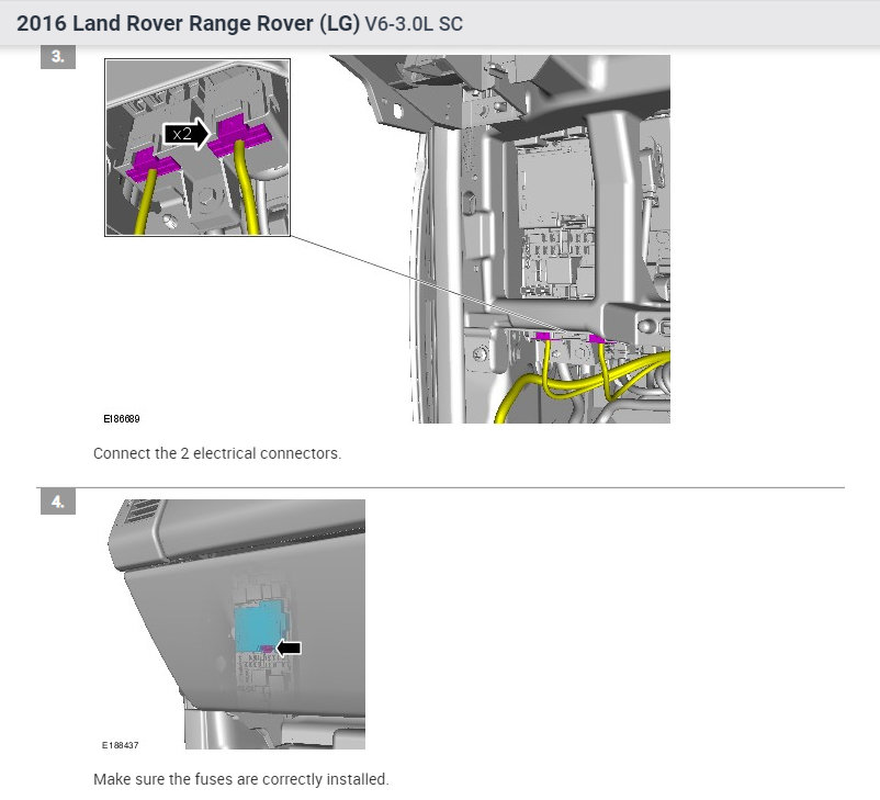

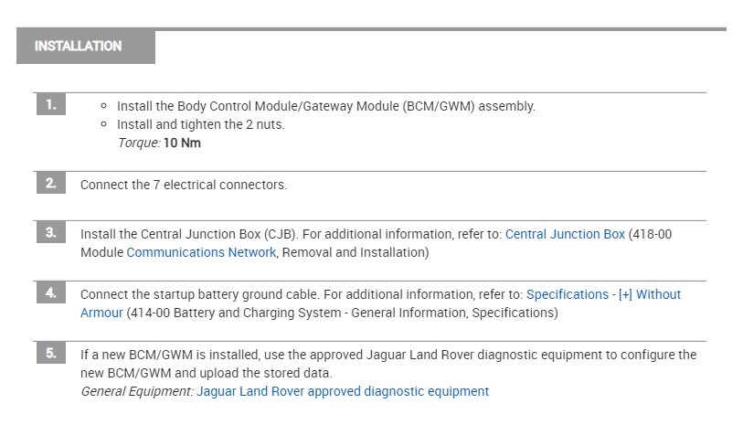

Its not correct. The BCM is located in the Drivers side kick panel on a right hand drive car
