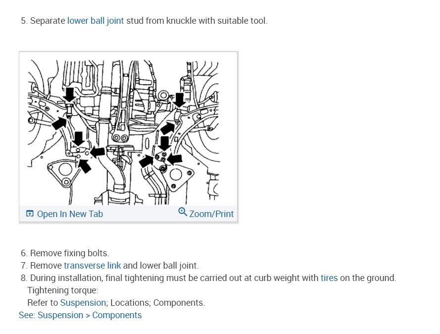

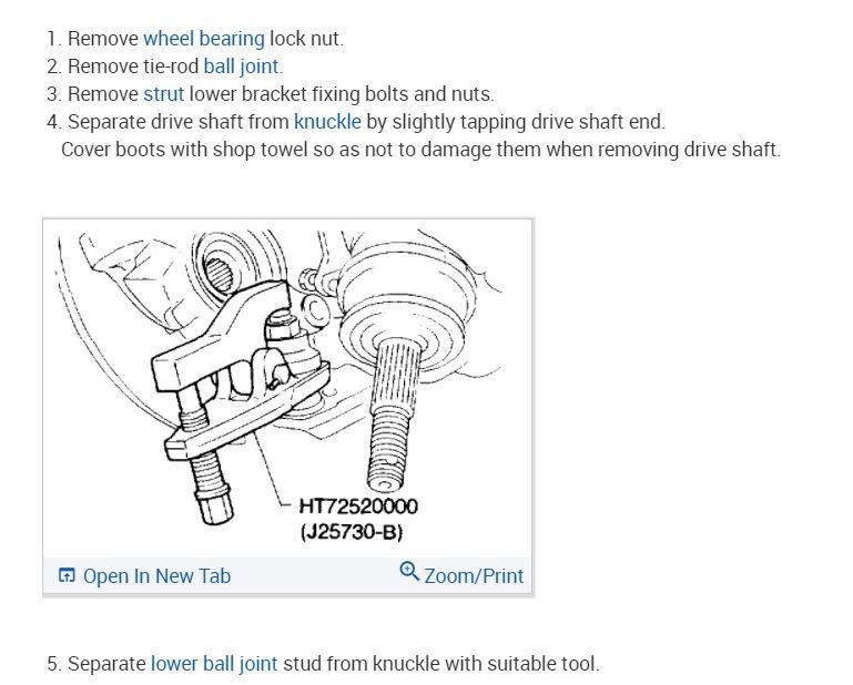

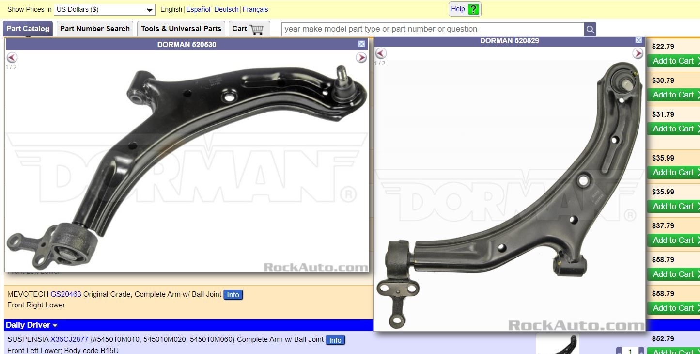

My car was built 09/2000. I changed the lower control arms back in September. They are now creaking, and the passenger side ball joint boot has ripped. Creaking is getting worse. I know it's the arms. However, I learned that there are two versions of this car, built before and after 03/2001. Mine is before. I can't seem to find any control arms for my version. What is the difference between the two models and why don't my arms "fit"? Any help would be appreciated. I need to change these arms ASAP. I no longer have the old ones. I was hoping I could just change the ball joints. That could save a lot of money. Thanks in advance.
Jan 5, 2022 at 6:28 PM
Good morning,
I attached the parts for you to view. $65.00 for both arms.
There is nothing asking for a build date.
https://www.2carpros.com/articles/lower-control-arm-bushing-replacement
