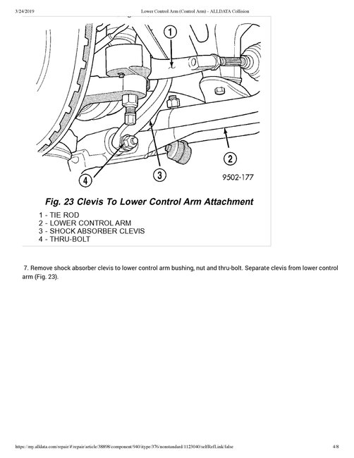

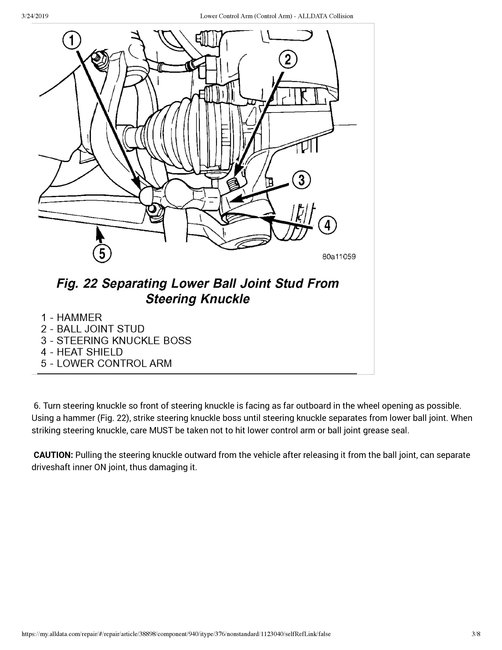

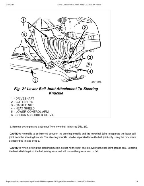

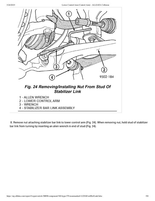

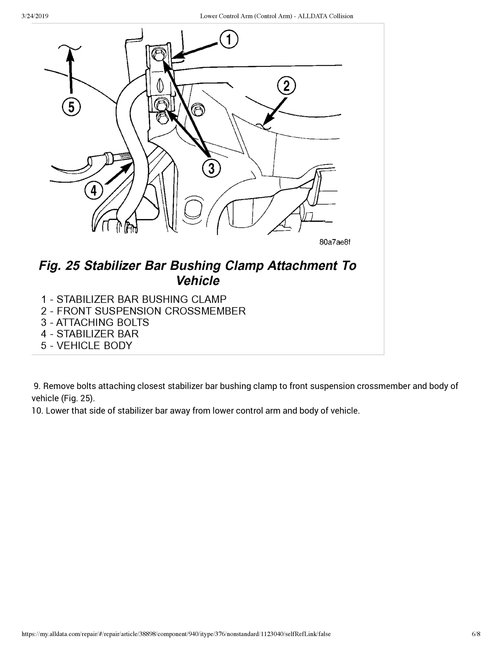

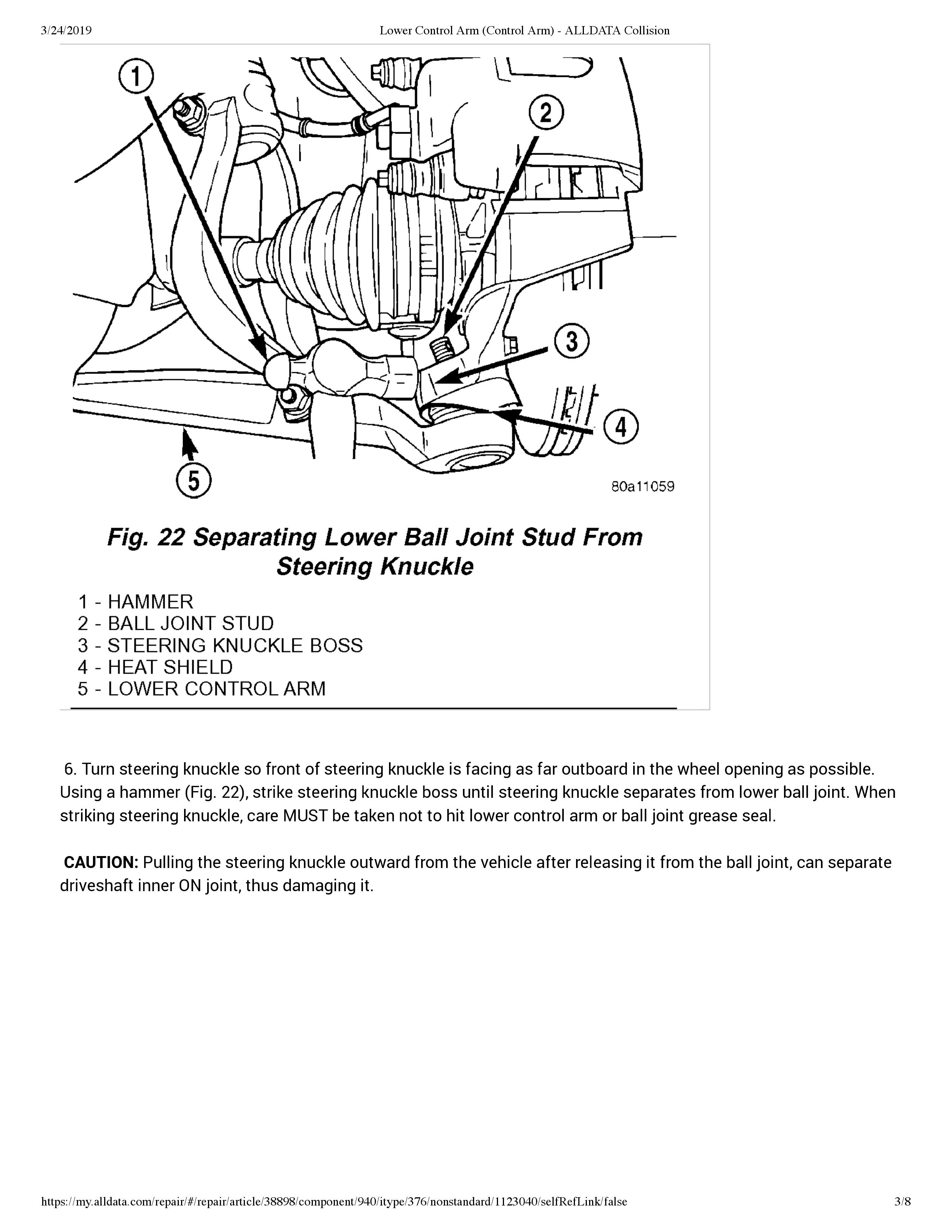

You should be able to move the ball joint stud to an angle where it will fit into the steering knuckle. If the ball joint is stiff and the stud won't angle you can use the closed end of a wrench over the stud to lever it into place.
If it's a case of not being able to move the knuckle enough to get the stud in you may need to loosen off another component to get the clearance.

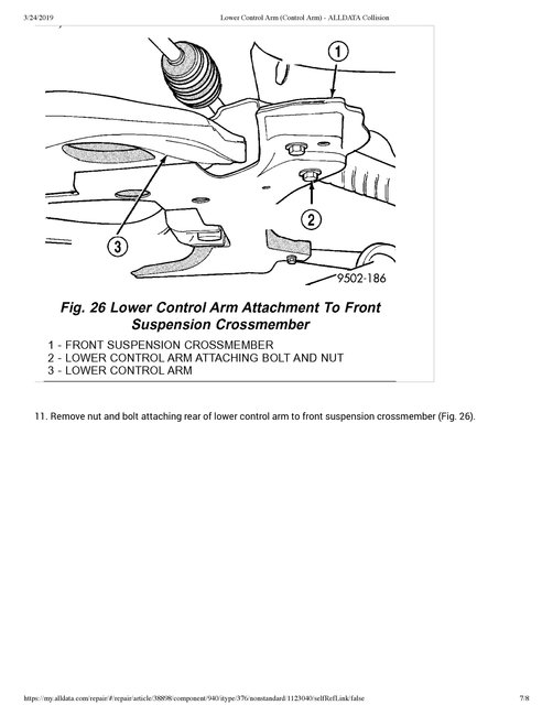

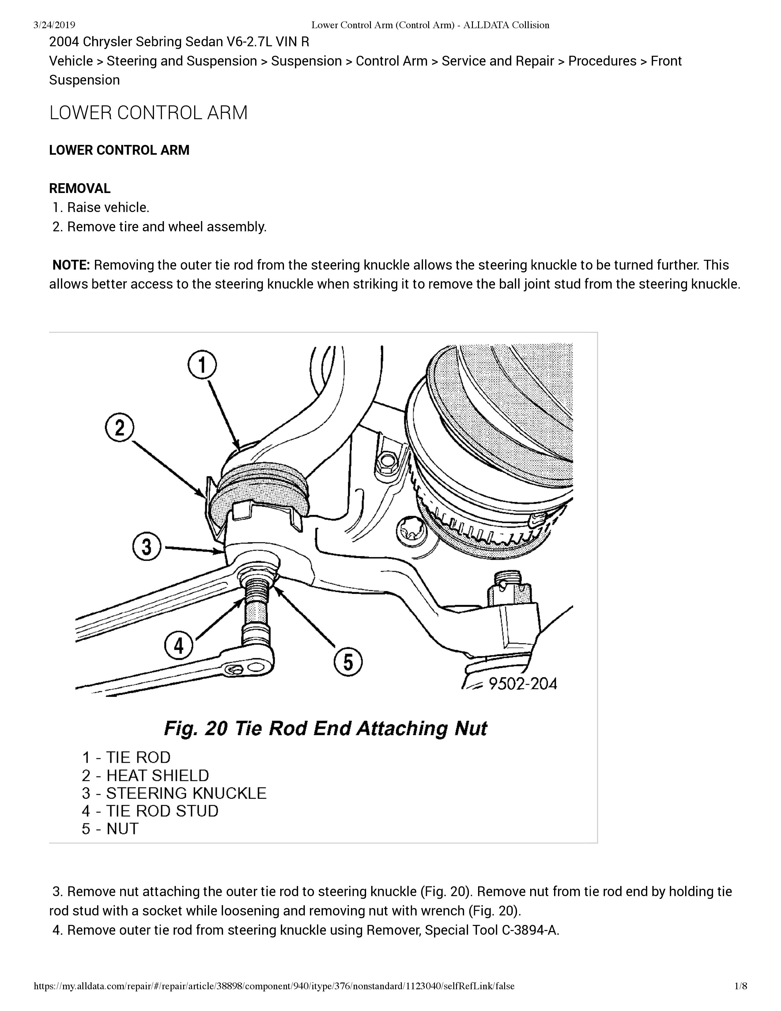

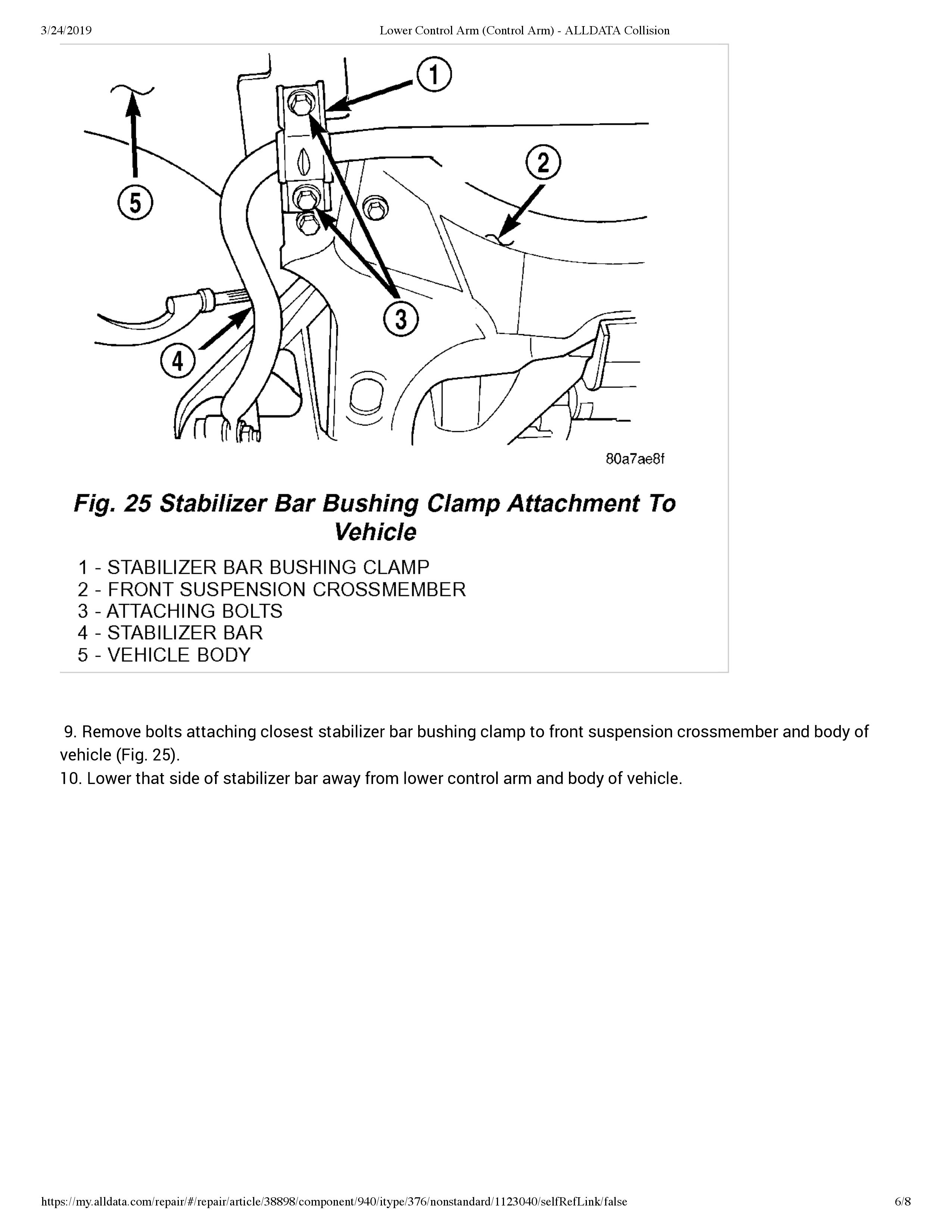

I have attached to this message the instructions for removing the lower control arm, installing should always be the reverse of removal. This might give you an idea of what needs to be done to get the knuckle to move.
Let me know if that works for you.
If not and you have further questions please don't hesitate to ask.
Regards, Joe

1) Removed tie rod from steering knuckle.

3) Detached stabilizer bar and removed thru bolt for clevis.

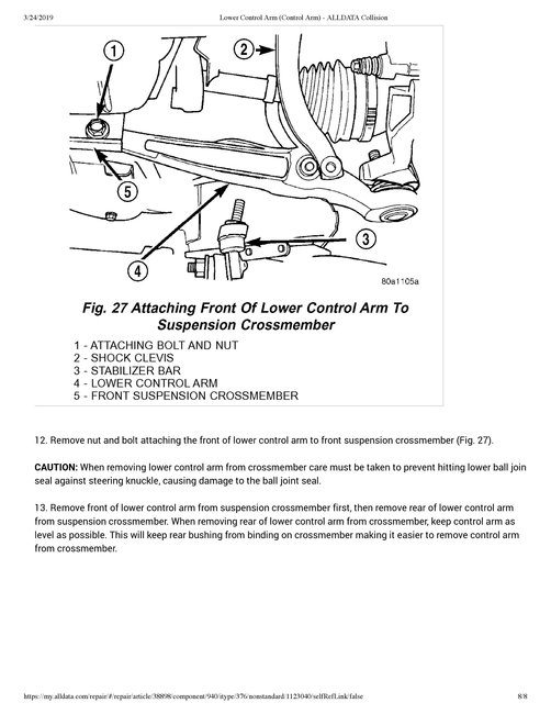

So to perform this repair you will need to jack up the front of the vehicle and support the body/front sub-frame both sides with jack stands. This will allow the front suspension to hang both sides.
If you only have one side lifted or are supporting the other side on the lower control arm you will have problems re-attaching the sway bar.
Loosen off the that rear mount nut and bolt first. Then fit the control arm into the front mount on the sub-frame. Start the bolt for the front mount but do not tighten. Then lift the lower arm, line up the ball joint stud and start the nut. You should then be able to line up the bolt hole with the clevis and attach the shock. Also reattach the sway bar.
Tighten everything down once you have everything started.
You should not need to lower the vehicle. You could potentially have to jack up the lower arm to get the sway bar or clevis to line up. You should be able to manipulate the ball joint stud and the knuckle enough to get them to line up. You may have to clean the hole on the knuckle and potentially give the lower arm a tap to get the stud in all the way but this should not be difficult.
You could always remove the new lower arm and make sure the stud fits into the knuckle so you are not fighting a loosing battle.
