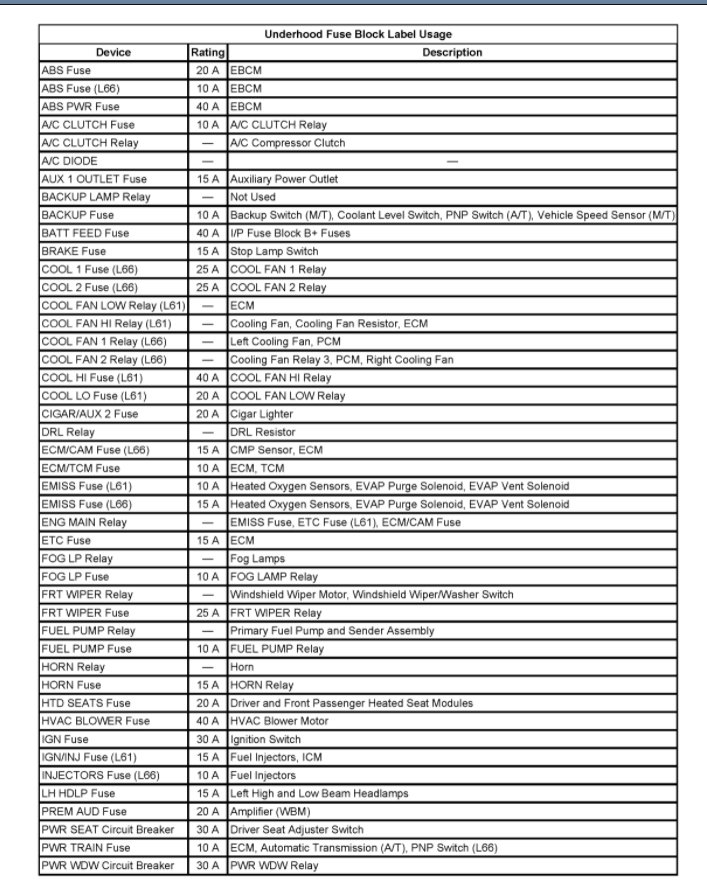

How much time will it take for me the check the fuses where are they and where do they go?
Oct 8, 2017 at 1:07 AM

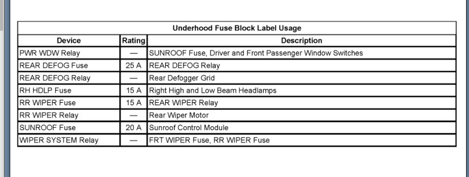

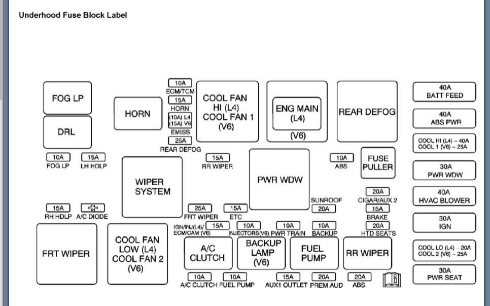

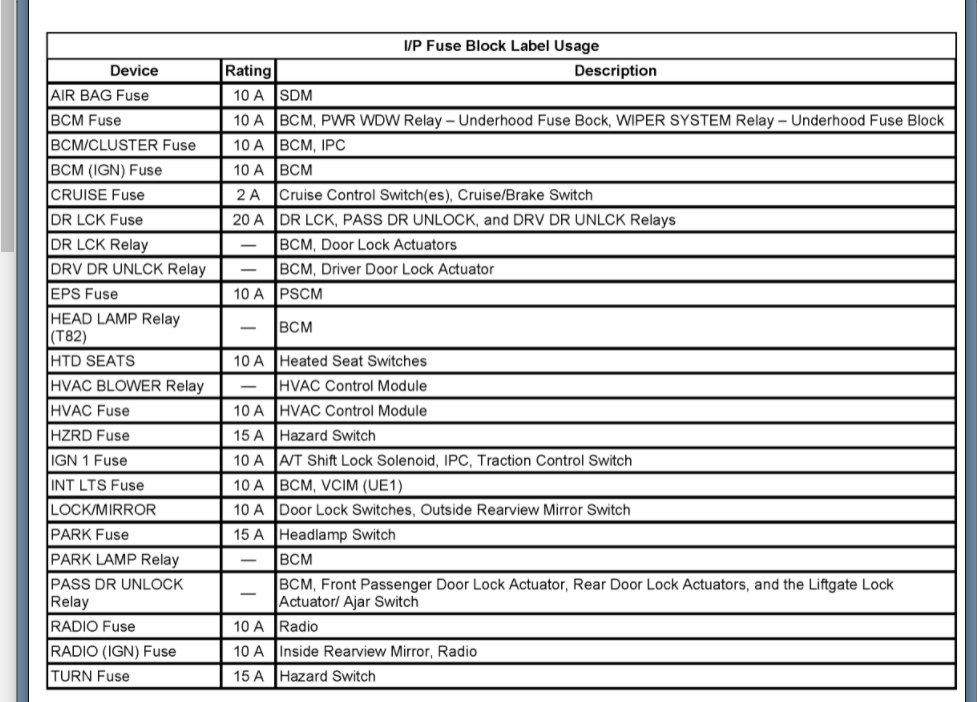

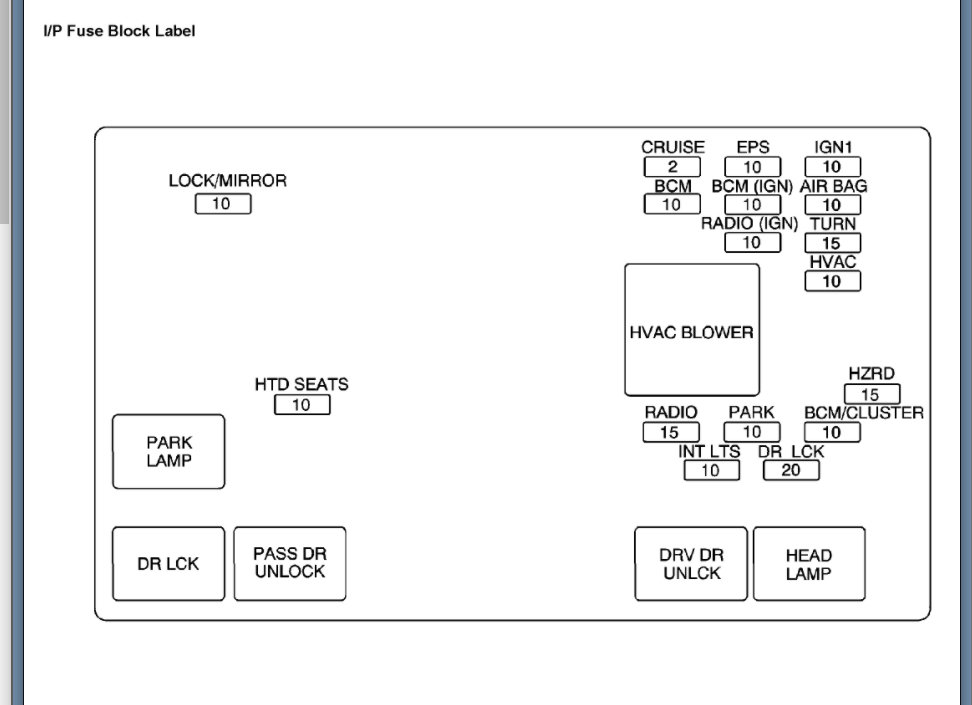

Here is a guide that will help with testing and replacing the fuse:
Below you will find the info about the fuses from the manual. Please run through this material and let us know if you have other questions. Thanks
