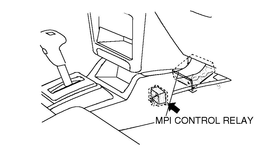

Stalling out after driving for a few minutes. Then wont restart, until allowed to rest for a while. Have already changed fuel pump, plugs, wires, brain, rotor, battery, fuel filter. Was told that it could be the fuel pump relay but cannot find the current relay on the car to replace it.

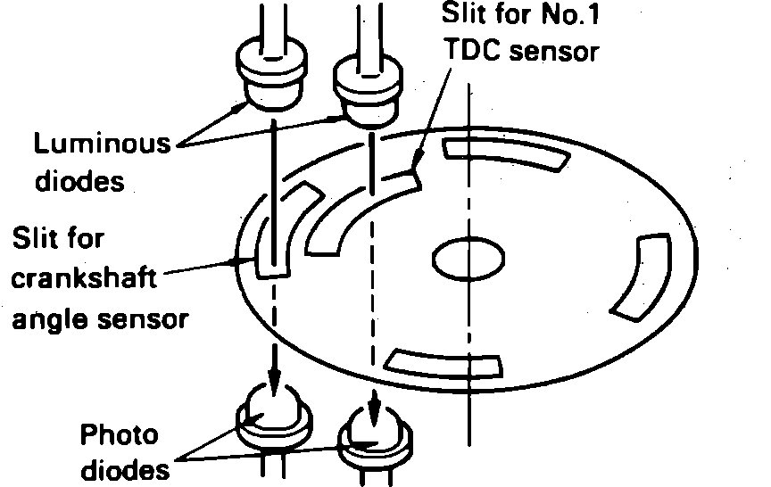

The Crank Angle Sensor and the Top Dead Center Sensor are located within the unit housing. These sensors are incorporated into one unit, and consists of a disc and a pick-up unit. The disc is affixed to the main shaft and the light-transmitting unit is mounted stationary in the housing.
Crank Angle And #1 TDC Sensor
Picture 2
The disc contains 4 large slits around its circumference to indicate the crankshaft angle. An additional light-transmission slit located inward from the edge is used to indicate number one cylinder's top dead center position. The pick-up unit assembly uses two luminous diodes and two photo diodes, in order to detect the two different slits. There is a very slight clearance between the luminous diodes and the photo diodes, and the disc rotates within this space.
As the main shaft rotates the slits at the discs edge pass between the light and the optical reading part of the unit. The light emitted from the luminous diodes passes through the slits to the photo sensing diodes. When the photo diodes receive the light, they become conductive and generate a signal, which is sent to the Control Unit.

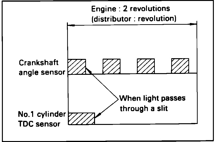

Photoelectric Signal Pattern
Picture 3
No.1 Cylinder TDC Signal:
Top dead center is detected by the signal obtained through the one inner slit of the disc. The MPI controller, based upon this signal, determines which of the four pulses from crank angle sensor is the signal for the #1 cylinder.
Crankshaft Angle Signal:
The four slits located at the outer circumference of the disc serve to detect the position of the crankshaft (and, therefore, the piston) relative to top dead center. The MPI controller, based on this signal, determines the fuel injection timing, and also calculates the amount of intake-air, the timing of the ignition signal, etc. for each revolution of the engine.

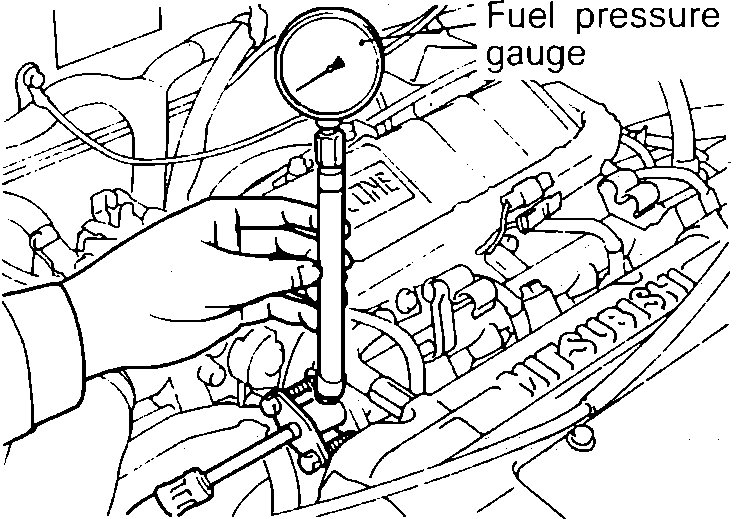

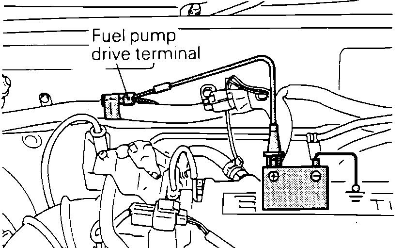

Here are directions specific to your vehicle for testing fuel pressure. Specifications are included in the directions. Starting with picture 4, the remaining pics correlate with these directions.
OPERATIONAL CHECK (QUICK CHECK):
1. Turn the ignition switch OFF

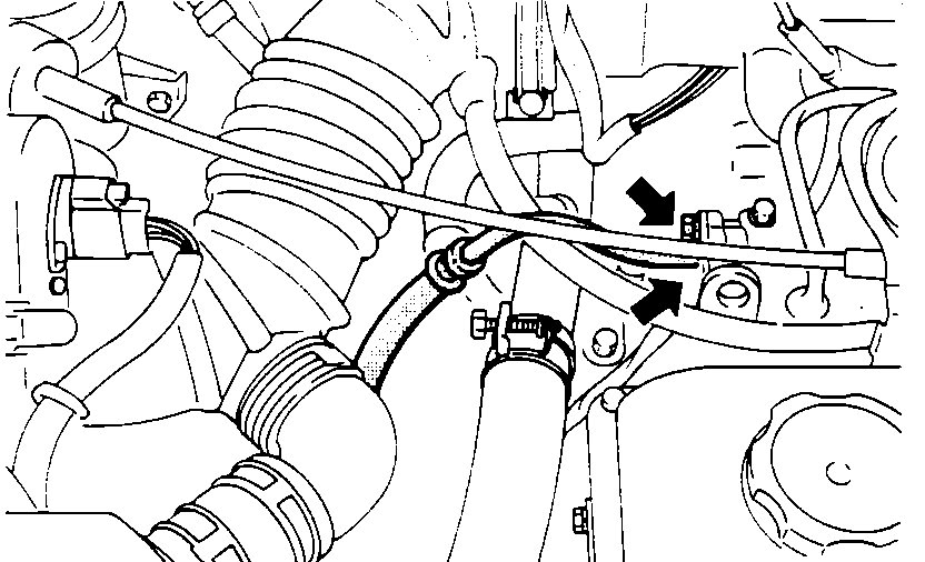

Fuel Pump Power Hook-up
Picture 4
2. Apply battery voltage to the fuel pump drive connector to power the fuel pump.
Fuel Pump Operational Test
Picture 5
3. Pinch the fuel hose to check that fuel pressure is felt.
NOTE: The fuel pump is mounted in the fuel tank and it operates submerged in fuel, therefore its operating sound is hard to hear without removing the fuel filler cap.

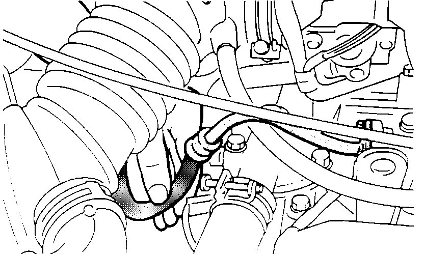

PRESSURE TEST (DIAGNOSTIC CHECK):
1. Reduce the internal pressure of the pipes and hoses by the following procedures.
a. Disconnect the fuel pump harness at the rear of the fuel tank.
b. Start and run the engine until it stalls. Turn OFF the ignition key.
c. Disconnect the battery negative terminal.
d. Connect the fuel pump harness connector.
High Pressure Fuel Hose Connection
Picture 6
2. Disconnect the high pressure fuel hose at the delivery end.
CAUTION: Cover the hose connector with a shop towel to prevent splashing of fuel caused by residual pressure in the fuel line.

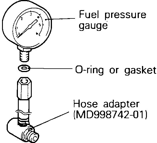

Fuel Pressure Testing Equipment And Adapter
Picture 7

3. Using the fuel pressure gauge adapter (MD998742-01) or equivalent, install the fuel-pressure gauge to the delivery pipe (fuel rail).

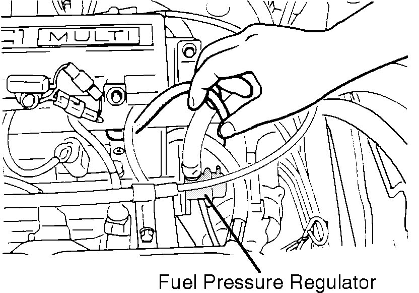

Fuel Pressure Regulator W/Vacuum Line Disconnected
Picture 9
6. Disconnect the vacuum hose from the pressure regulator, and plug the hose end. Measure the fuel pressure at idle.
Standard Value: 47-50 psi (330-350 kPa)
7. Measure the fuel pressure when the vacuum hose is connected to the pressure regulator.
Standard Value: 38 psi (270 kPa).
NOTE: At the completion of steps 5 thru 7, prior to turning the ignition off, disconnect the battery power to the fuel pump drive terminal. If the engine stops and no fuel pressure is observed, there is a problem in the power supply to the fuel pump.

Let me know if this helps or if you have other questions. If you want to try the relay, it is located behind the center console, passenger side. See the last picture I listed.
