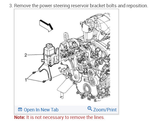

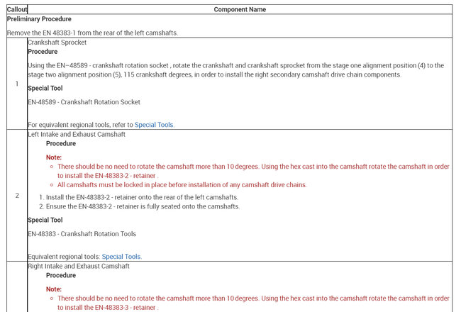

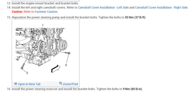

If the engine is out of time, it will make excessive noise. So, we need to make sure everything is lined up. I have added instructions and the timing marks for the timing chain in the diagrams below. Let me know how it goes. Here are the correct timing chain diagrams with timing marks and special tools needed. I also included the timing cover R&R, sorry about that. Check out the diagrams (below). Please let us know what happens.
