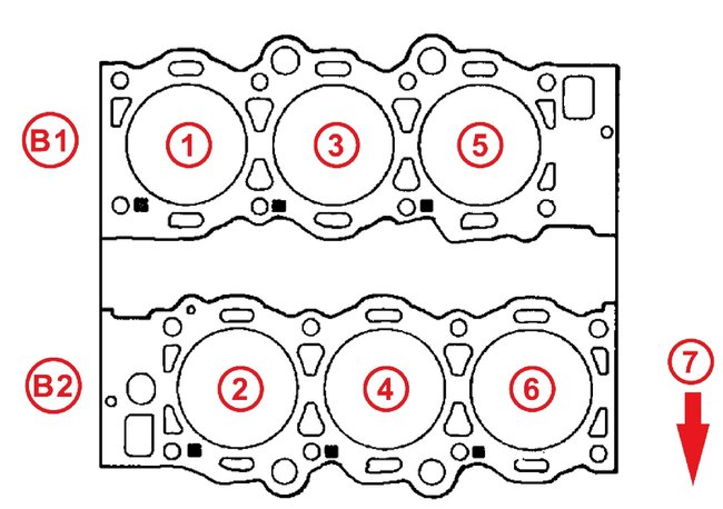

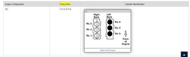

Cylinder six misfire. I want to replace one ignition coil and all six spark plugs, but i do not know the firing order to know which is number six.

I have attached a picture for you. The arrow points toward the front of the vehicle.

Please see the attached image. It is a pull from Prodemand and contains the firing order and cylinder layout. Hope it helps!
