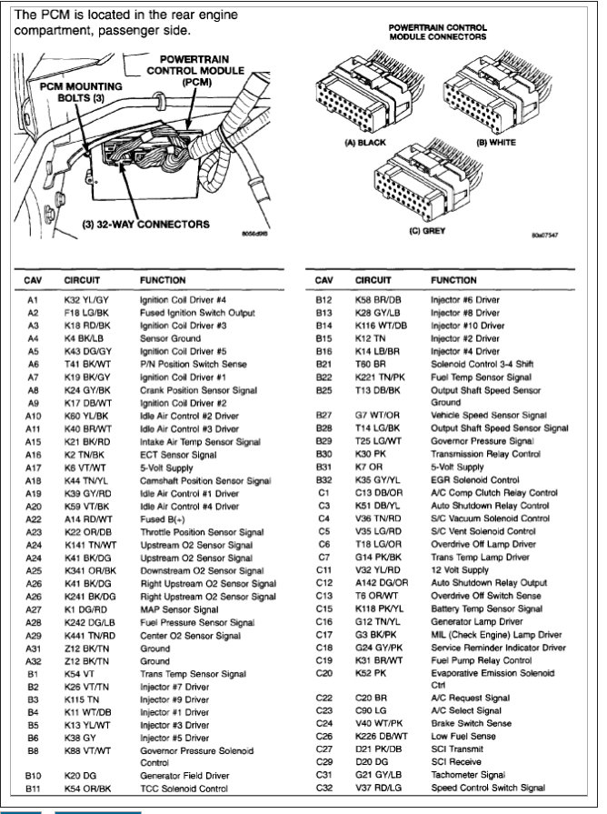

My truck has constant fuel with the key on but no spark. I have changed crank sensor, cam sensor, cap and rotor, coil. Checked all grounds and fuses, still nothing. Has no power to the coil. Please help. thanks in advance.

It sounds like the ASD relay has gone bad. Here is a guide that will help us confirm the problem.

Have checked all fuses & relays & grounds multiple times. Still no change

Lets try reading the codes to see what comes up. This will let us know if we are missing anything obvious.

Have hooked a few scanners up, unable to read anything. Through error

Yep it sounds like the PCM is gone and needs to be replaced.
Here is its location, I would get a used one so its plug and play.
