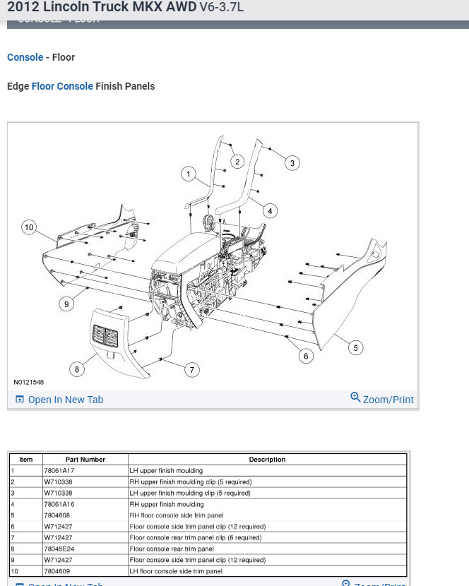

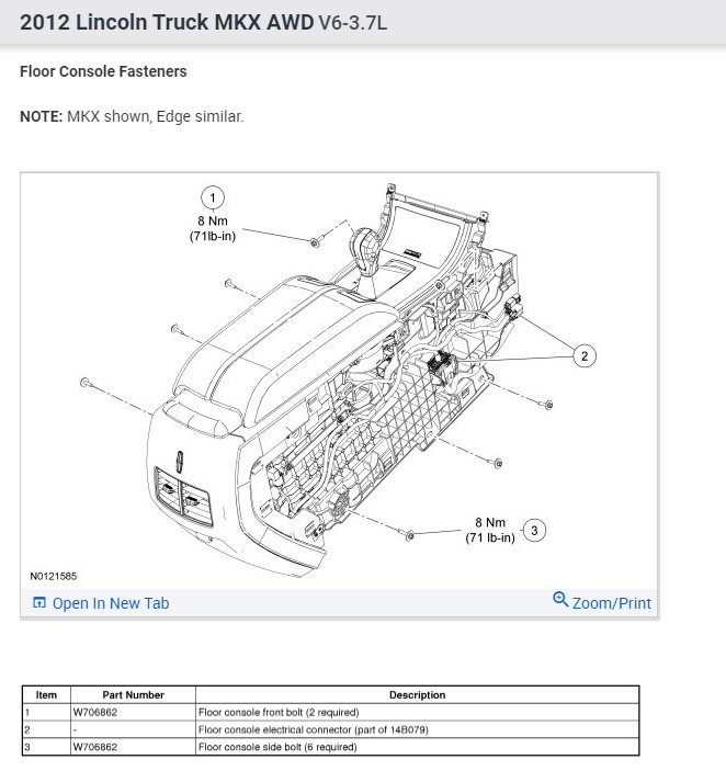

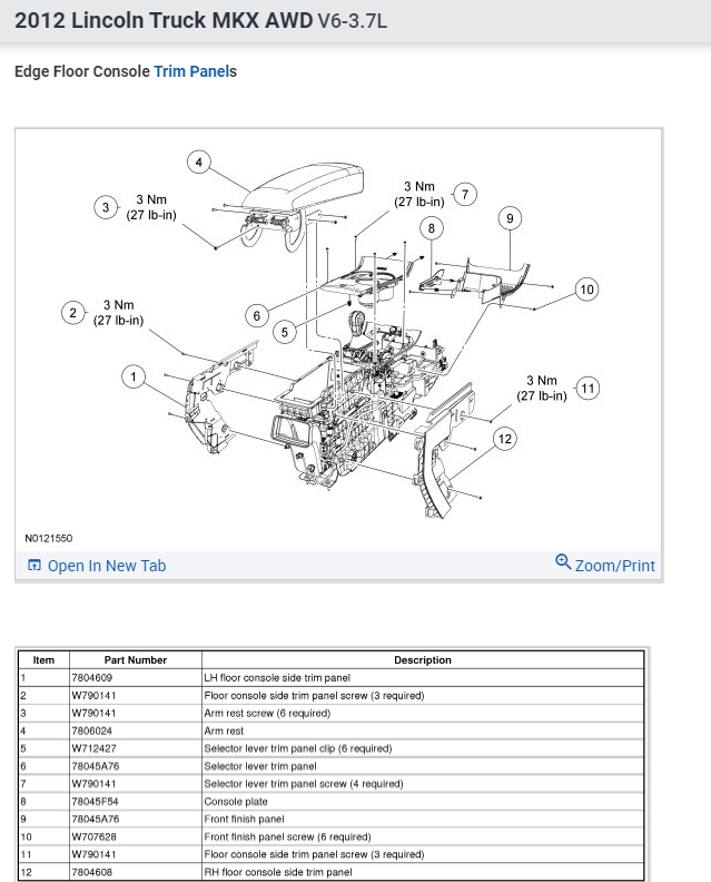

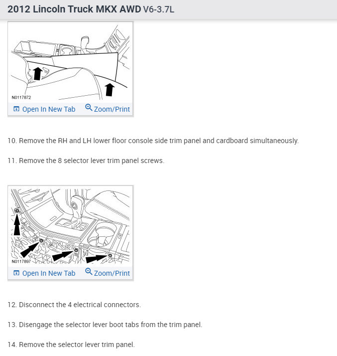

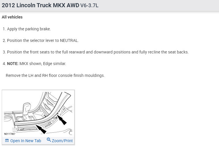

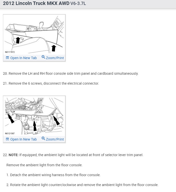

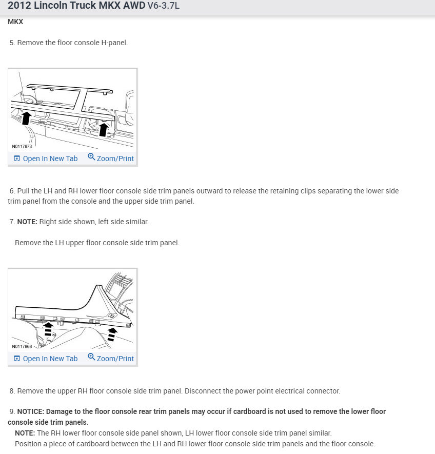

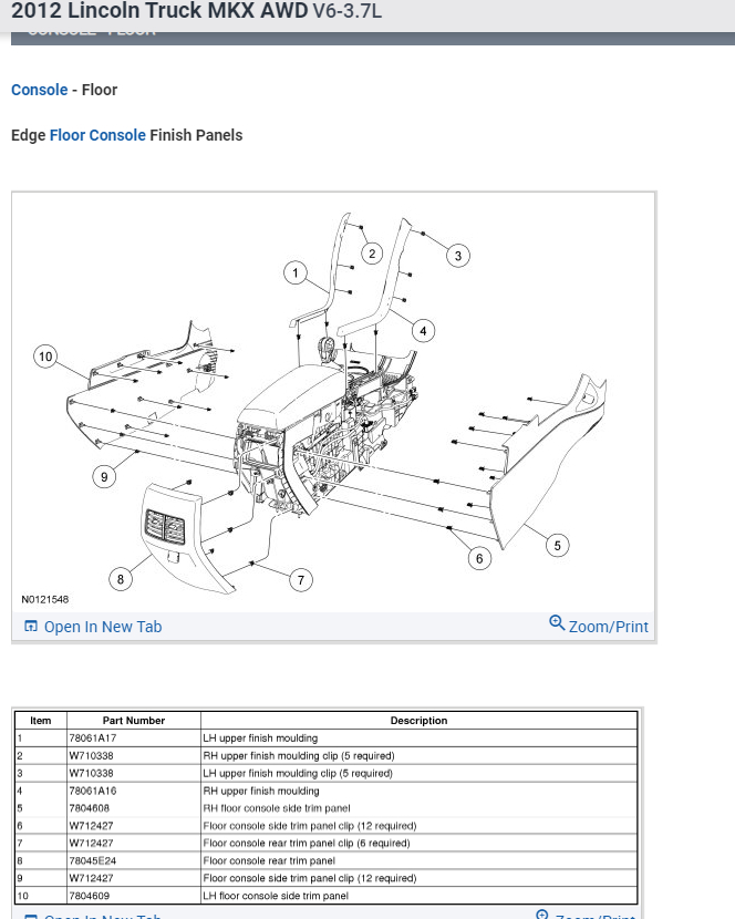

How to safely remove console to access compartment under shifter?
2012 LINCOLN MKX
140,000 MILES
1RETIRE1
MEMBER
1 POST
Dropped a key in there and need to retrieve it.
Jul 6, 2022 at 11:59 AM
SQM
Experienced Mechanic
6,383 POSTS

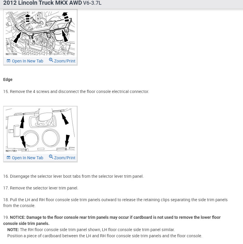

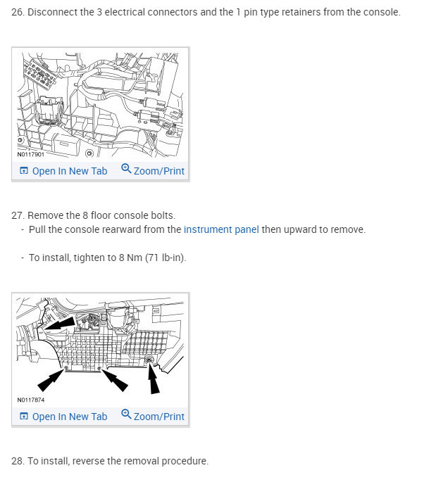

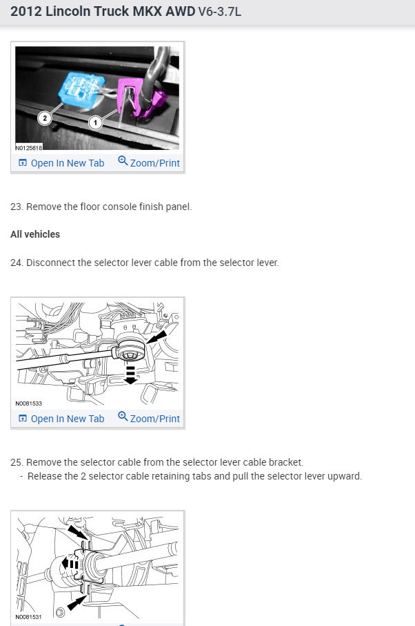

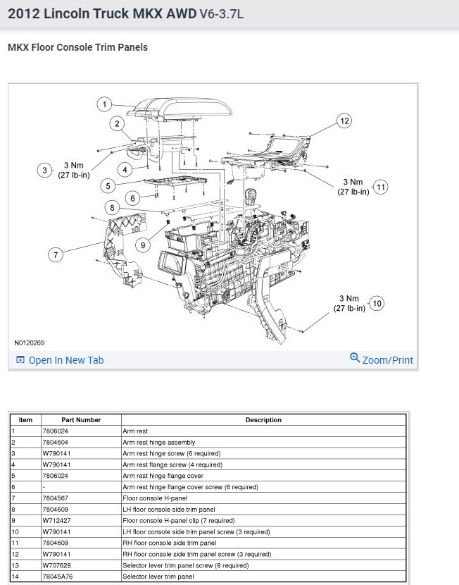

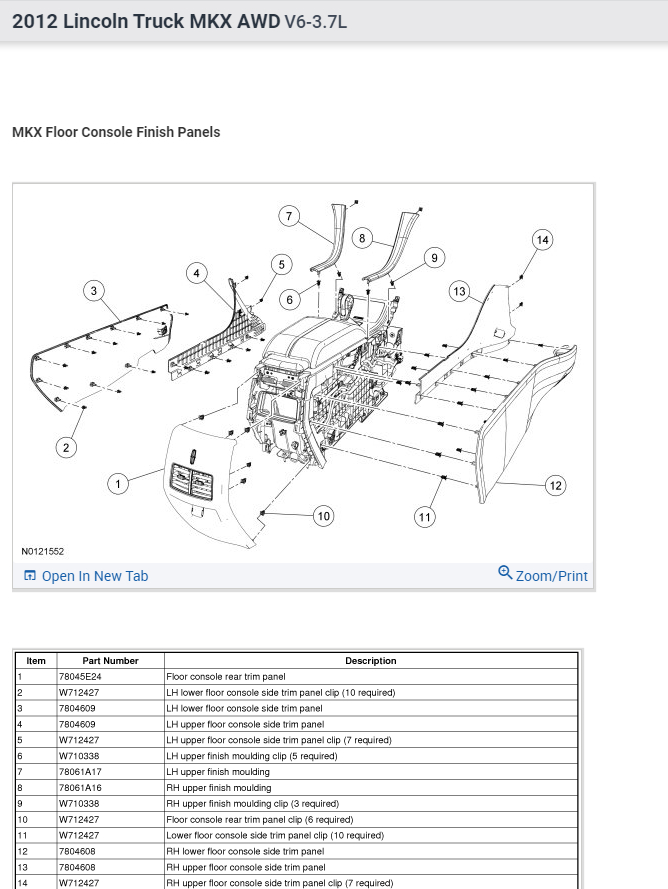

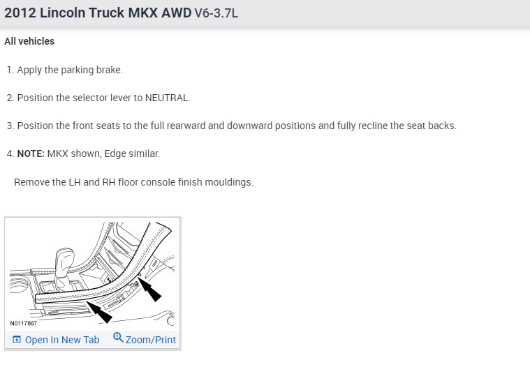

I have attached the complete breakdown of the center console below.
Let me know if you have any questions.
