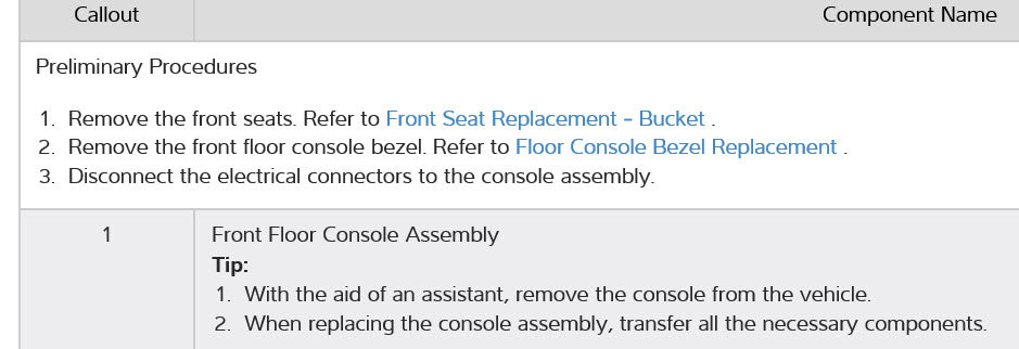

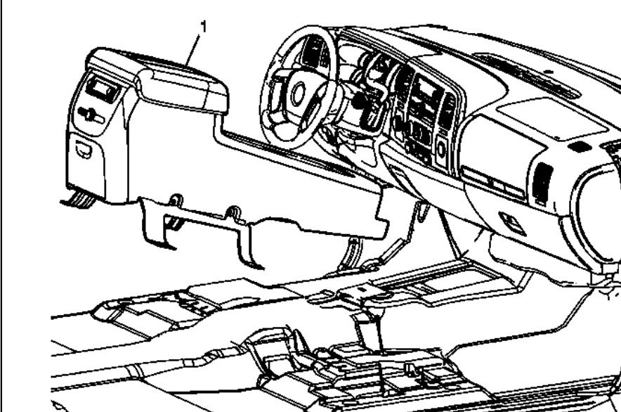

How do l remove the center console on a LT classic crew cab pickup?
Oct 6, 2016 at 9:22 AM
HMAC300
  • 48,601 POSTS
see pictures for removal install is reverse of removal.
