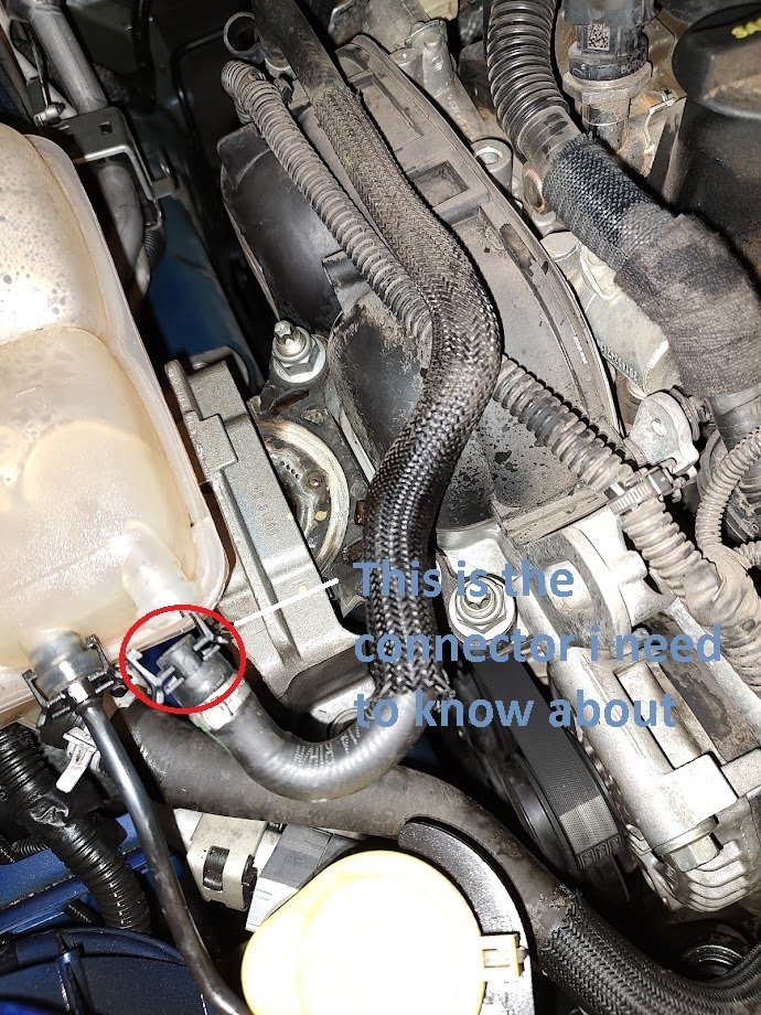

one of the connectors on the coolant reservoir broke, and i need to replace it. I don't need a new hose, that's just fine. i just need to know what those connectors are called so i can find one and get it.

Can you upload a picture of the broken part?
Is it one of the connectors on the reservoir that broke?
Generally speaking, those connectors that are on the coolant reservoir are not available to purchase separately and come with the reservoir.

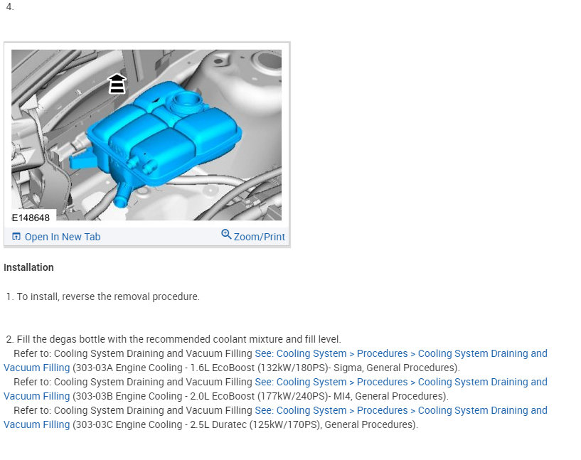

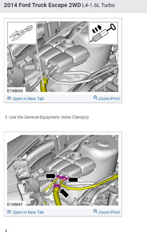

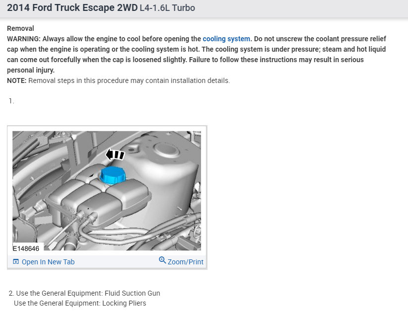

https://www.2carpros.com/articles/coolant-reservoir-replacement

here is the photo.

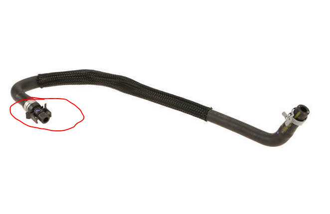

sorry here it is. someone had to have made it, so it must be for sale somewhere.

That quick connector is not available just by itself. It will require purchasing the hose. One thing you can try (unless you already have) is to call your local Ford dealer and see if they are able to just get the quick connector for that hose. Sometimes the dealers will have access to those smaller pieces.
