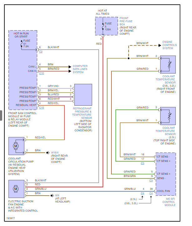

Did the connector break? If not, you can just clean the connector and it should be fine. Here is the wiring diagram so you can see how the fan cooling system works to turn on the fan motors. Also check the fuse #5 on the right side of the engine bay fuse panel.

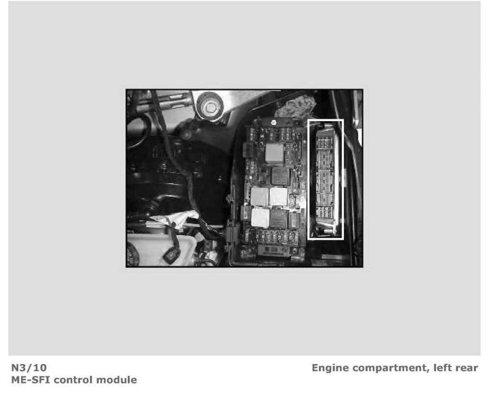

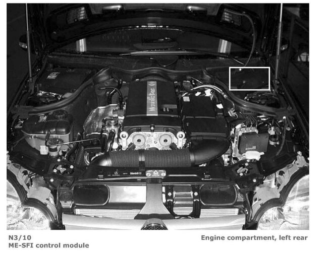

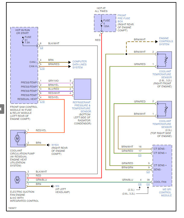

Usually, it will be the fan controller which is near the rear of the engine compartment. here is the location and the wiring diagrams so you can see how the system works. Also, please check the fuse # 5, 125 amp in the fuse panel right rear of engine compartment. Here is the location on the ME SFI control unit to see if you have any burned connections.
Check out the images (below). Please let us know what you find. We are interested to see what it is.
