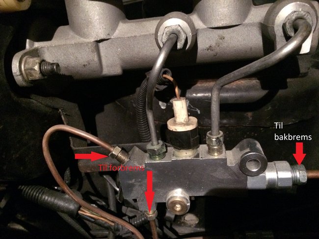

Rear drums: how should the lines go from master cylinder to proportioning valve? We have no rear brakes, and I wonder if we have routed it wrong. Everything is okay, but pedal goes to the floor.

Hi, thanks for quick reply. We have Corvette calipers in front and original drums at the rear. New master cylinder and proportioning valve, all lines were bled out. Master cylinder bench bled, rear brakes adjusted tight. Car brakes on the front but rear wheels keep turning. I see many pictures online of pipe routing, and start doubting how we have routed it.
The picture is how it is routed now. But should I cross the lines an change ports?

I did not see it in English but I will tell you one thing, the large line out of the front goes to the front calipers. The other two lines out the rear go to the rear brakes.
is that how it is plumbed?
The fact you have no pedal leads me to believe you still have air in the system or a bad master cylinder.

Hi Roy. The 1/4 inch tube goes to the rear. The two 3/16 to the front. When we bleed, there is good stream out of all bleeder screws, and the pistons in the wheel cylinders in the drums move. But the rear brakes will not hold when we brake. So maybe I would try to cross the lines from the master cylinder to the proportioning valve. I have seen pictures of that.

New or not, it may be a bad master cylinder.
No, I would not cross the lines at all. That will affect braking and could cause pulling. this is a bad idea.
I would find someone with a pressure bleeder to force fluid through the lines. You could still have air trapped in the lines.

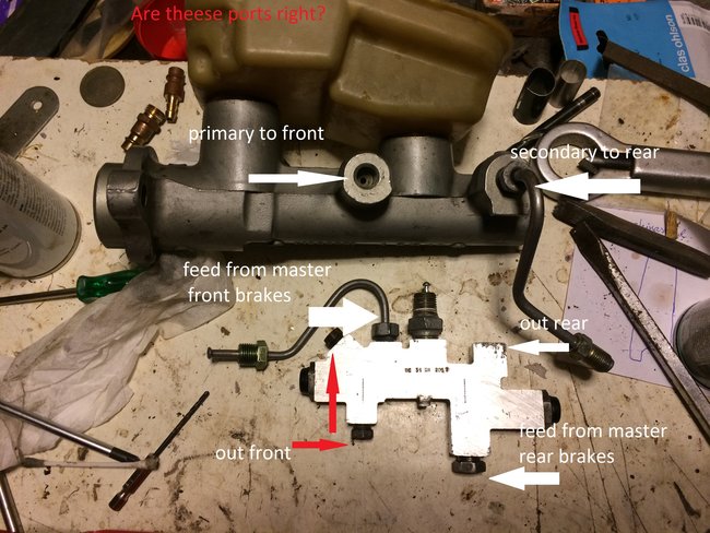

Sending you picture of the old master cylinder and proportioning valve. Are the ports correct "named"?

Here it is.
Knut
Nov 30, 2018 at 2:50 AM
Yep, that looks good.

Thanks, then I will change to the old proportioning valve, witch by the way, was connected from secondary out port on the master cylinder, to the outlet port to rear brakes on the proportioning valve.

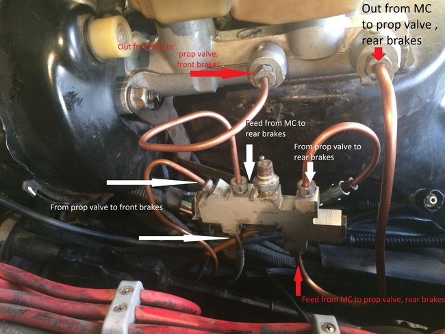

Hi again, now I have routed the lines from master cylinder to prop valve the way I believe it should be. I am bleeding the system now. Can you confirm that this is right, as you said last time? It is a 1987 Camaro with disks at front and drums at rear.

Looks good.

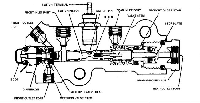

Found this diagram for you.

This is not the valve we have. We have the original GM third gen F body valve. What concerns me is if I got the rear brakes plumbing correct. I think that the feed from the master cylinder should go to the port on the underside of the valve, then it gives pressure to the seal on the small piston and spring inside the valve, forcing the piston to move and let the brake fluid pass to the out port on the top, and to the rear brakes. If the feed from master cylinder goes in on top, the pressure comes on the wrong side of the seal, and will not have any effect on the piston and spring.

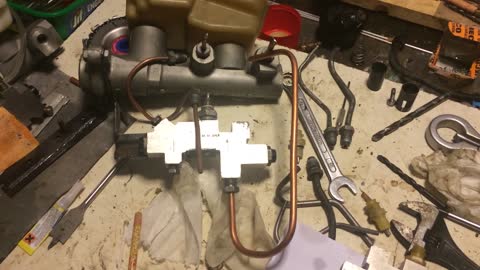

I am sending you a video I made. Prop valve plumbing.

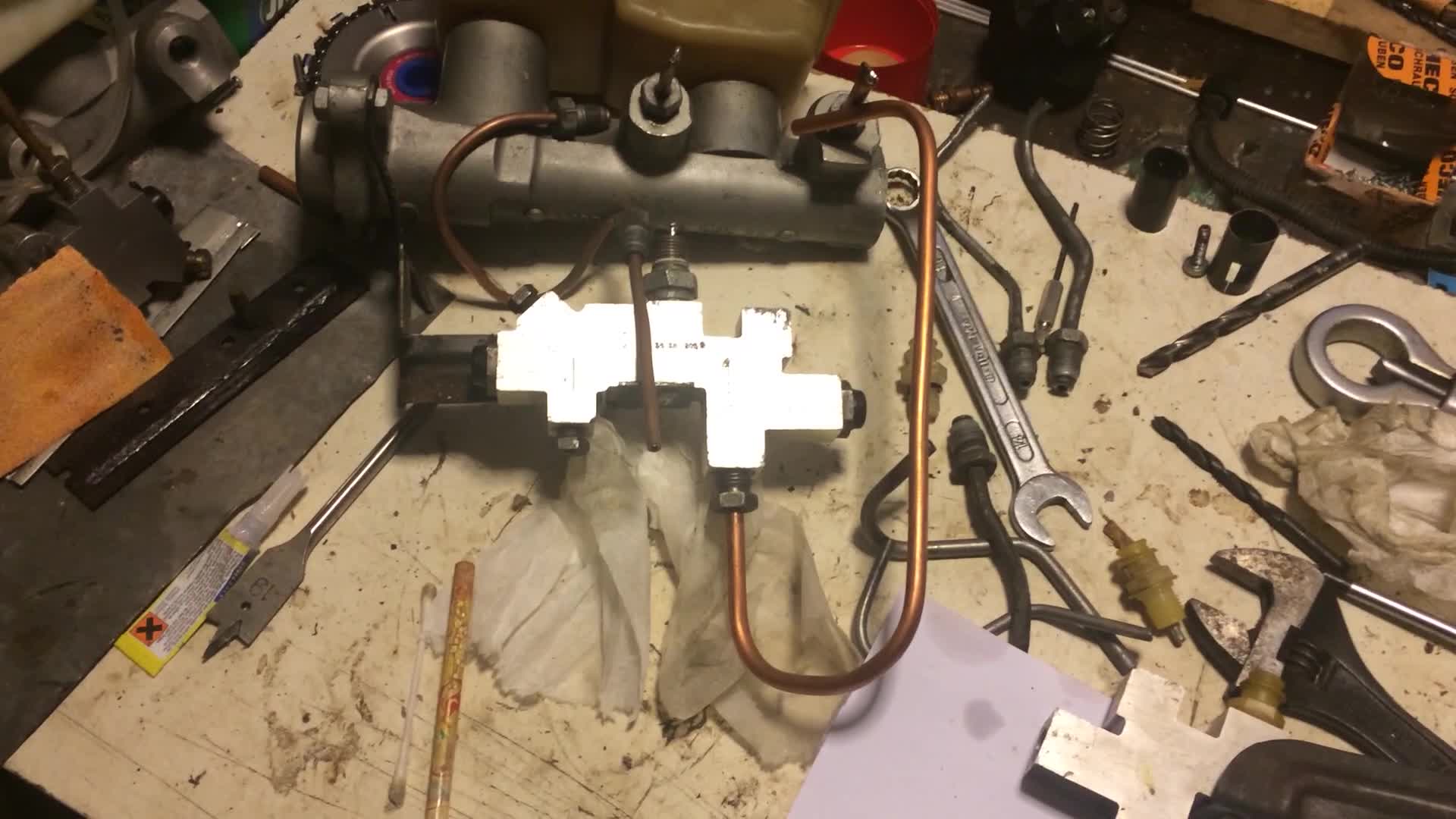

Here is a video I made: Brake lines from master cylinder to prop valve.

The inlet for the front is at the top. The ones below are for each front side.
The inlet for the rears is on the top as well.

I do not know if you see what I mean. I have got the front.
But I think the pressure to the rear brakes on the piston and seal should come from the correct side of the seal, where the lip is. And that is in the port on the underside.

On my video, the red piston, there is a black seal with the lip facing to the right. There is a small hole just under there from the brake line, and on top, the hole to the out port and brake line is to the left of the seal. So when applying pressure , the brake fluid will press the seal and piston to the left and let the fluid pass and go up to the outport and to the rear brakes.
That is the way I see it in my head.
Knut
Dec 10, 2018 at 3:16 AM
I understand what you are saying but I am not an engineer and take the word of the information systems that I work with.
