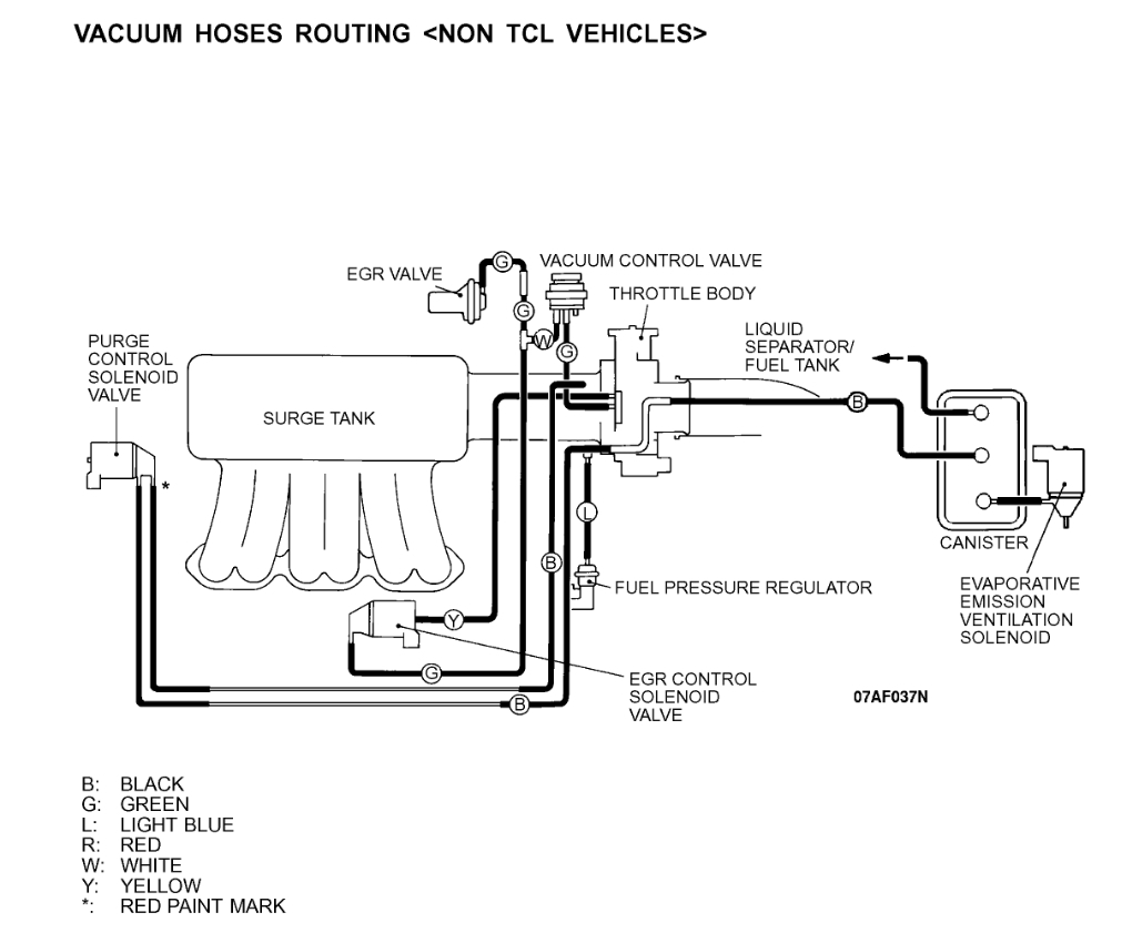

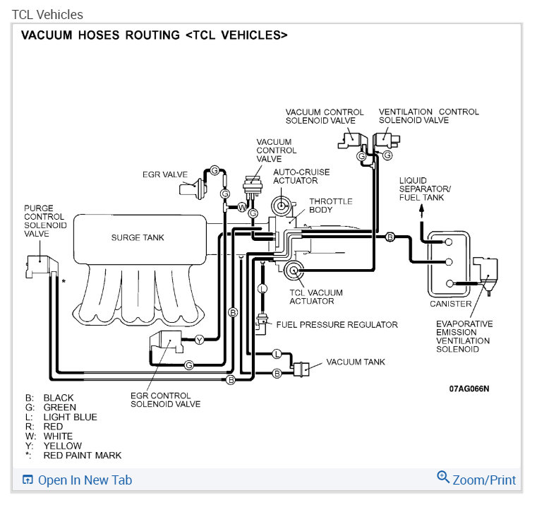

I recently did a valve cover gasket change.. but now can’t remember exactly where all the hoses go back to.
Jun 10, 2020 at 7:28 AM
  • 55,711 POSTS

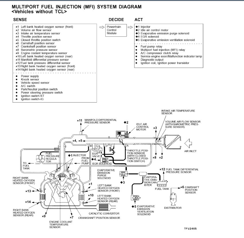

Here are the vacuum hose routing for you car in the diagrams below. Check out the diagrams (below). Please let us know if you need anything else to get the problem fixed.
