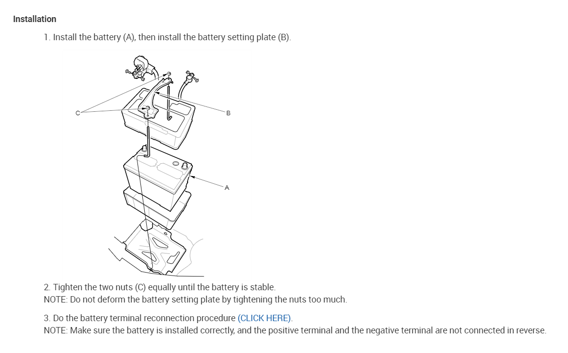

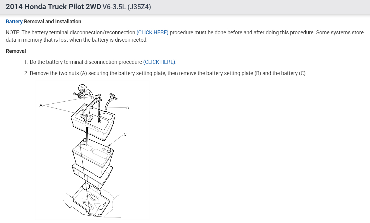

Yes, it does sound like the battery is bad, or you have a bad connection at the battery, we can test the battery without equipment if you follow this guide:
and
Here are instructions on how to change the battery out. Check out the diagrams (below). Please let us know what happens.
