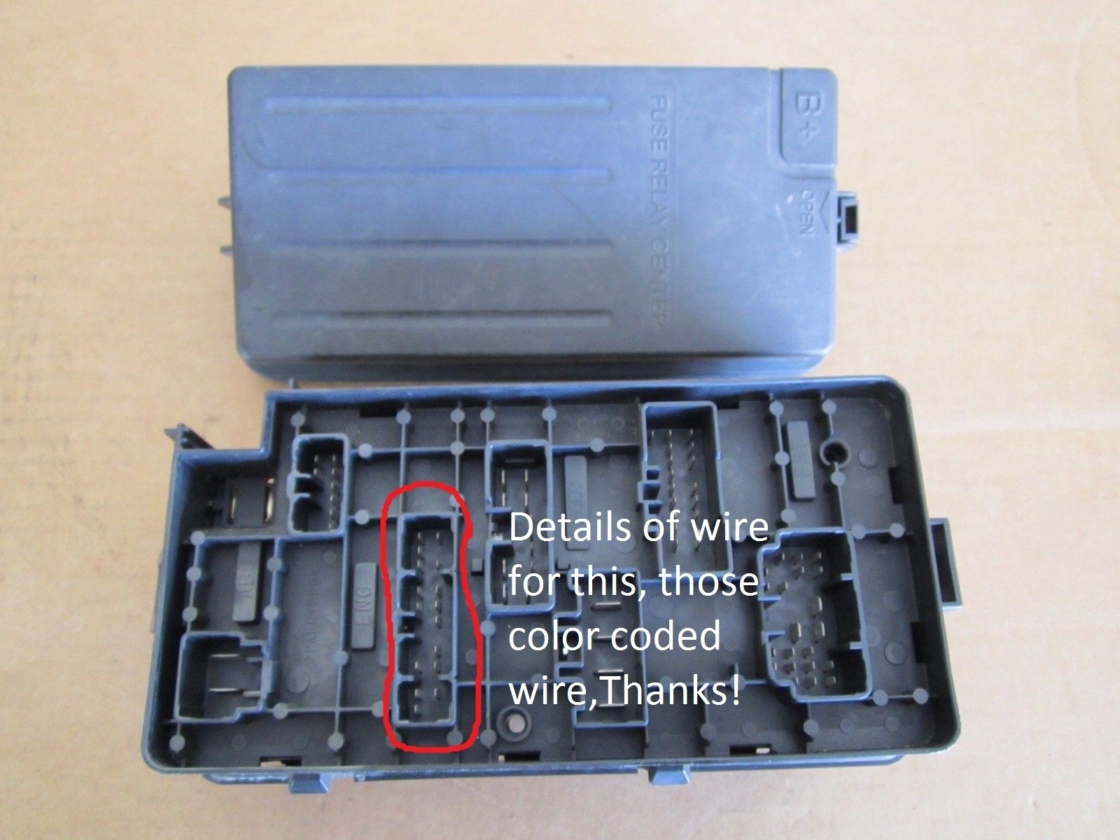

Greetings. I have the following problem: in the fuse box the connectors were destroyed and I can't get how to put the cables in their correct position so I can start my car.

Unfortunately, we don't have a manual on your vehicle so we don't have a wiring diagram to give you the specifics that you need. However, I may be able to offer a better solution.

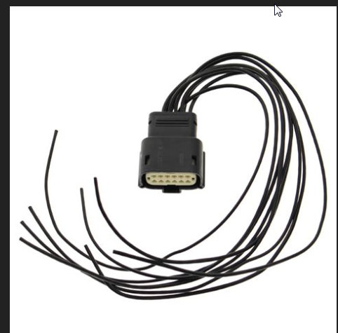

If I understand correctly, you need to replace the connector that connects to the fuse box? If that is correct, it would be better to find what is called a pigtail connector which is a new connector with wires already connected to it. Then you just need to cut each wire off the old connector one at a time and put it to the same position on the new connector. I attached a picture of this below so you can see what I mean.
If you cannot find one of these then I would go to a salvage yard and find a similar vehicle and just cut this connector out of that vehicle. This may be a little more leg work in finding it but it will be much easier then trying to match each wire to the pin.
Hope this helps. Sorry we don't have more detail on this
