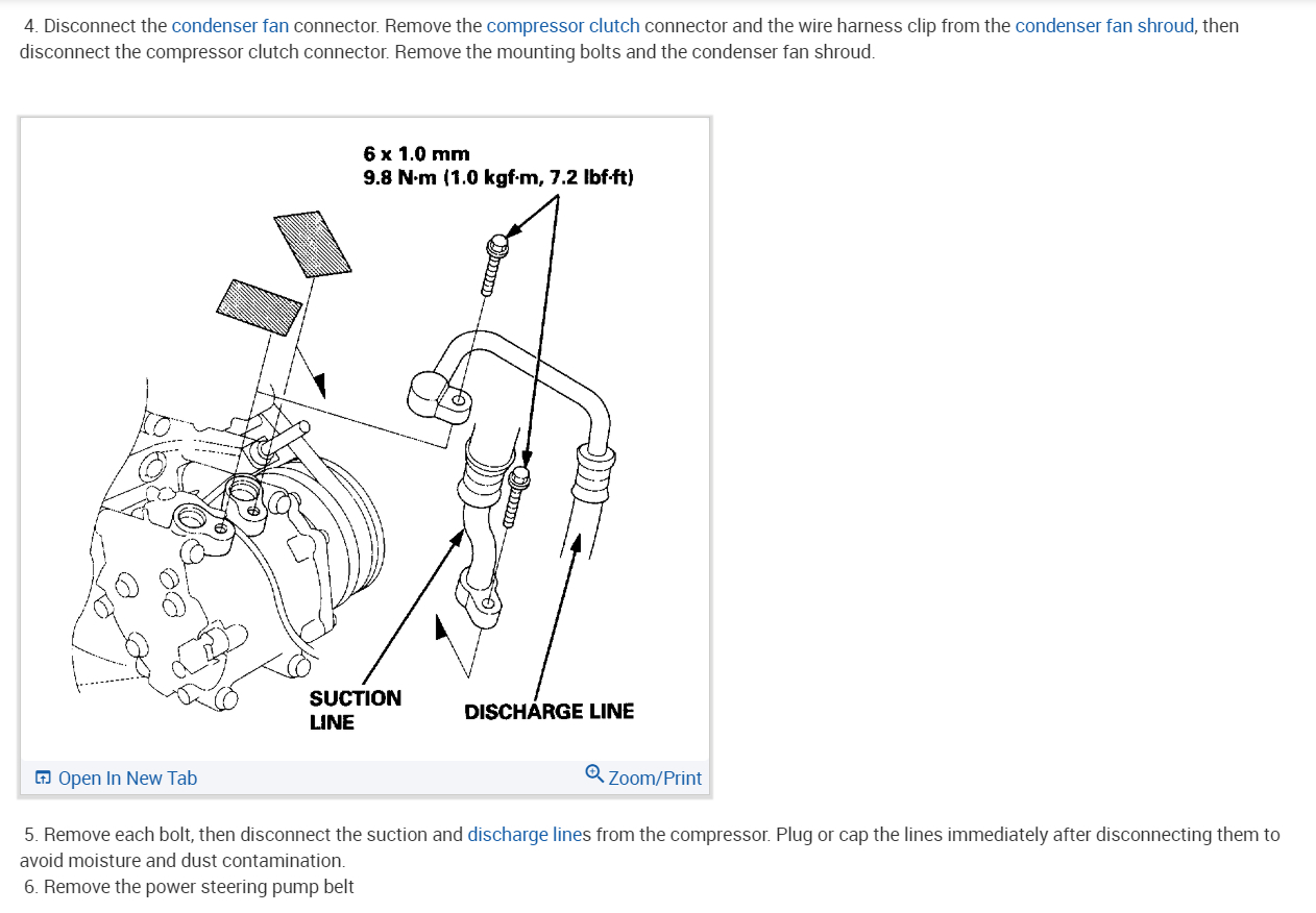

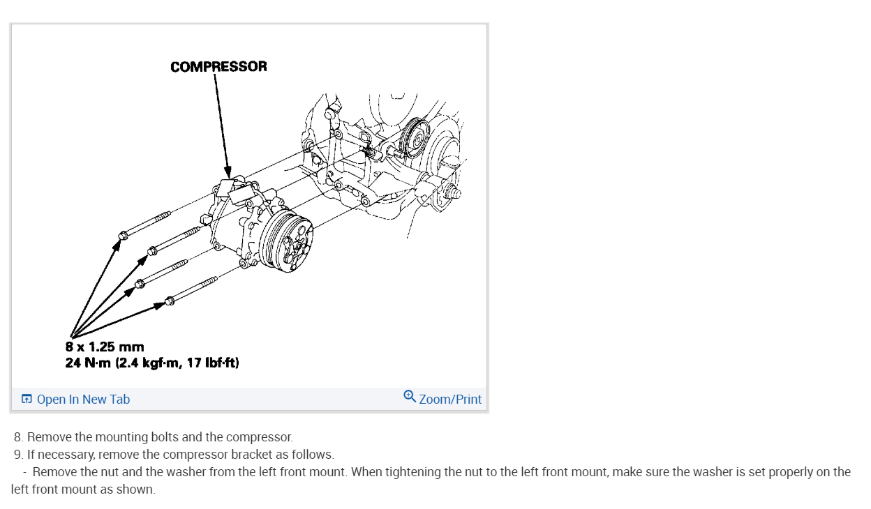

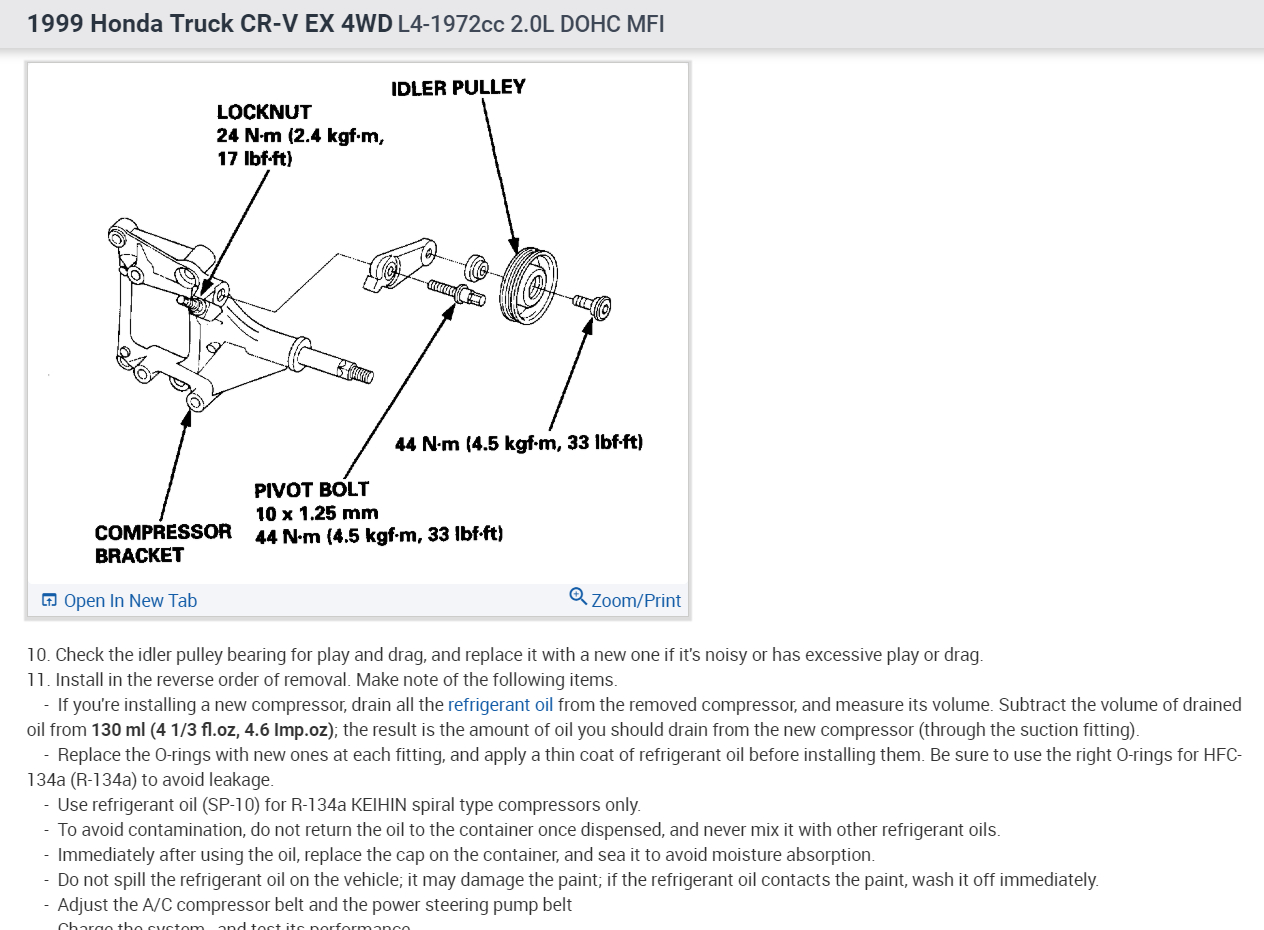

It sound like the compressor clutch has shorted out but to be sure replace the fuse and disconnect the compressor to see if the fuse blows once the AC is turned on. If not the compressor needs to be replaced. Here is a guide to help walk you through the steps with guides below to show you on your car:
https://www.2carpros.com/articles/replace-air-conditioner-compressor

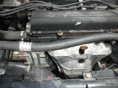

I had a Freon leak repaired about one year ago, the replacement Freon had dye in it to detect future leaks. In the last week, my A/C stopped working completely. When I checked under the hood, there was a bright red substance around the component that holds motor oil. The horizontal seal around that component in particular has this substance in the crease.

GORILLACOMPANY
I tried to locate the A/C compressor, but I don't know enough figure out what it is. I attached the picture, everything red appears to be new within the last few days.
https://images.2carpros.com/forum/automotive_pictures/531721_P5270024_1.jpg
The red substance is all around the crease, and seems to have dripped down on other engine parts.

KHLOW2008
  • 41,812 POSTS
That is the valve cover and the red substances seems to be sealants. I don't see how sealants could be dripping.
Under normal circumstances, sealants are not used as the valve cover gasket is a rubberised seal and is compressed to prevent leakages.
The compressor is the component at lowest point of engine at front part where it has a belt going over it.
When A/C is turned ON, the outer part should click and attache itself to work.
