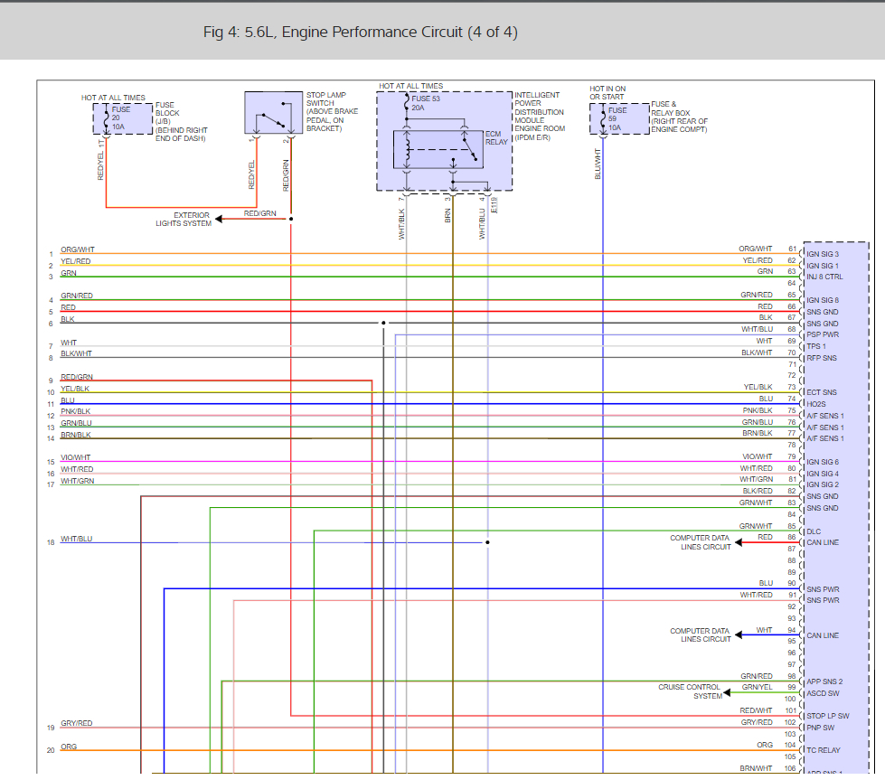

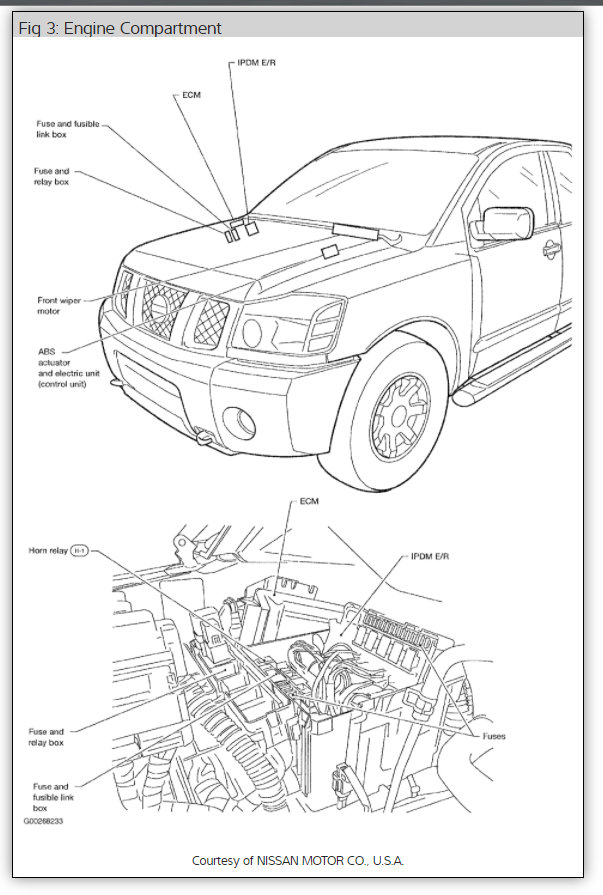

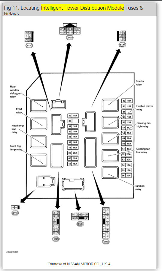

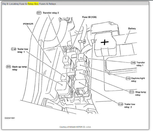

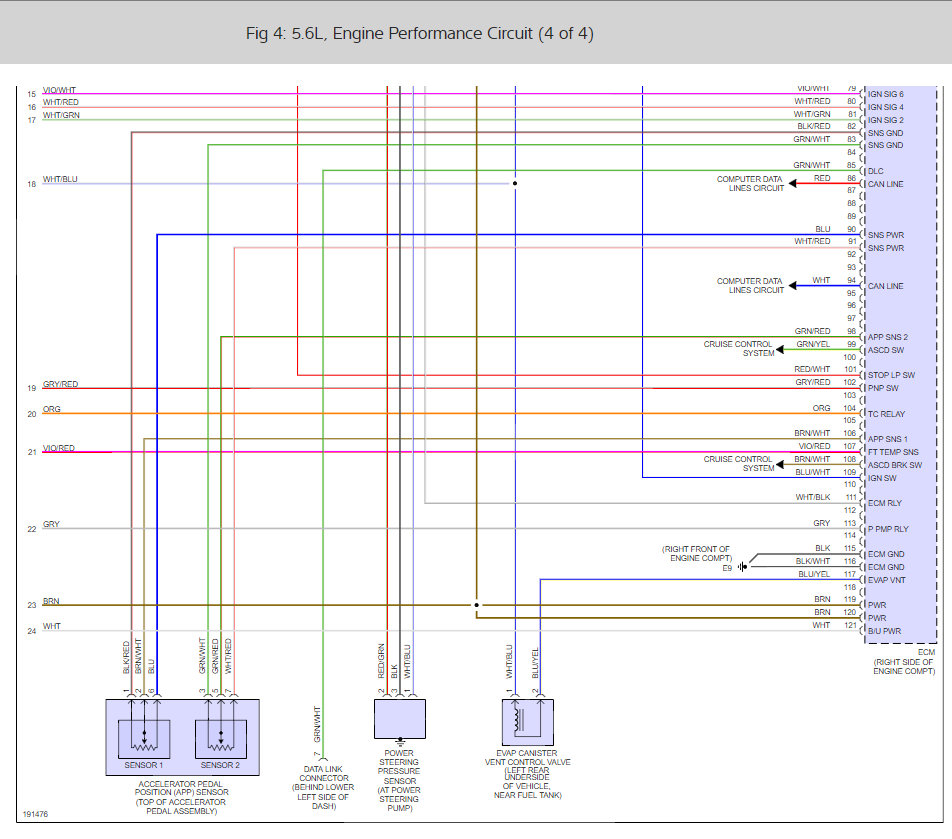

There is an ECM control relay that sound like has gone out, to confirm the problem here is a guide and some diagrams (below) that will help us get the problem fixed.

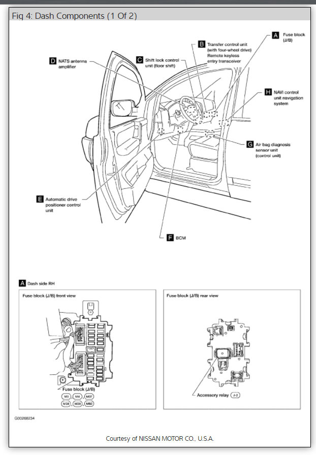

Thank you Ken..I tried changing the relay..no luck, however I only unplugged it and plugged the new one in. It still just turns over. My scanner will not tie into the vehicle, reads error... Is there a way to test the I.P.D.M board? Also I know I was having a problem with the T.C.M could that cause a stall out and no start if the t.c.m burned out rest of the way...little silver box under dash on passenger side 3"X2" roughly.
