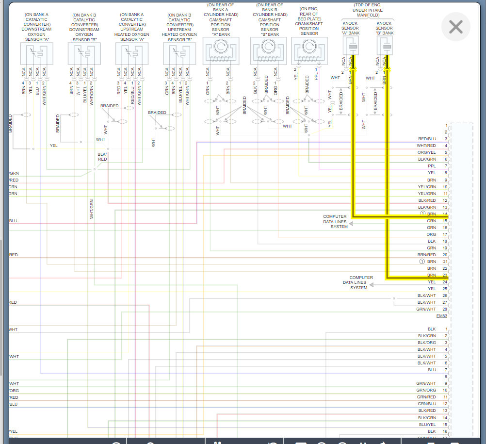

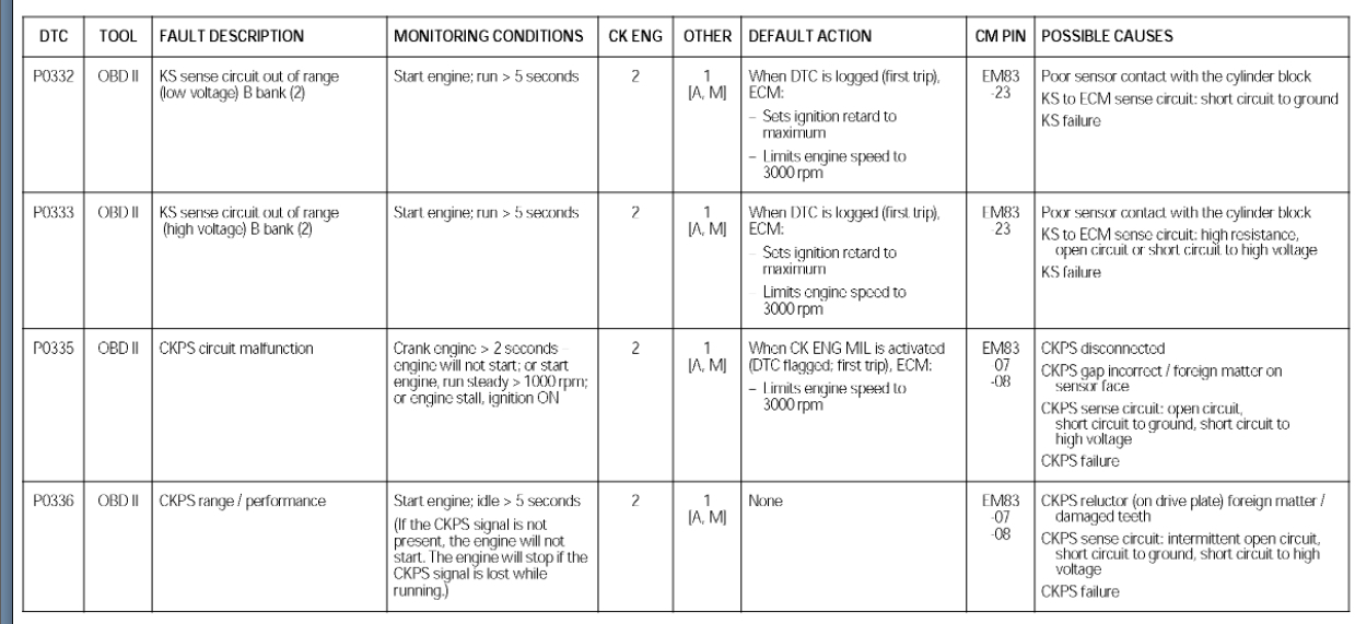

I would suggest checking one of the other codes and making sure it leads to the PCM as well.
I would suggest using one of the knock sensor codes.
https://www.2carpros.com/articles/how-a-knock-sensor-works
However, the fact that you have a circuit low code on both points to the PCM as well.
It is highly unlikely that you have two knock sensors that are shorted.

I did notice the same knock sensor code. Do you suggest to follow these two wires back to the harness? There's barely any room in this engine bay.
Sep 5, 2021 at 11:37 PM
Correct. You have the same circuit codes but some of the others are gone. So you don't have to program the PCM for it to start monitoring all these circuits. So that tells you that the PCM had issues but the 3 circuit/CAN codes are your issue.

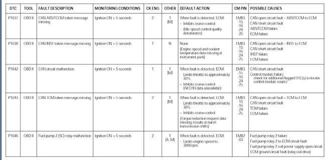

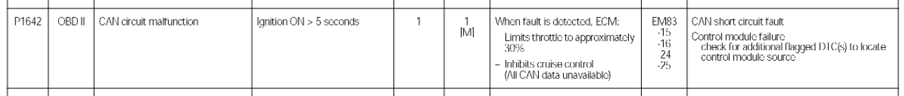

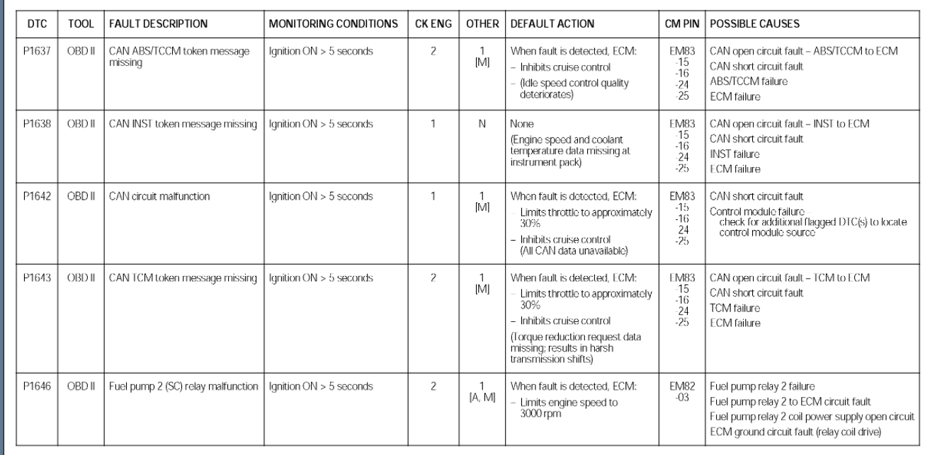

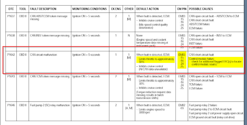

Okay. If you are getting that message with out even starting the engine then you have a circuit issue.

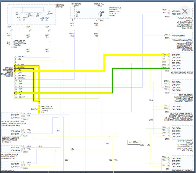

I would go no further then the P1642, I attached the info below for it, where it states the CAN circuit is shorted or the control module is the issue. Due to the other PCM faults that would be the module effected but clearly that doesn't appear to be the issue.
Plus this code is the one causing the limited power as it states below.

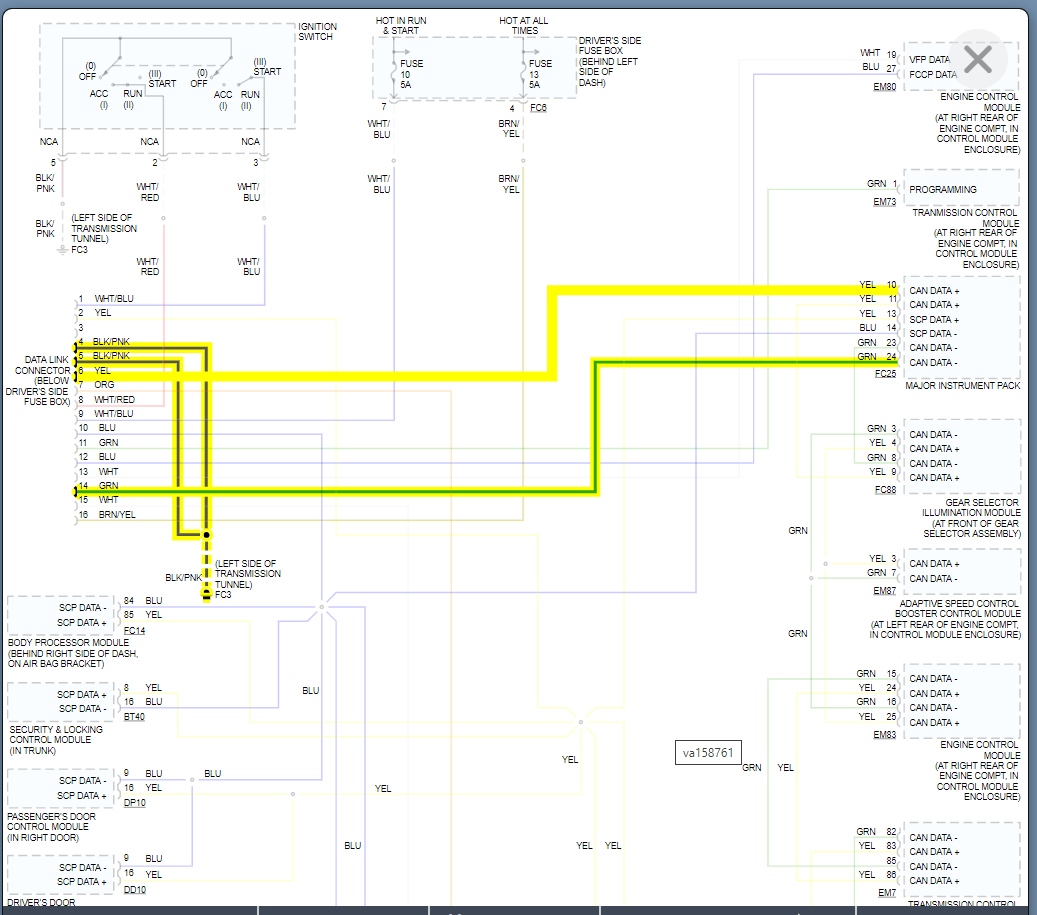

What I would do is check the voltage at the DLC on pin 6 and ground. Then 14 and ground.
Let's see what the voltage is on both of these and start working through it. I suspect they are going to be wrong but we need to start at the beginning.

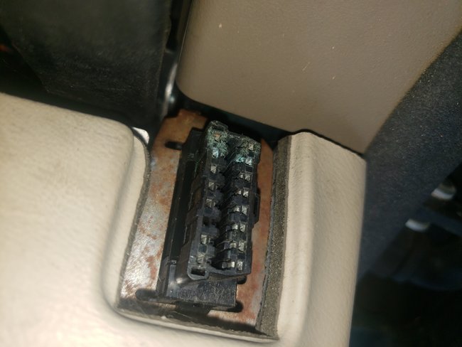

As for the voltages, #14 to both grounds read at 1.84 Volts at both pins. #6 to both grounds fluctuated between 0-2.4volts.
Sep 9, 2021 at 4:45 AM
Oh man. That is an issue. It may not be the issue but that is the connector that we need to check those voltages and that is definitely an issue.
So these voltages need to add up to 5 volts. That is the way these modules communicate is the messages are coded based on the varying voltage. However, if one is 2.8 volts then the other is 2.2 volts.
They should not drop lower then 2 volts on the low side (pin 14) or higher then 3 volts on the high side (pin 6).
The fact that you have the low side at 1.84 volts shows it is being pulled to ground and the high side is the same thing. It should not be dropping to 0.
The fact that you have corrosion on this connector is where we need to start because if these pins are shorted to ground due to that corrosion then that is going to be the issue.
However, even if it is not the issue, it is something that will cause issues when you are trying to use the DLC.
Was this vehicle in a flood? I am not sure I have ever seen a DLC that corroded.

I replaced the connector. Now I am getting 1.84 volts at pin 14 and 3.02 volts at pin 6. I don't think this is any better. ha
Sep 11, 2021 at 8:31 AM
Unfortunately not. The next step is to continue monitoring this voltage (easier if you have two meters) and start unhooking modules that is on this network and see when the voltage returns to 2.3 volts and 2.7 volts.
When it does, you just disconnected the issue. It is either the connector, wiring, or module.
The fact that you already found corrosion that, means we need to be looking for that in these connectors as well.

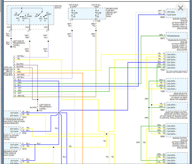

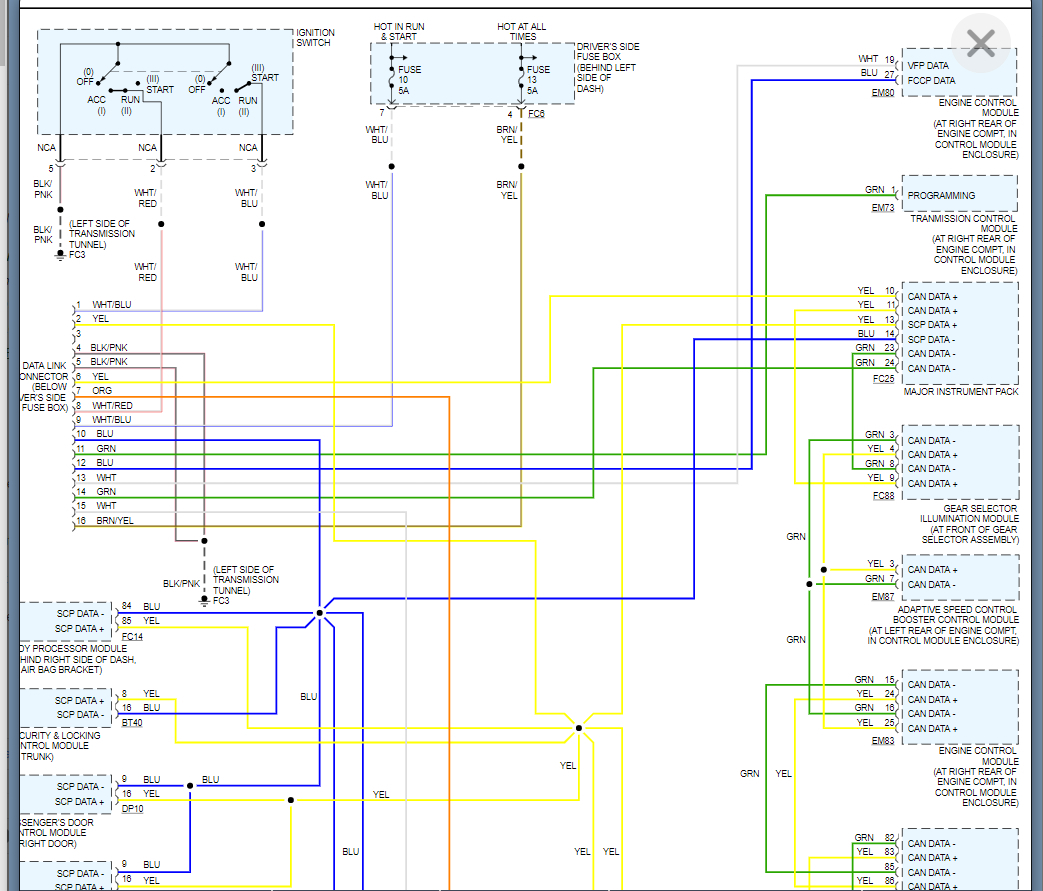

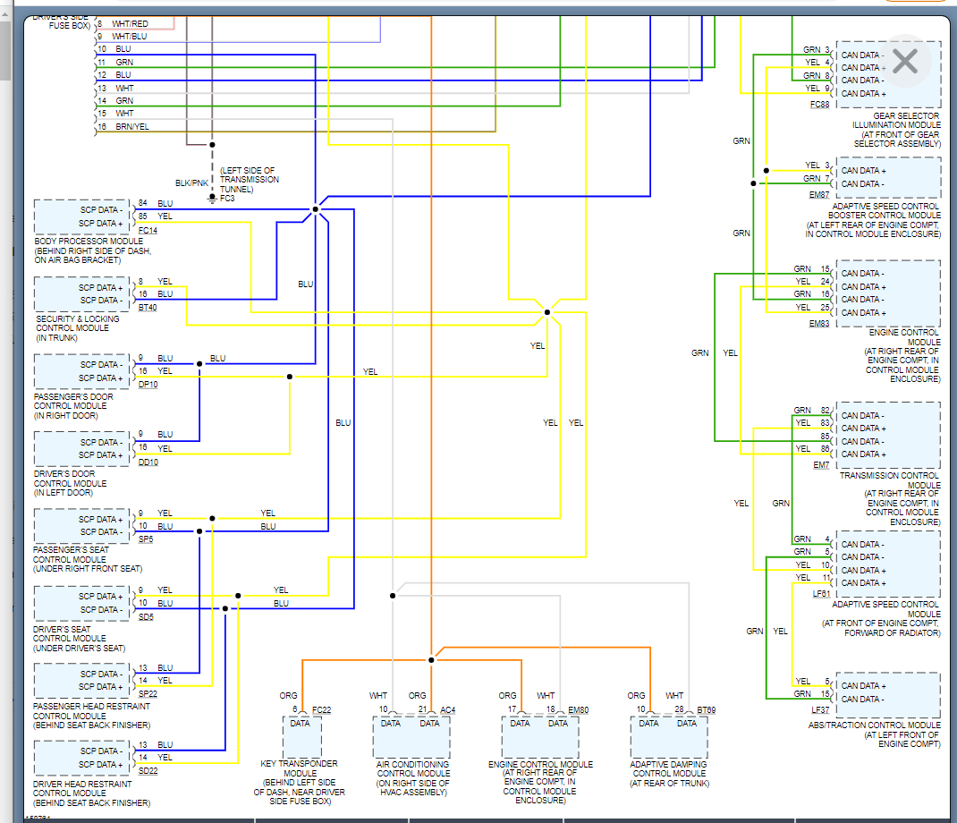

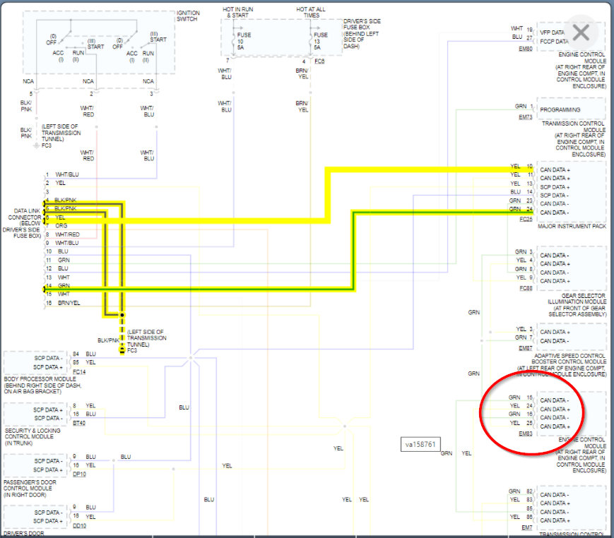

I would start with the ECM. See the wiring diagram below for all these modules.
Sep 11, 2021 at 1:20 PM
CANNON1349
  • 861 POSTS

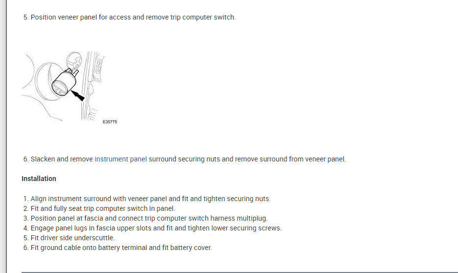

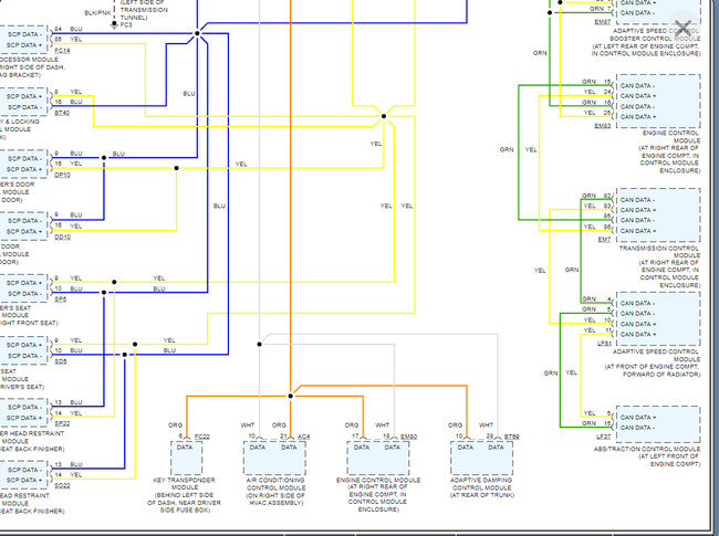

The two wires you had me check go straight to the instrument pack, according to this. How do I remove that to check? I have a hunch about it being such a short distance from this dlc connector.
Sep 11, 2021 at 10:47 PM

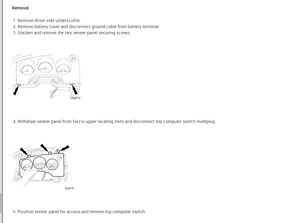

Correct. That is the cluster. I attached the info on that. Basically they treat this as a gateway or pass through module.
So they use this to access all the other modules from the DLC.
The only issue you are going to have, is you will have to access the voltage of this network from another source because you will lose your connection once this is out.
The voltage on this network is going to be the same anywhere you check. So if you disconnect the cluster then just check the voltage on the network to all their all modules. Not the wiring to the DLC. Looks like 13 and 14 are the pins to the rest of the network.
If the voltage returns normal on these wires then the cluster is the issue.

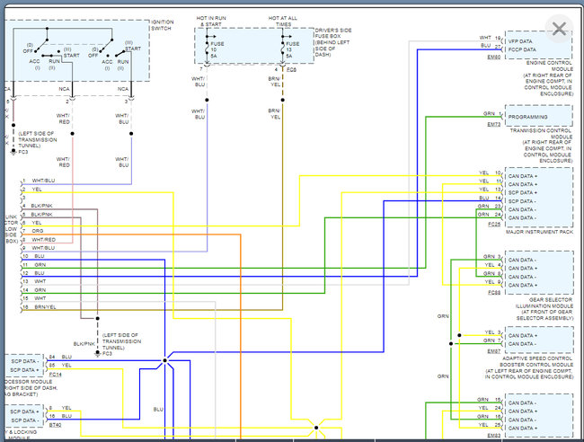

13 goes to the white wire at the ECM , but it says only one white and one blue wire, looking at it on the car the only setup where this exists is the fan that cools off the ECM. I get 12 volts whether or not the instrument cluster is plugged in or not.
Sep 12, 2021 at 5:06 AM
Okay. Those two wires, white and blue that go the ECM from the DLC are not part of this CAN system.
So just to be sure I was clear, you want to measure the voltage on any of the wires on that diagram that are labeled CAN data + or -.
So as you are unhooking these modules we need to know what the voltage is on these two wires. They are going to be the same no matter where you check it in the system as they are all spliced together onto the same circuits so we just need to know when they return to 2.3 and 2.7 volts (or close to it).

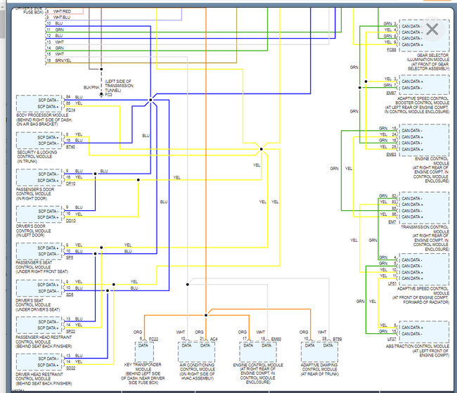

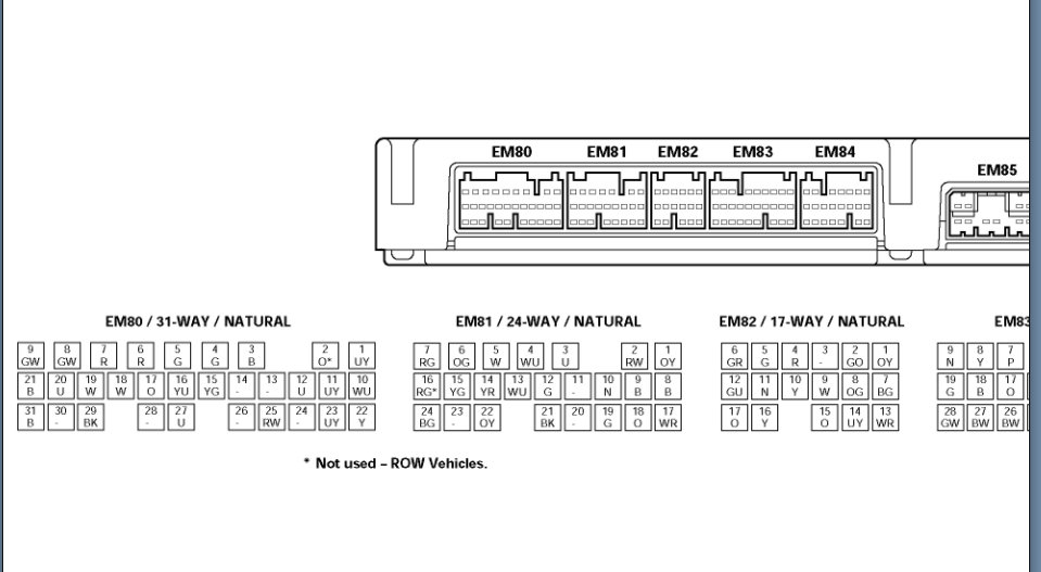

None of these wires add up. There's way more wires at the ECM than shown. And they aren't numbered either, I'm getting confused .
Sep 14, 2021 at 5:36 AM
Correct. This wiring diagram is only going to show wires that are part of this system.

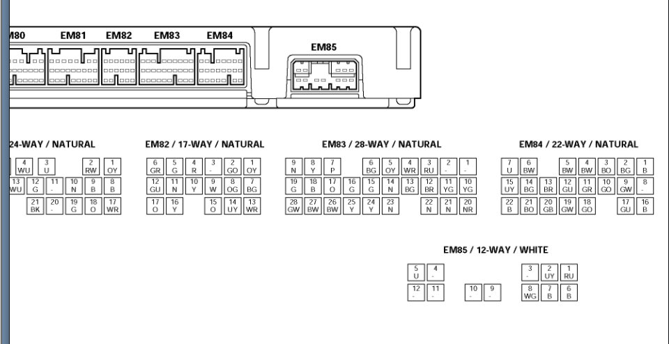

So hopefully this connector view of the ECM will help with this.
These wires are on EM83 connector. Then they are numbers 15, 24, 16, 25.
Sep 14, 2021 at 9:49 AM

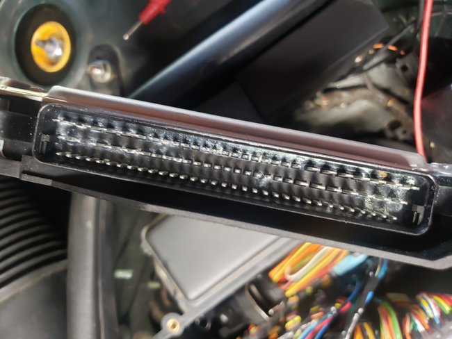

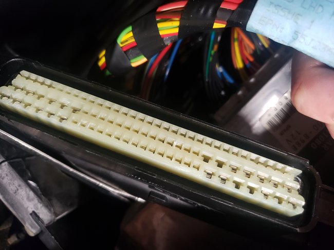

Okay. First any corrosion on these pins will cause shorts so that needs to be addressed. Was this vehicle in a flood? This is a lot of corrosion. If it was then we are going to have all sorts of connectors that look just like this.
As for the voltage readings. Those are not close to being correct. However, I just want to make sure you are checking these correctly. Are you checking the voltage from pin 15 to 24 and then 16 to 25? Or are you checking the voltage on pin 15 and the other lead on ground? Then 24 and ground, 16 and ground, 25 and ground?
Sep 16, 2021 at 5:38 AM

Okay. Let me try and breakdown what is happening. It will help if you look at the wiring diagram of this network while reading through this.
This CAN network is what we call daisy chain network. That means starting at the DLC the wires run to the cluster. Then from there they go to the gear selector, then the adaptive speed control and so on down the line.
So with everything connected, you have incorrect voltage on the entire network. You checked this at the ECM so before the ECM (modules above the ECM on the diagram) your voltages were close but not correct. This would indicate an issue in one of these modules or wiring.
However, when you unplug the cluster, which is at the end of this part of the chain, your voltage on these pins (16 and 25) return to perfectly normal.
However, the modules that are part of the chain below the ECM still have incorrect voltage. This means you still have an issue there. Removing the TCM breaks the chain and causes this to have no voltage on that portion.
This is very odd behavior. So I think I am getting more convinced that this was a flood vehicle and you are going to find corrosion in a lot of connectors.
In other words, I don't think you are going to find one thing, replace it and fix all these issues.
You already found a lot of corrosion on the DLC which I have not seen on vehicles that were not submerged in water but you now have multiple places that have considerable amounts of corrosion.
At this point, I would suggest starting with inspecting connectors related to all these modules and any corrosion you find, fix it by replacing connectors or modules and then retest the system. If it is not fixed, check the voltage again to see if is closer to the 2.3 and 2.7 as I suspect the more you find and fix it will slowly change that voltage.
If unhooking the cluster gets that portion of the voltage to return to normal the we have an issue with the cluster as well.

If that is the case, your TCM is an issue. What is not clear on this vehicle is if the 3.11 and 1.90 volts is close enough for it to communicated.
What I would do at this point, is replace the TCM and then plug everything back in and see if you get the P1642 code to return. I suspect all that will be repaired which will fix the majority of these issues if not all of them.
Sep 17, 2021 at 4:09 AM
CANNON1349
  • 861 POSTS
My assumption is that the 3.11 and 1.90 will be corrected once the system is all connected with a functional module.
Sep 17, 2021 at 4:29 AM
That is possible. However, the way this system works is these modules send coded messages across these two wires. The way that it has to do this is by having this voltage spread by the half voltage.
So if the spread is too much or two little the message comes in corrupted so that module doesn't know what it was.
So this amount could be just fine but I agree, we know that TCM is an issue so we need to start with that.
Let us know what happens. Thanks
Sep 17, 2021 at 8:29 AM
CANNON1349
  • 861 POSTS
Sorry for the delay. Had to wait for the part and do some other unrelated repairs. The 17 codes so far have gone away. And the car does drive now and no failsafe engine mode. So far so good. I'm patting myself on the back on this one.
