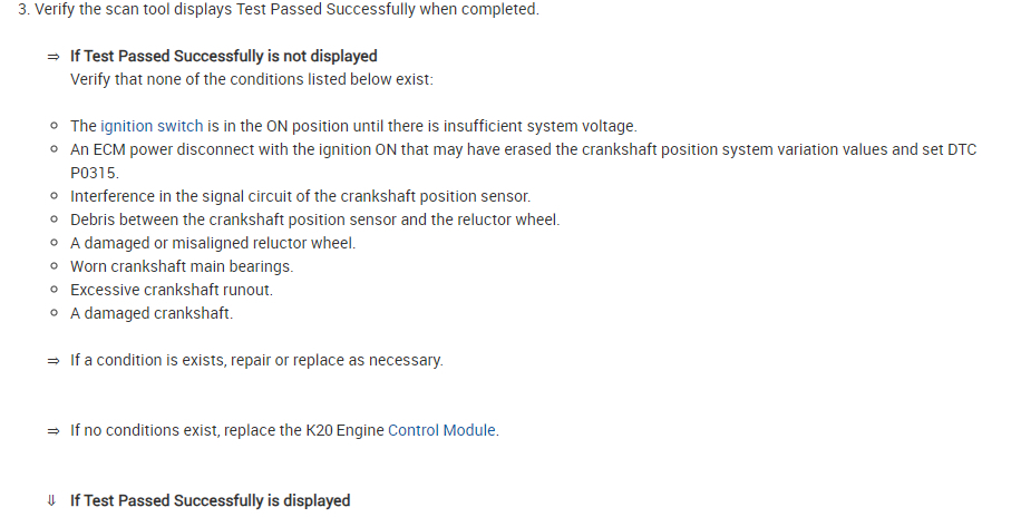

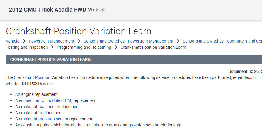

Computer not learning crank position sensor.
2012 GMC ACADIA
211,678 MILES • 3.6L • V6 • 2WD
H_OUSTA2
I have code p0315
Oct 8, 2024 at 10:03 AM
  • 110,244 POSTS

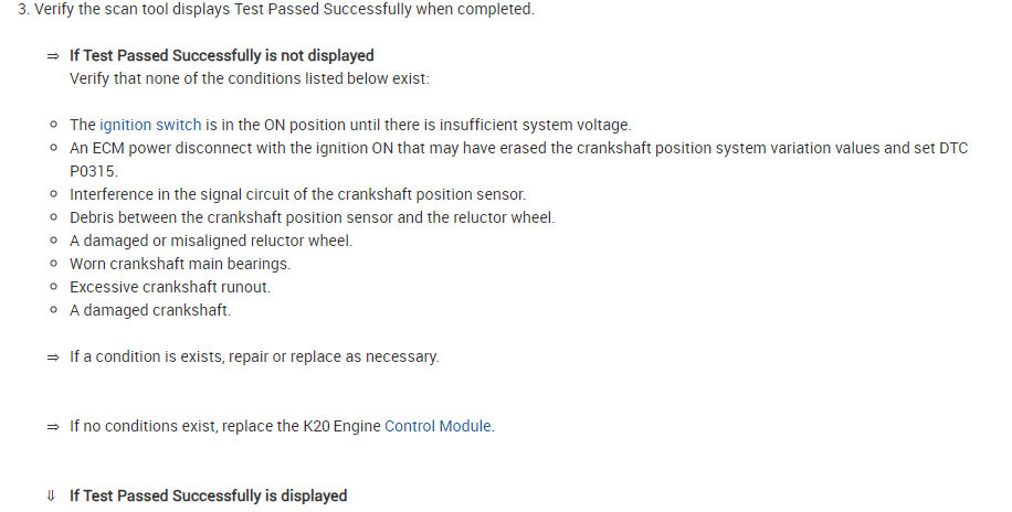

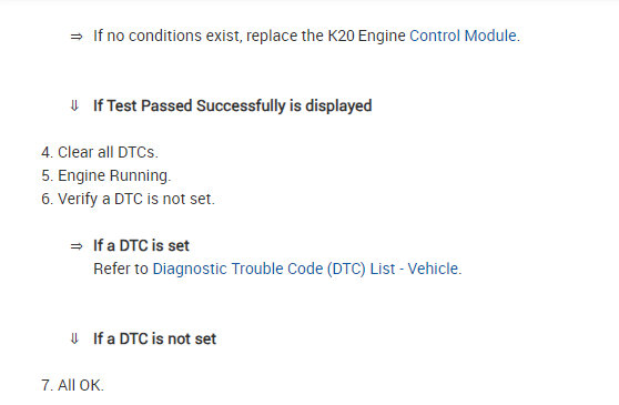

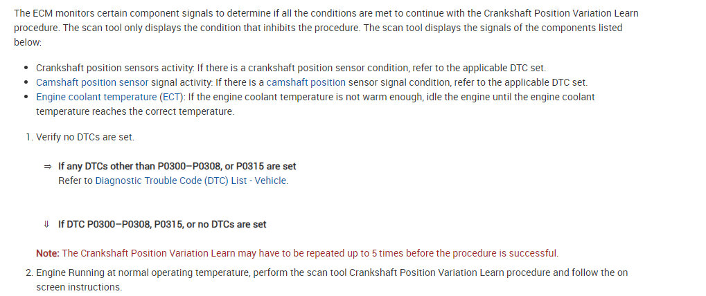

There is a chance it will take more than one attempt to relearn. I attached the directions below for the procedure and testing. You need a scan tool that can perform the procedure.
Take a look at the pics below and let me know if this is something you feel comfortable performing.
