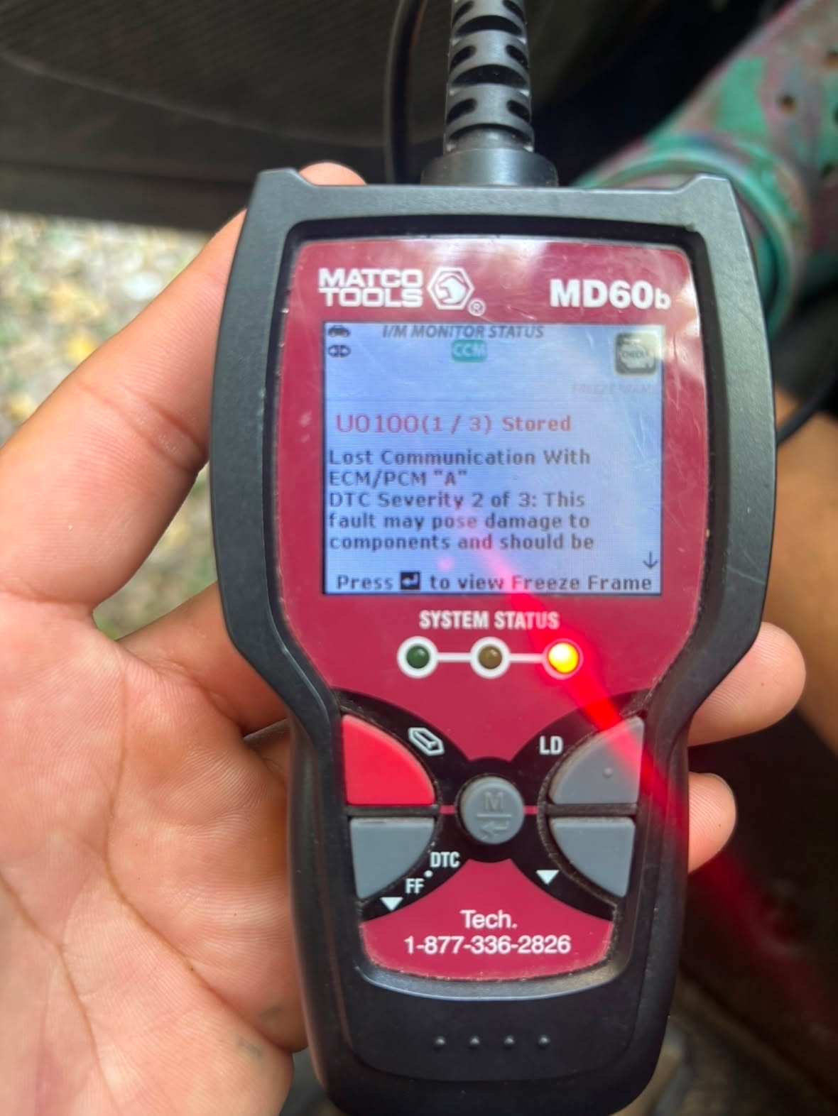

Engine computer not communicating?
2022 TOYOTA COROLLA
90,000 MILES • AUTOMATIC
CLARISSA SAUCEDO
My car is actually a Corolla cross and there wasn’t an option for it. It’s throwing several codes like precollision system malfunction but when hooked up to the scanner it reads “lost connection with ECM/PCM” I’ll attach the picture I got. If I could get pointed in the right direction I would really appreciate it

Yep, I can help you fix it, the first thing to do is check the fuses. Please go over this video to help and then we can go from there.
https://www.youtube.com/watch?v=G-xNK79Wa-w&pp=0gcJCRMMAYcqIYzv
If you have a shorted injector or coil it can pop the fuse for the engine computer which will cause this issue.
