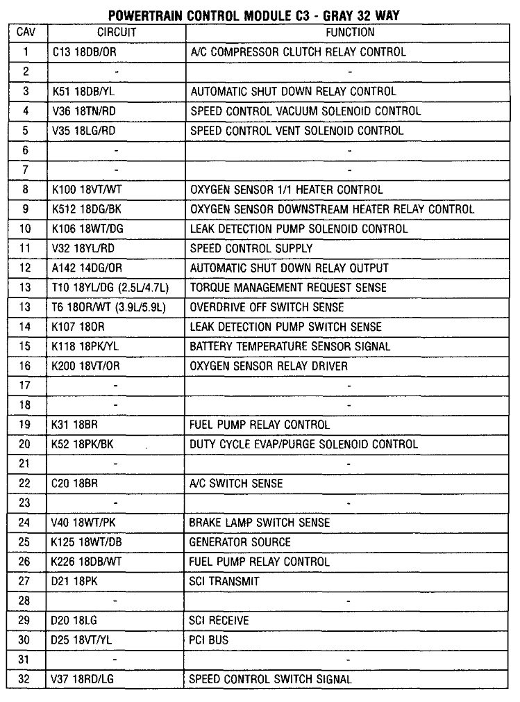

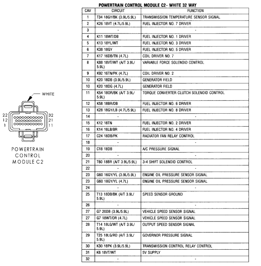

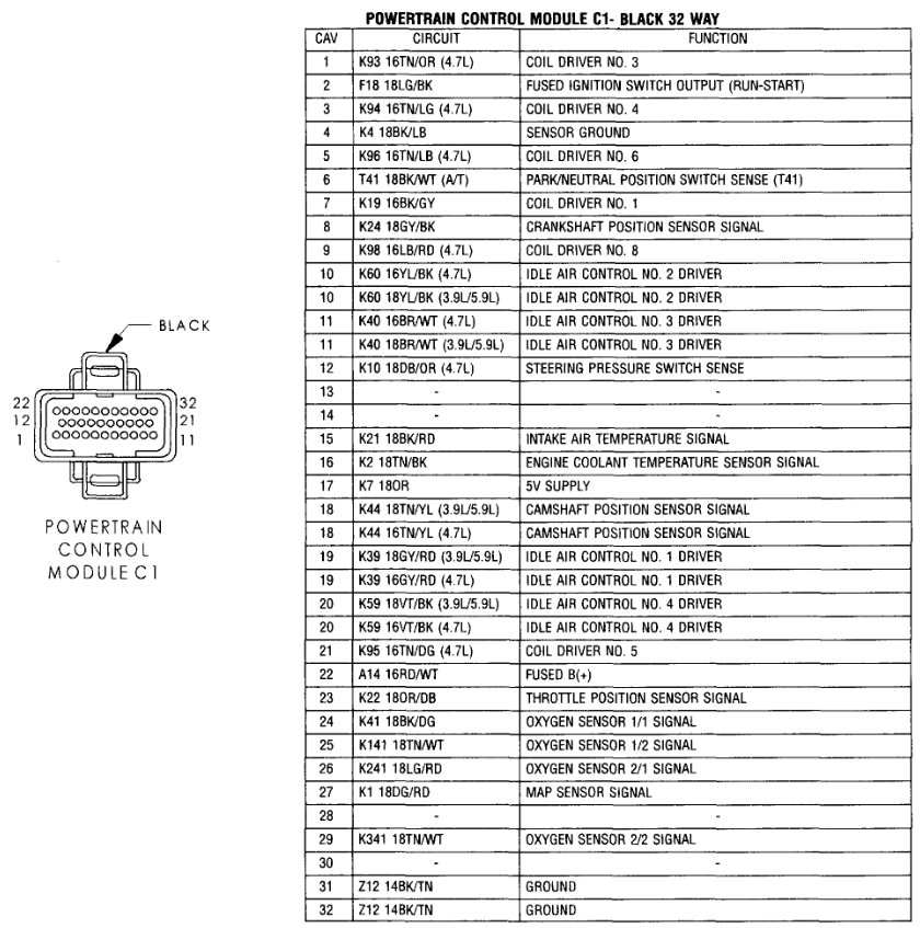

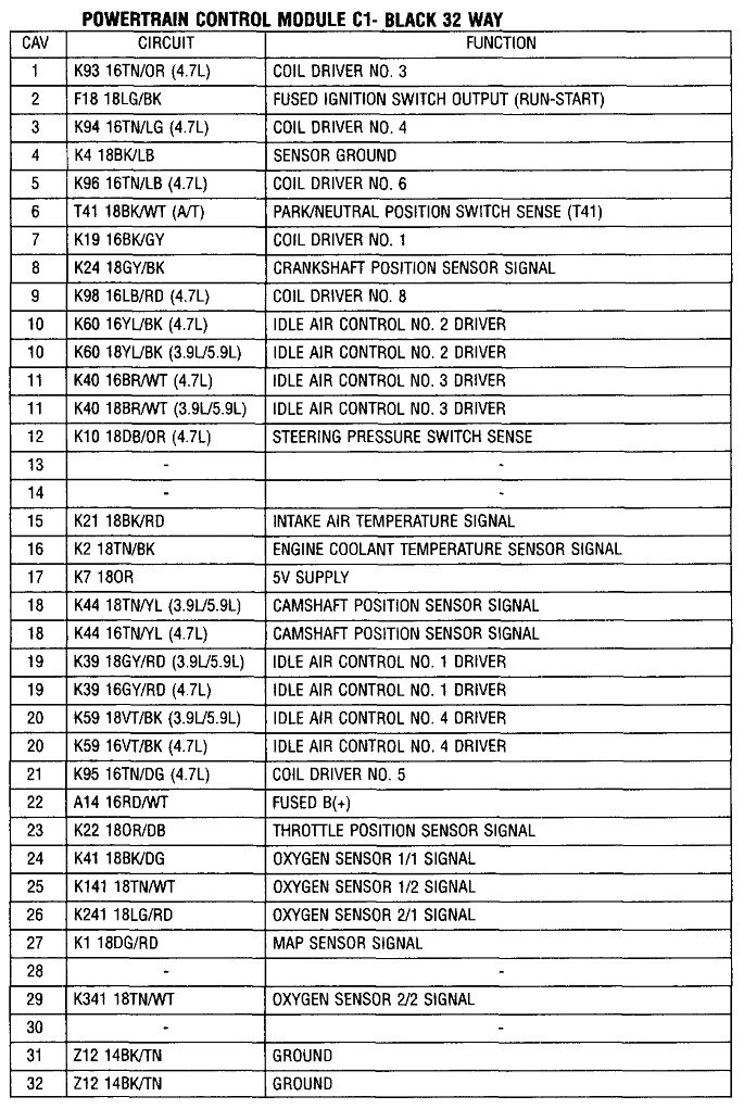

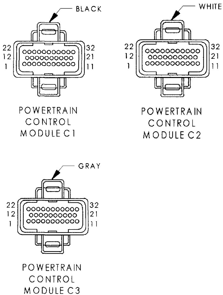

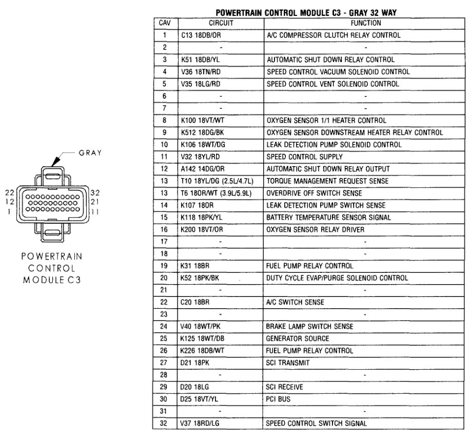

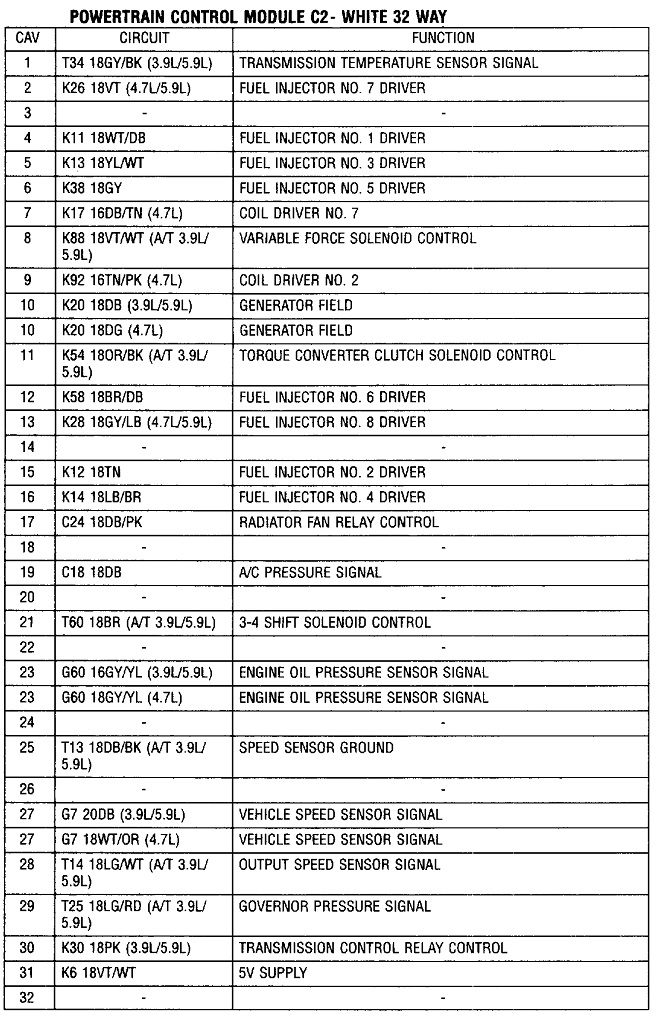

Someone playing around pulled out some of the pin up.
Jun 11, 2022 at 9:11 AM
SQM
Experienced Mechanic
6,383 POSTS
See attached for the pinout.
Let me know of any questions.

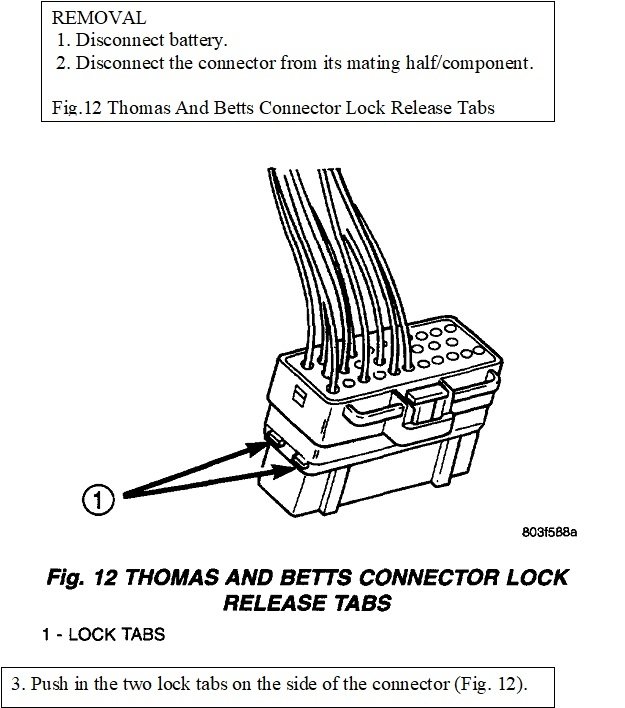

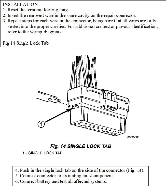

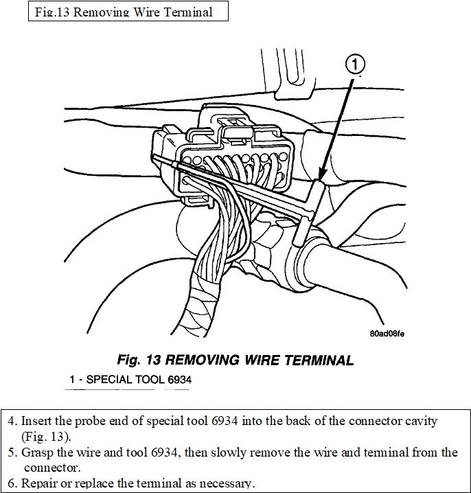

Some of these connectors can be frustrating to take apart, so I included the procedure in the last three drawings.
