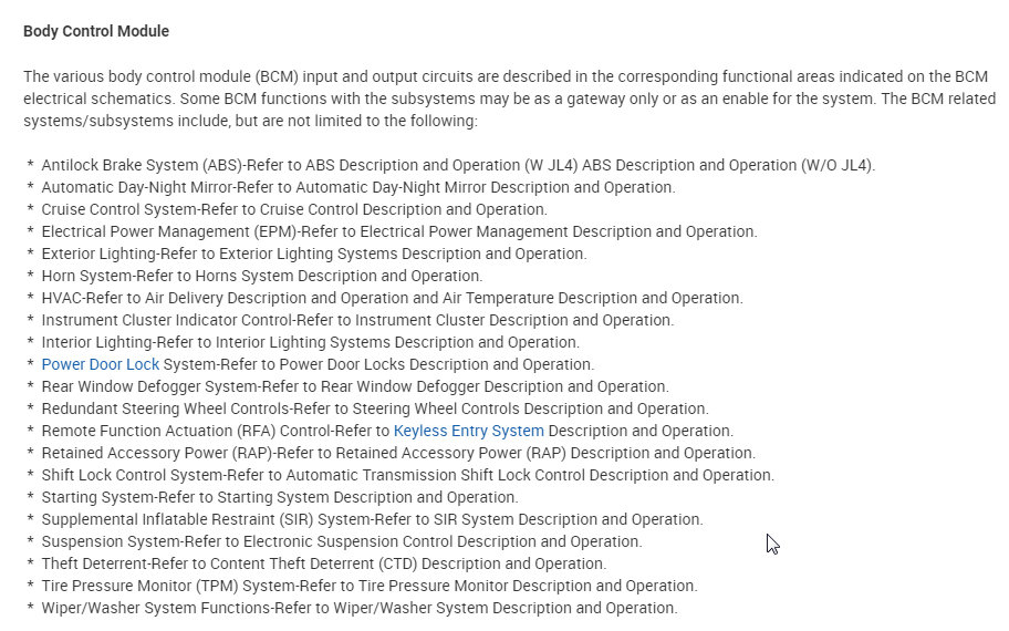

While driving down the highway my instrument cluster needles will go haywire and my door locks will start locking and unlocking on their own. my brake pedal will pulsate and my seat belt light will ding on and off. Sometimes my instrument clusters will just sit at zero even though I'm driving down the highway.
Feb 22, 2020 at 1:20 PM
This sounds like the voltage on the vehicle systems is too low. It is odd that this happens driving down the road but I have seen each of those happen due to low voltage.
If this checks out okay then I would tend to lean towards a body control module issue. It pretty much controls or is associated with each of the issues you are seeing.
Clearly I would want to check for codes first. Hopefully that will point us in the best direction. If you can't pull codes, most parts stores can pull them free of charge.
