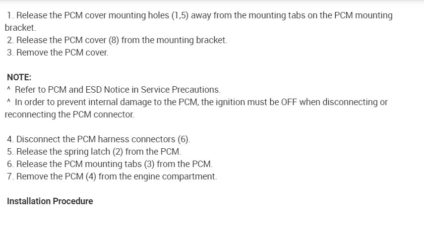

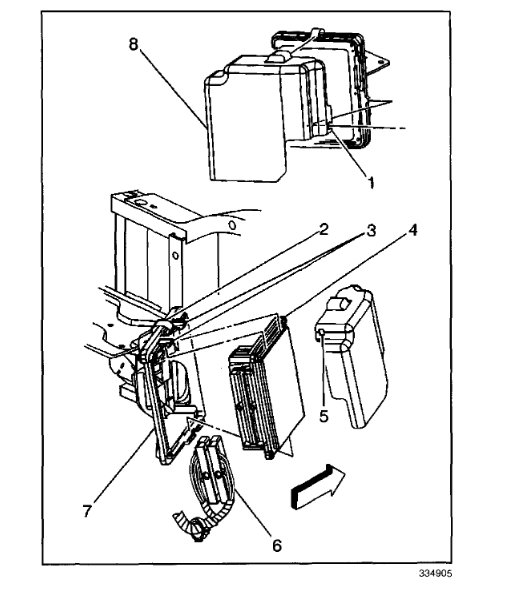

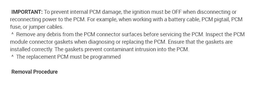

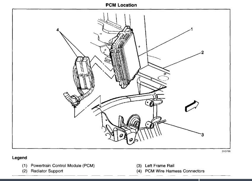

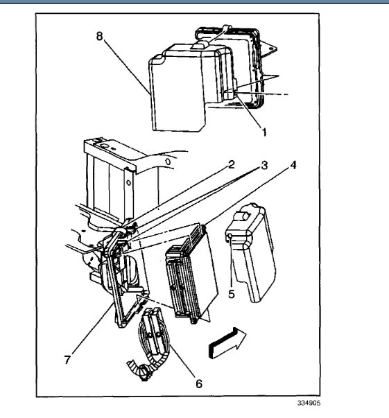

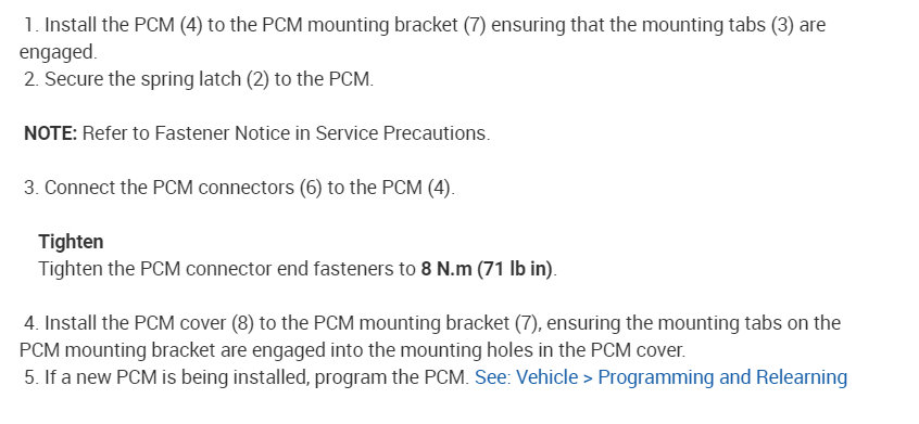

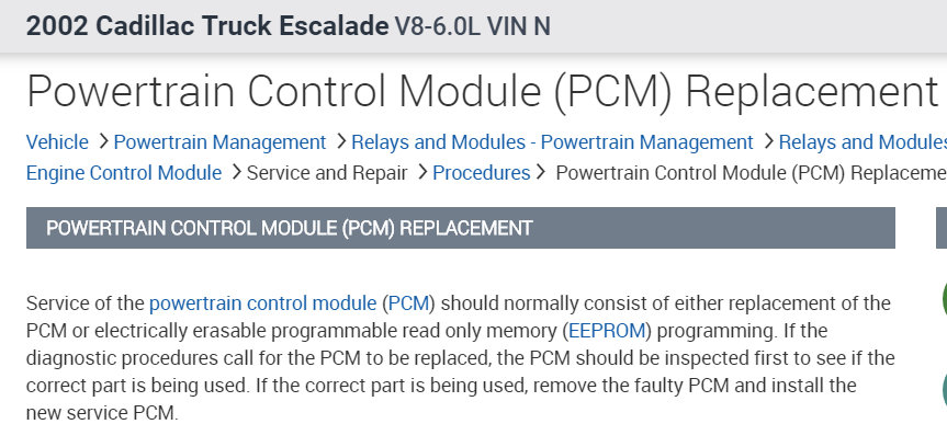

Need location of ECM, PCM computer.
Apr 5, 2019 at 6:49 AM
SCGRANTURISMO
  • 4,897 POSTS
I have included the information that you requested in the diagrams down below as well as removal and installation instructions for the Power-train Control Module (PCM) AKA, "computer" removal and installation. Please get back to us with how it goes, and please feel free to ask any more automotive questions that you may have. It's what we are here for.
