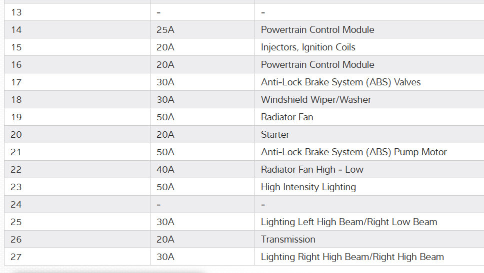

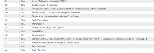

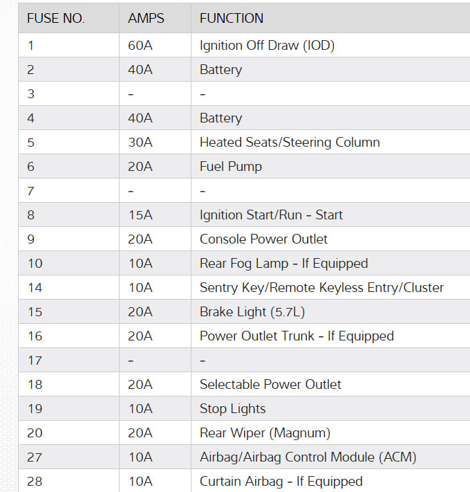

The systems talk to one another so separating to see which one can be difficult. So can you tell me what was broken that you fixed? Do you have a picture?

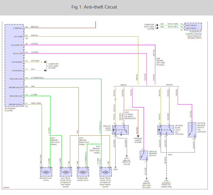

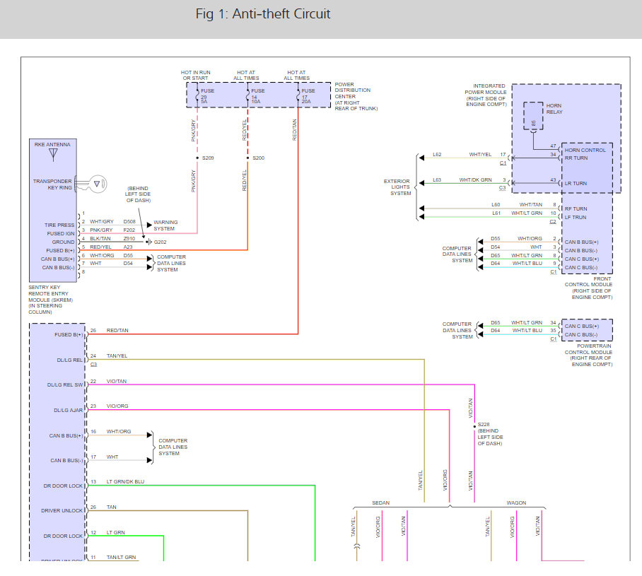

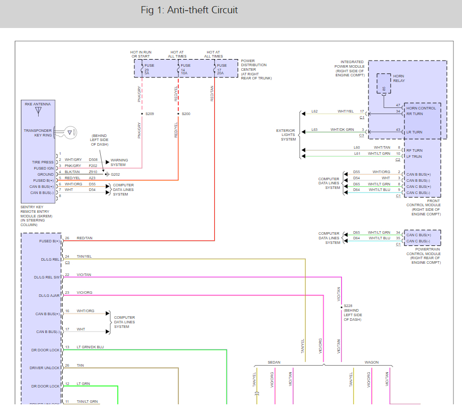

It seems the trouble started when you changed the key pin? Here are the security system wiring diagrams so you can see how the system works.

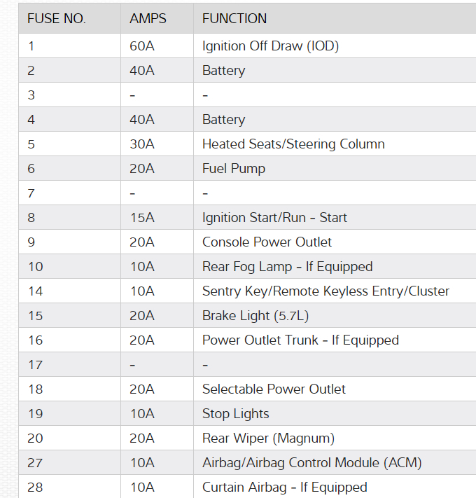

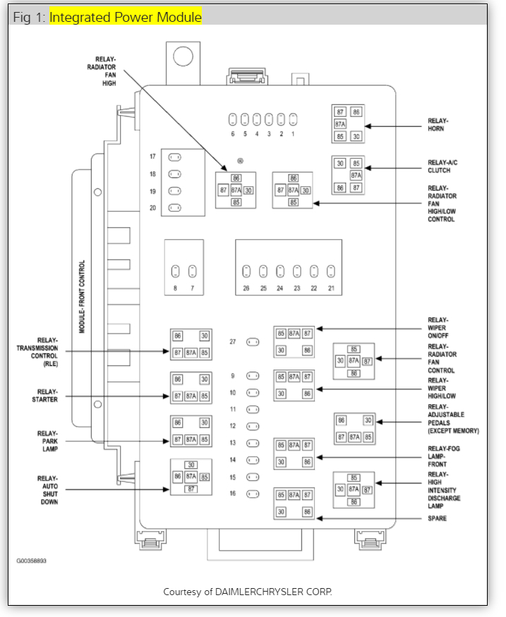

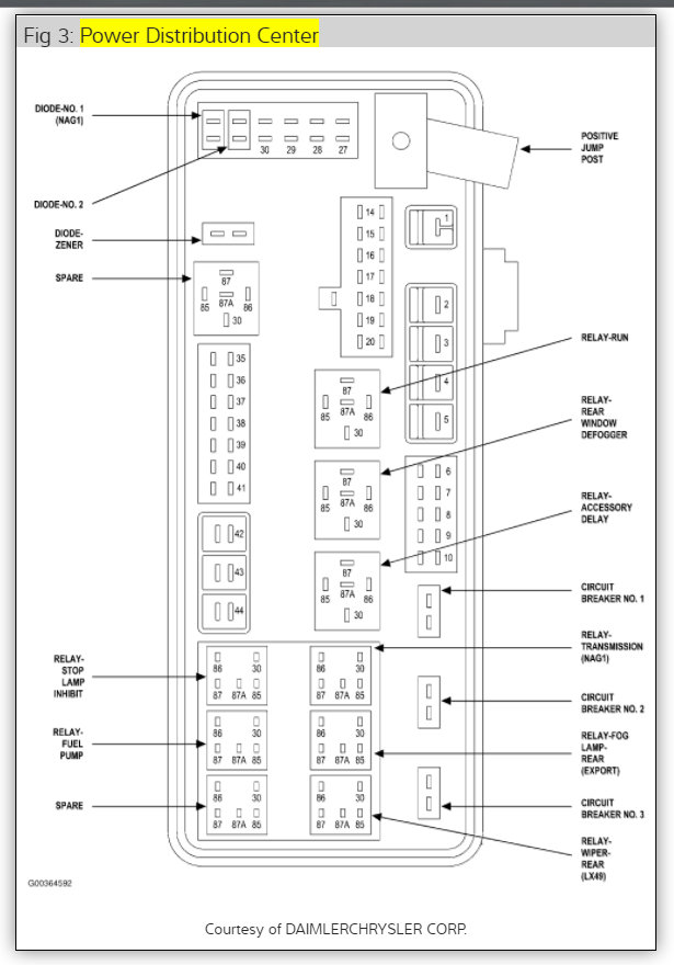

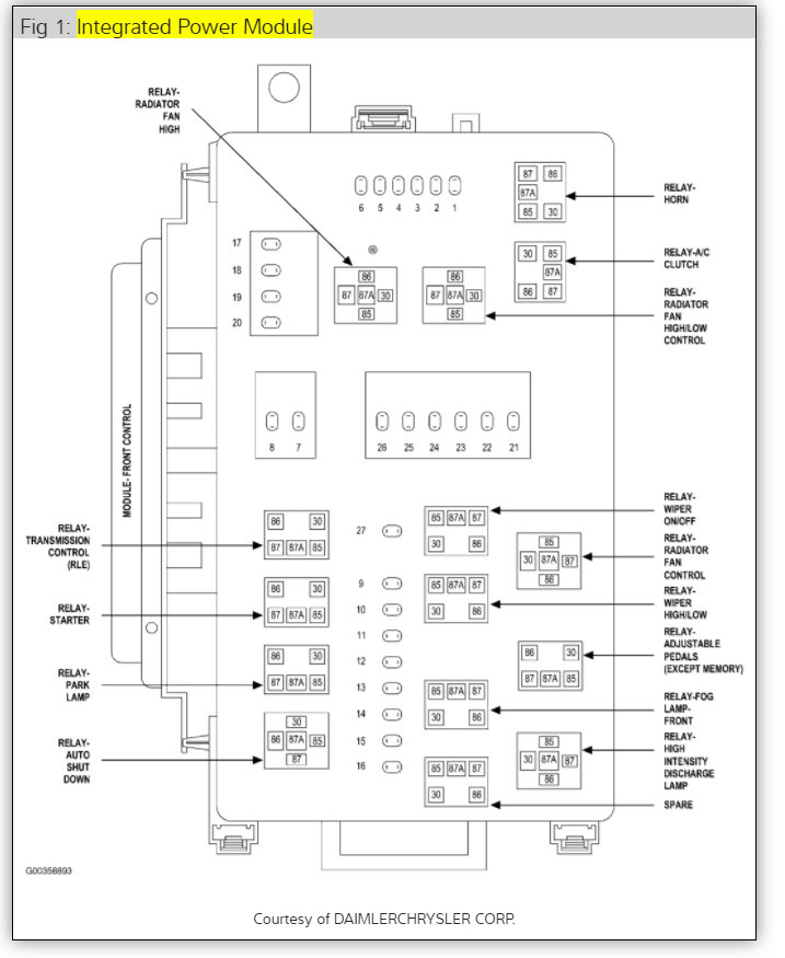

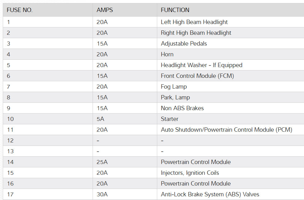

Please check fuse #17, 29 and 14.
