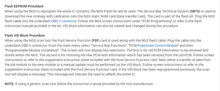

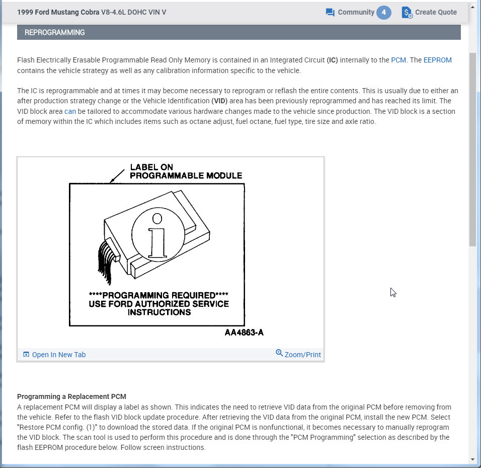

If my computer gone bad for what ever reasons and get another one (computer would I need to program it to the car?
Sep 30, 2020 at 9:57 AM
Experienced Mechanic
18,907 POSTS
I attached the info on how to flash a replacement PCM. Review this and let me know what questions you have. Thanks
