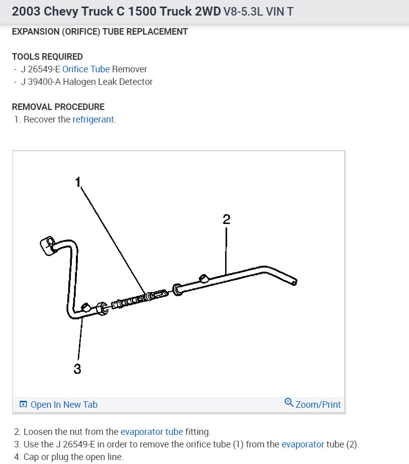

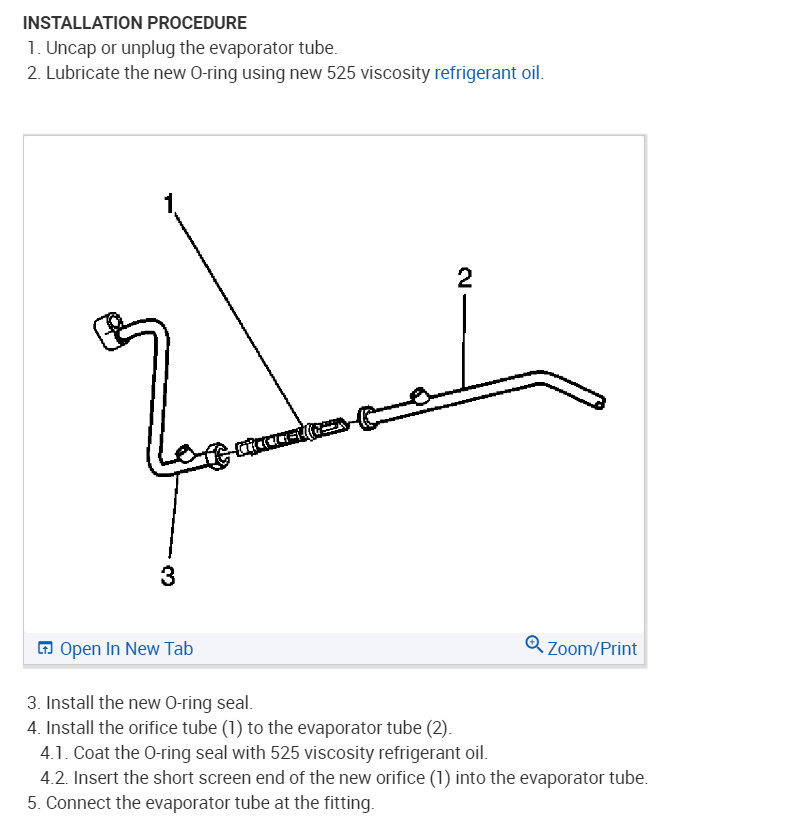

When the low side is high and the high side low it means the compressor is not working. Is it a new compressor, if so which brand? The clutch is engaged, correct? then the pressure should differentiate. Also, when you changed the compressor out were there particles from when the old compressor went bad? If so, you should clean the orifice tube.
This guide can help as well, and there is the orifice tube location in the diagrams below:

Yes, let's also remove the orifice tube to change it condition.

Update: I had a leak fixed but I had jumped the compressor so when I started charging it was leaking out. It burned up the compressor. I confirmed once I checked orifice tube. I took off lines and cleaned got new dryer, condenser, evaporator, compressor. And also got a quality valve for those darn self-sealing cans always had trouble releasing Freon. Got working perfectly.
