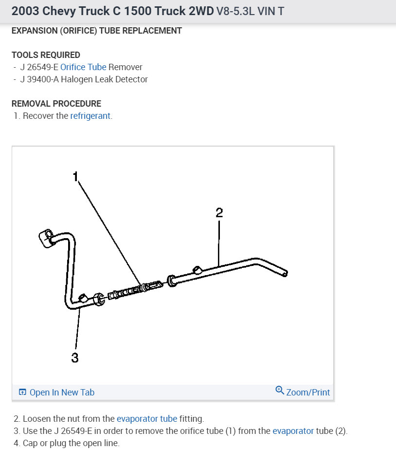

I’m having trouble with the A/C compressor coming on.
I’ve tested low and high side pressure switches and they checked out good.
I can jump compressor at relay, and it comes on, but it has trouble sucking down the Freon then not at all this is while I have compressor jumped at relay and compressor is engaged.
My gauges read low side is high and the high side pressure is low.
It’s a new compressor.
My question is, if pressure switches or okay, why doesn’t compressor continually suck down Freon to get compressor to engage. And if I jump relay why it isn’t sucking down Freon.

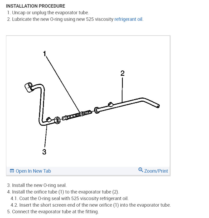

When the low side is high and the high side low it means the compressor is not working. Is it a new compressor, if so which brand? The clutch is engaged, correct? then the pressure should differentiate. Also, when you changed the compressor out were there particles from when the old compressor went bad? If so, you should clean the orifice tube.
This guide can help as well, and there is the orifice tube location in the diagrams below:

Yes, let's also remove the orifice tube to change it condition.

Update: I had a leak fixed but I had jumped the compressor so when I started charging it was leaking out. It burned up the compressor. I confirmed once I checked orifice tube. I took off lines and cleaned got new dryer, condenser, evaporator, compressor. And also got a quality valve for those darn self-sealing cans always had trouble releasing Freon. Got working perfectly.
