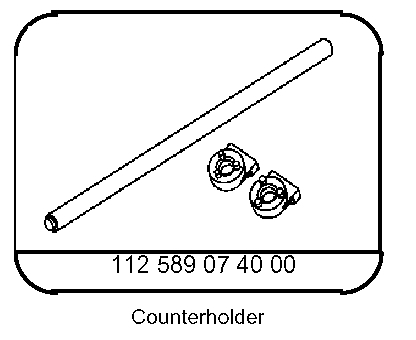

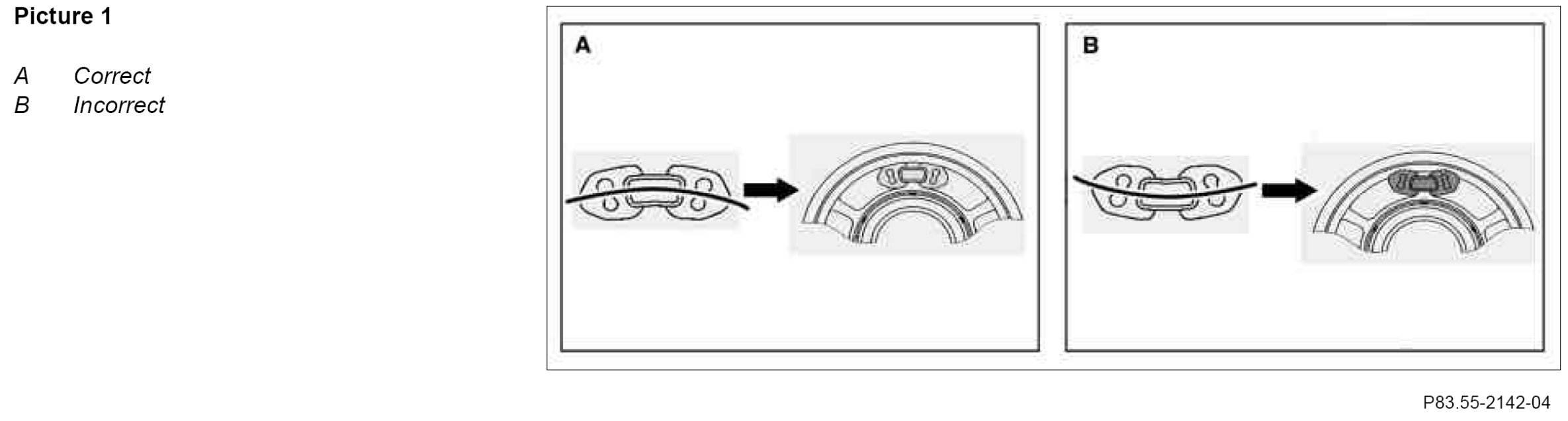

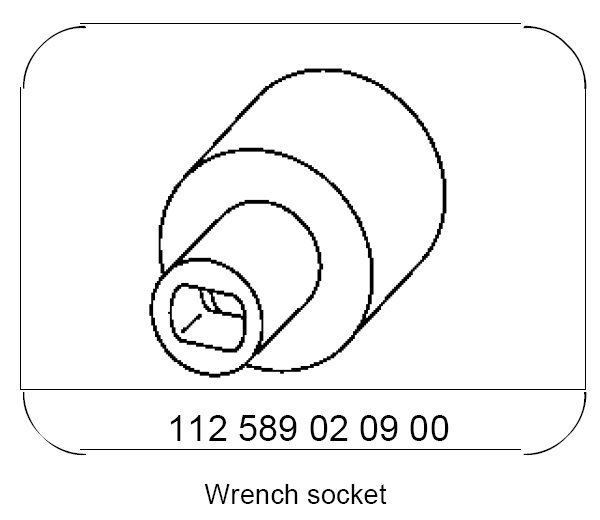

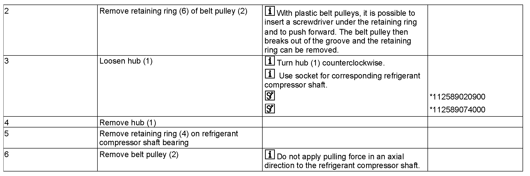

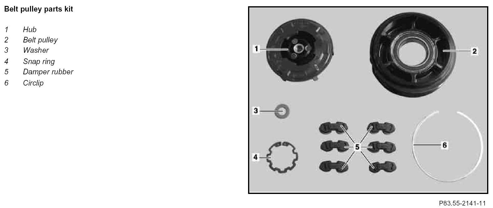

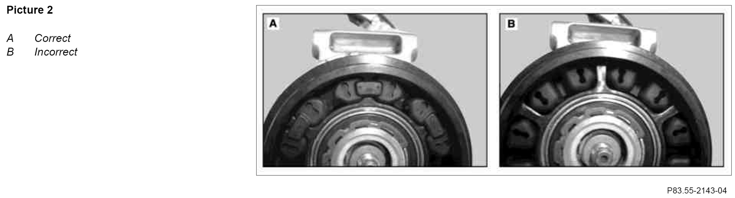

How do I replace the pulley itself and do I have to take out the whole compressor to replace this and if so what do I have to take out just to get to this?
Sep 5, 2019 at 9:37 AM
  • 110,194 POSTS
Welcome to 2CarPros.

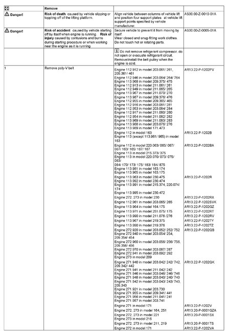

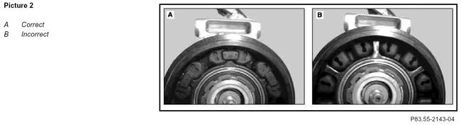

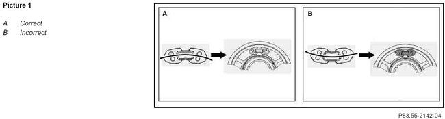

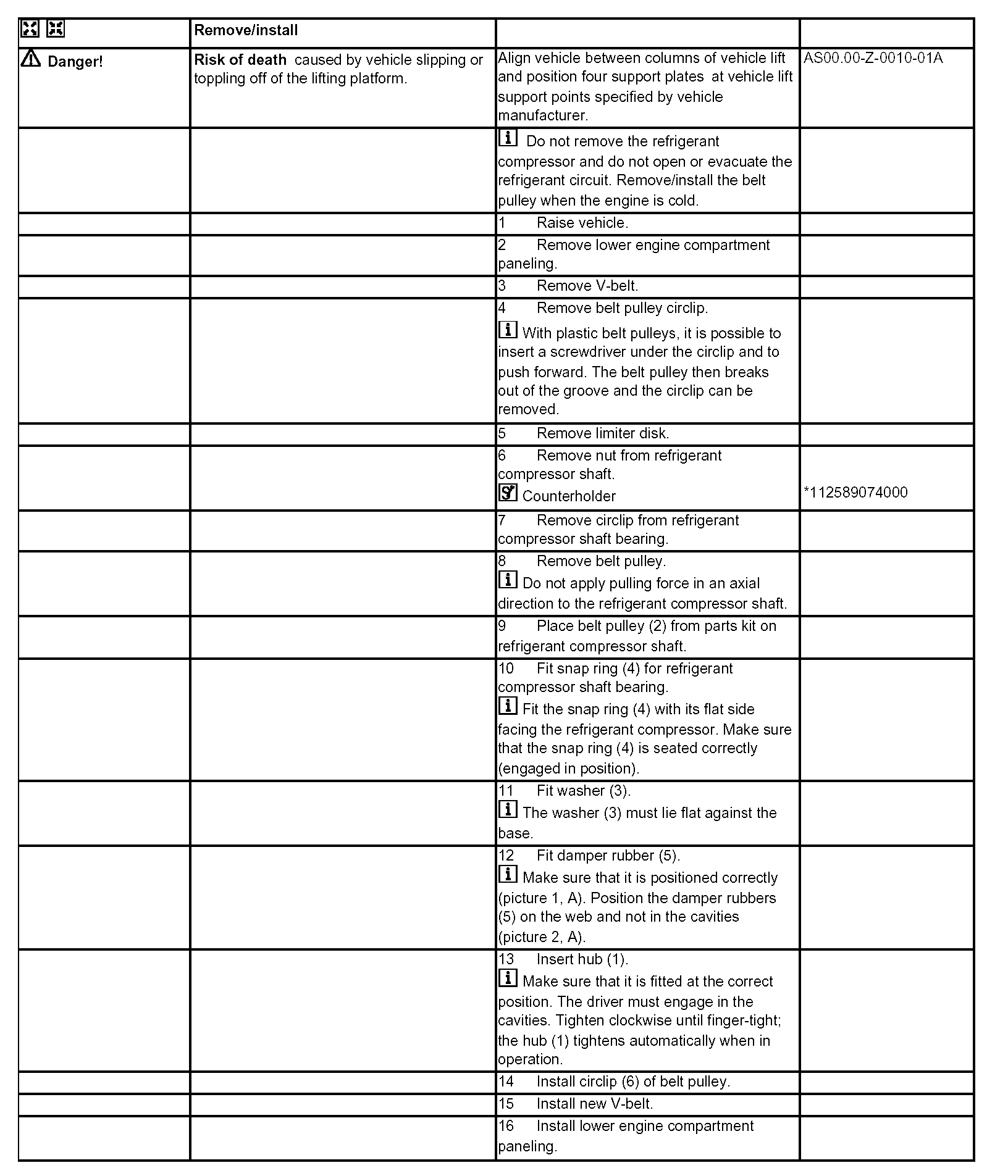

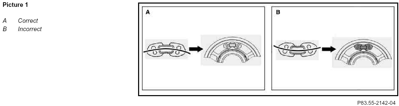

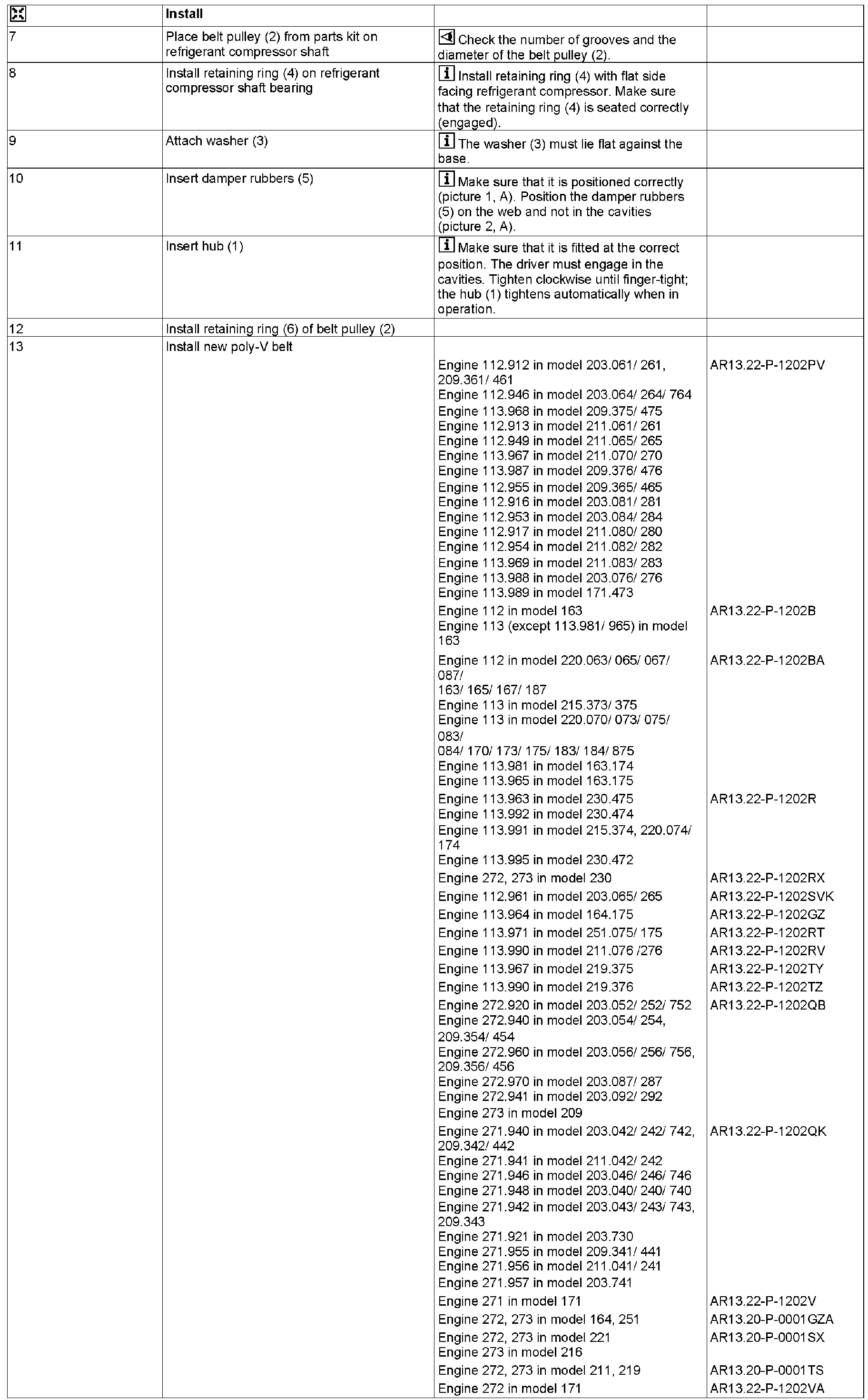

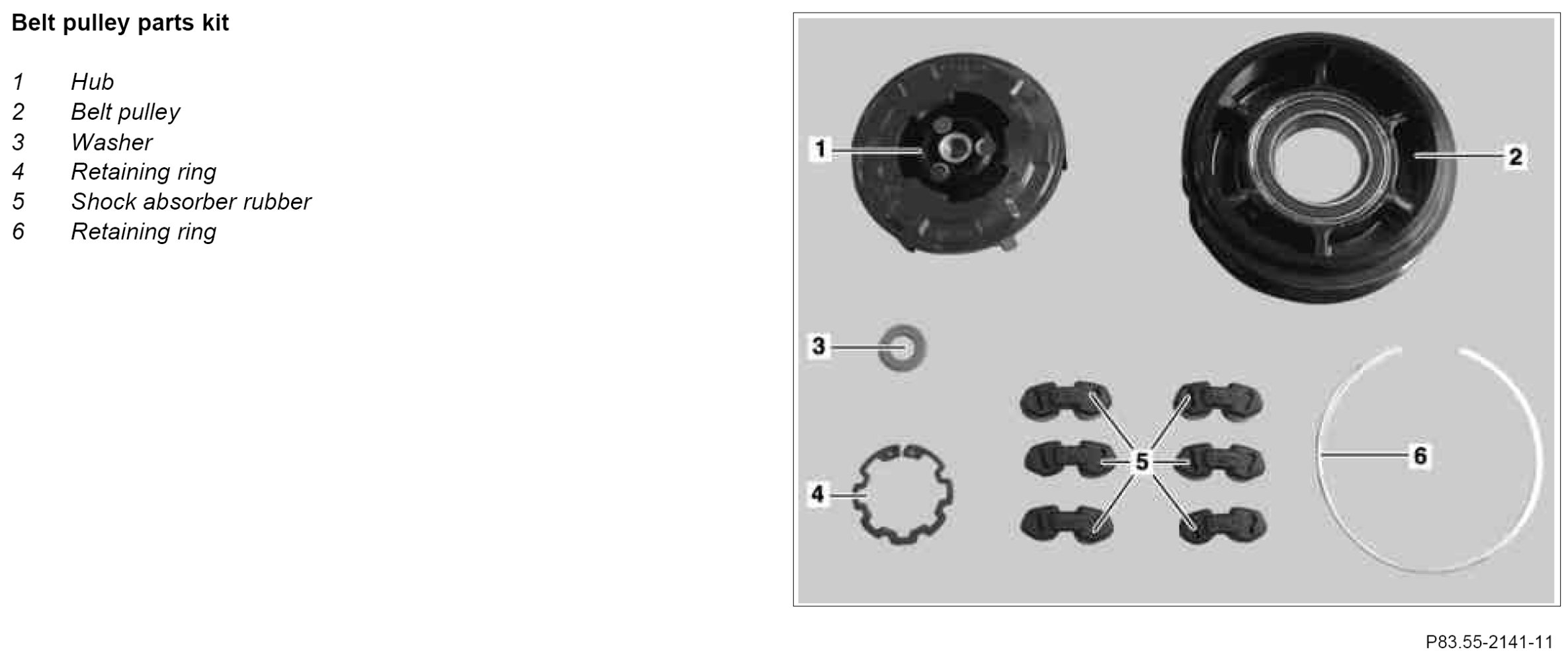

I have to be honest, it isn't a five minute job. You don't have to remove the compressor, but it will be tight to complete.
I attached several pics below. Within the pics are the directions for both removal and replacement of the pulley. They aren't what I would consider specific enough, but this is what they offer us.
_________________________________
2005 Mercedes Benz E 320 Sedan (211.065) V6-3.2L (112.949)
AR83.55-P-7685B Remove/Install Refrigerant Compressor Belt Pulley
Vehicle Heating and Air Conditioning Compressor Pulley Service and Repair Removal and Replacement AR83.55-P-7685B Remove/Install Refrigerant Compressor Belt Pulley
AR83.55-P-7685B REMOVE/INSTALL REFRIGERANT COMPRESSOR BELT PULLEY
AR83.55-P-7685B Remove/install Refrigerant Compressor Belt Pulley
Belt pulley parts kit
Component Identification
Pic 1
pic 2
Pic 3
Step 1
pic 4
Steps 2-6
pic 5
Steps 7-13
pic 6

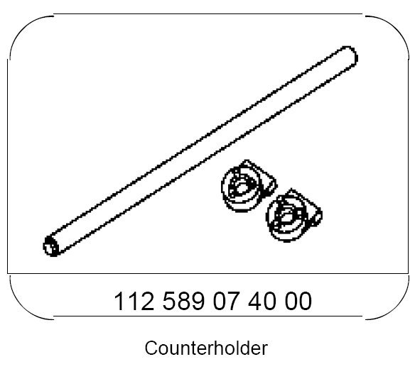

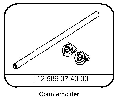

Special Tools
pic 7
Special Tools
pic 8
