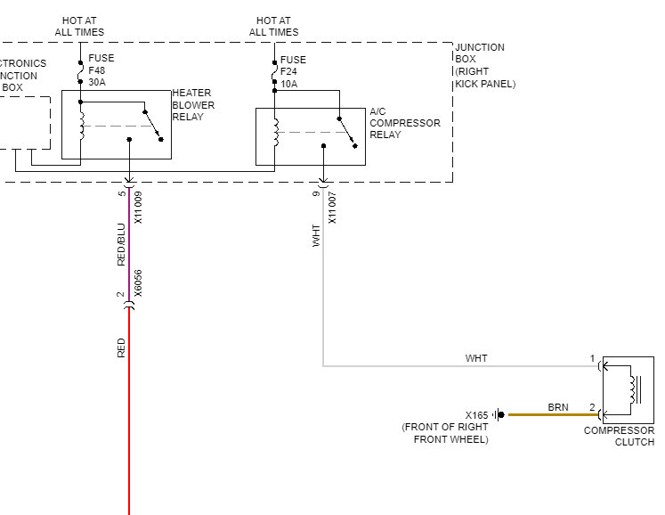

Hi. I bought the car from a family who hadn't used it for a year and had given up on it. After replacing a door and the transmission, I was ready to sell it, but the A/C didn't work. It appeared to have no fluid, so I evacuated it and added a couple of ounces of oil. With one can of 134, I have 75lbs of pressure on both gauges, but the compressor won't kick in. I have spun it very slowly from the clutch with a screwdriver and it seems like it wants to go, but it doesn't. Bad clutch? Bad compressor? Something else that may prevent it from going.

If you can turn the compressor by hand, then the compressor is not seized.
There are many reasons why an A/C compressor clutch will not kick in.
A good article:
https://www.2carpros.com/articles/symptoms-of-a-failing-automotive-ac-compressor-a-comprehensive-guide
Please also check the compressor fuse and clutch engagement by giving the clutch 12V supply. the clutch should be heard clicking in/out.
It is grounded permanently, see image below.
Also check the A/C system for any fault codes by carrying out a CAN-scan using a suitable diagnostic tool.
