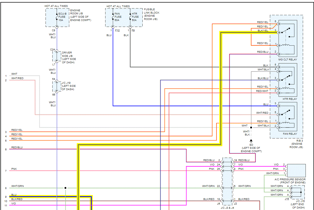

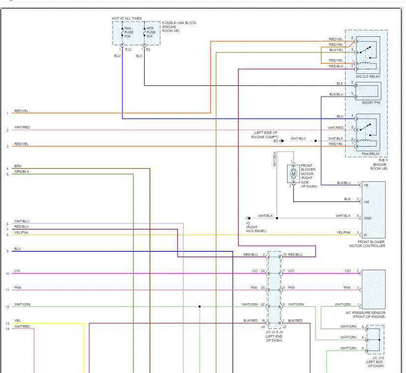

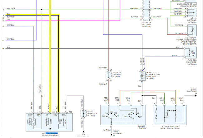

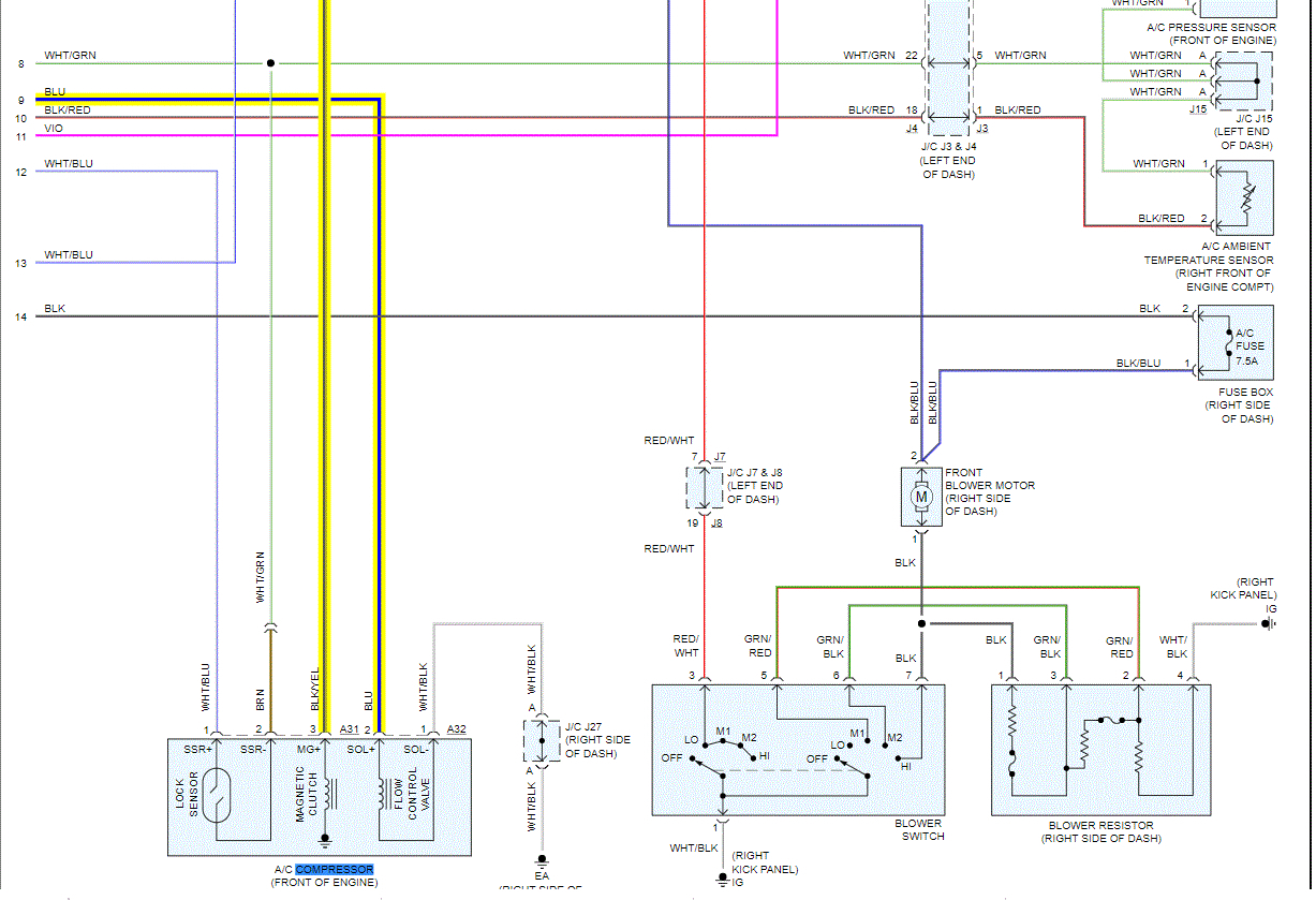

Good evening, the vehicle compressor is not functioning when the A/C switch is on. The blower fan is functioning, the system has enough pressure, when I connected power to the compressor directly from the battery, it function so the problem is not the compressor. Please Could you help me with the A/C circuit diagram?
Dec 21, 2020 at 3:33 AM
  • 110,244 POSTS

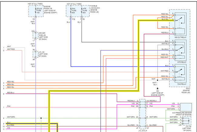

I attached the wiring schematics for the entire HVAC system. I highlighted two wires. One is +voltage to the clutch, which is where I think the problem is. Take a look through the pics.
In my manual, the schematics are two pages long. I cut each in half to make it more readable for you. I did overlap them and keep them in order.
Here is a link that you may find helpful:

Hi, from the diagram, how will I know the input needed by the A/C control assembly to ground the control circuit of the relay?
Is the A/C control assembly same as the A/C control module?
Dec 28, 2020 at 2:57 AM
  • 110,244 POSTS
They are one and the same. As far as checking, I'm not completely understanding what you are asking. If you are referring to the relay itself, it will see 12v. Is that what you mean?

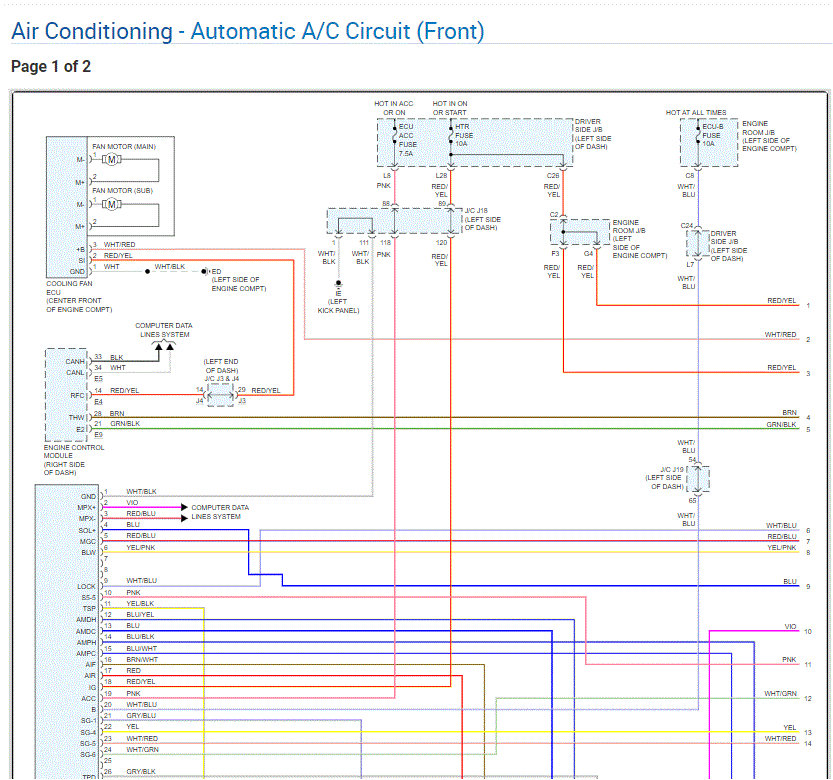

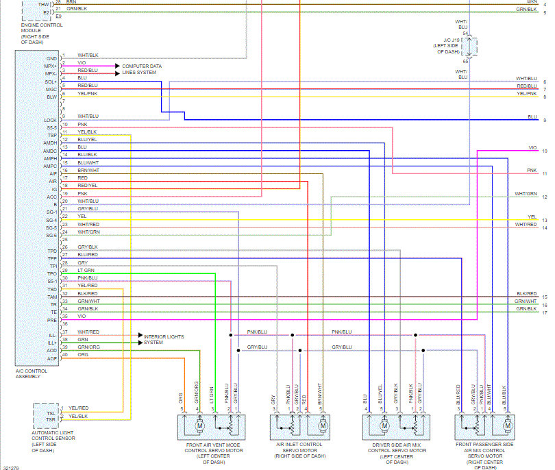

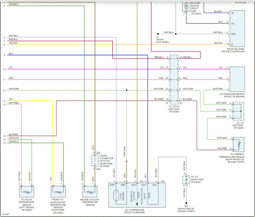

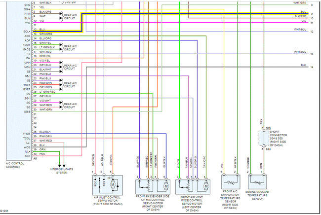

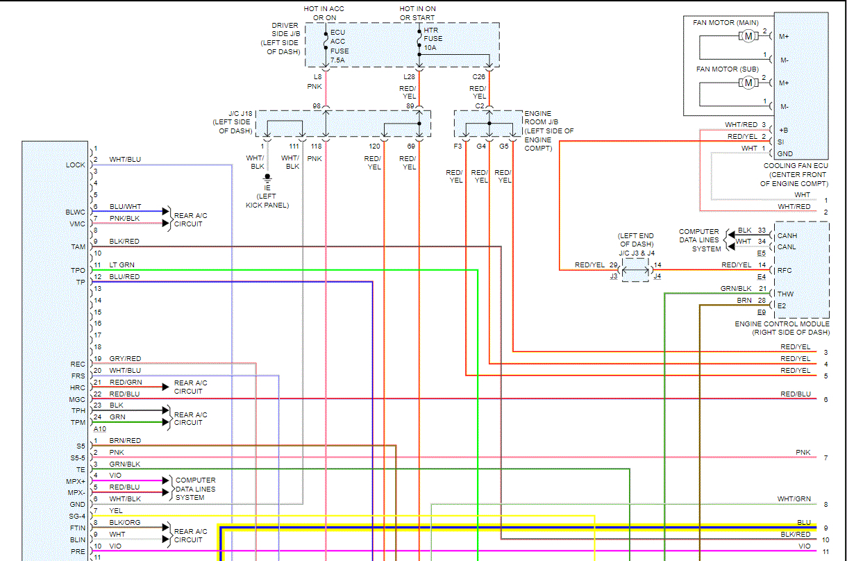

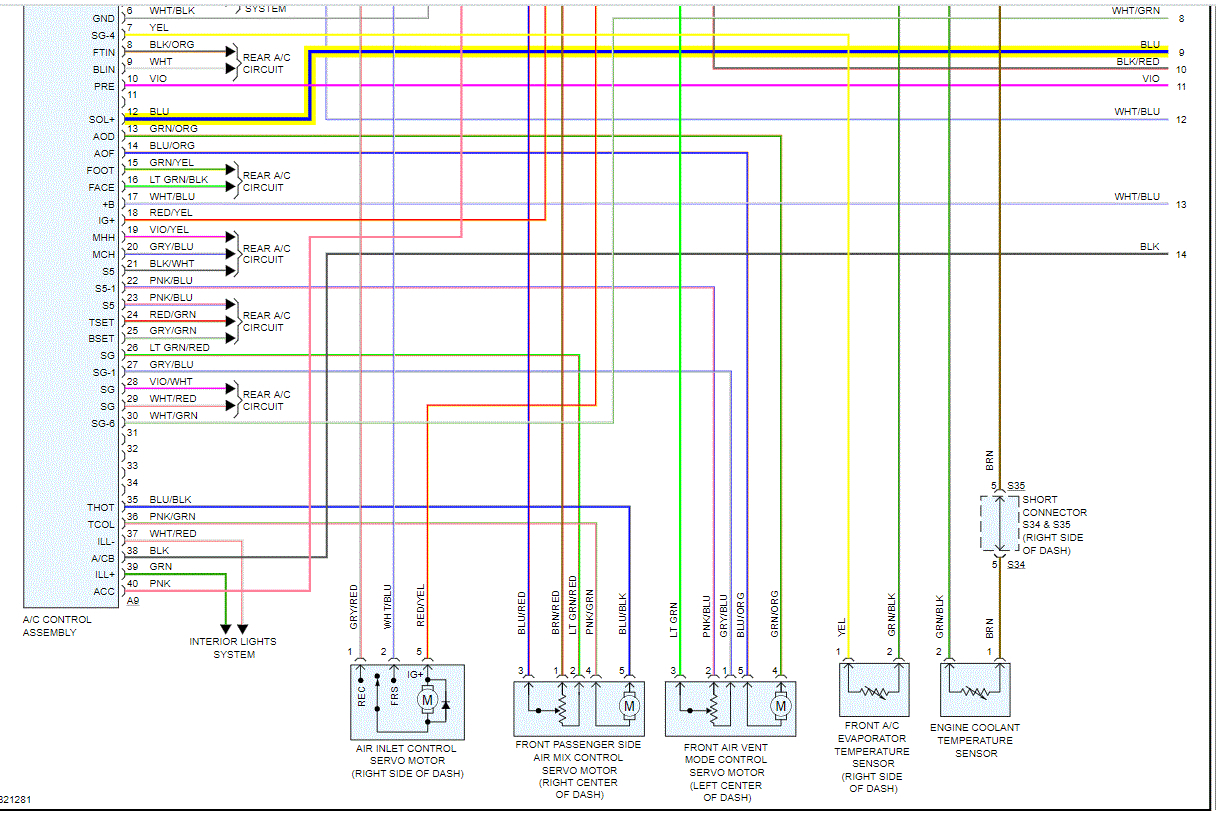

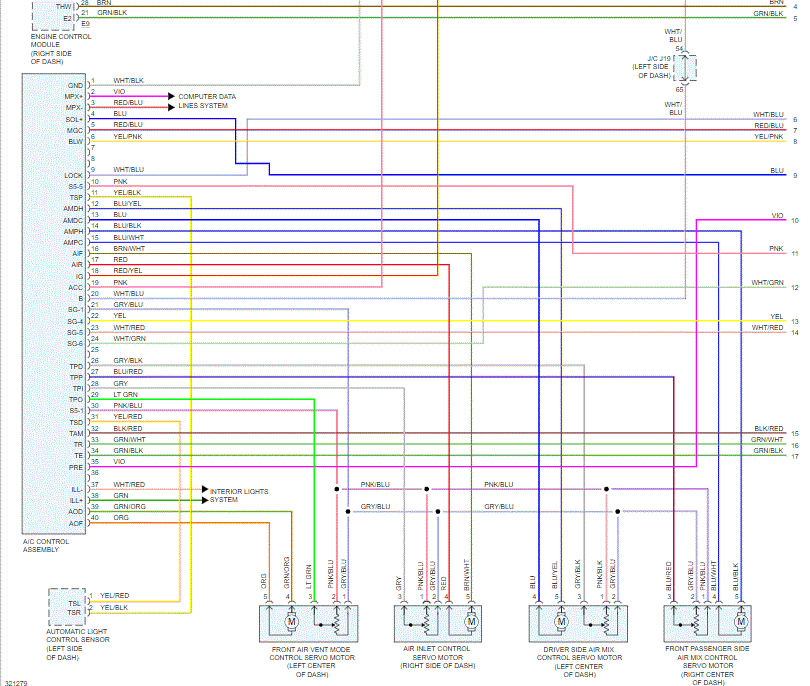

It seems that the A/C control assemble is not completing the circuit, the compressor is not engaging. I wanted to trace the circuit.
Dec 29, 2020 at 12:22 AM
  • 110,244 POSTS
Take a look at the attached pics. They are from the schematic for automatic climate control. I had to cut them in half to make them readable. However, I did overlap them for you to follow.
If you don't have the automatic climate control, let me know.
