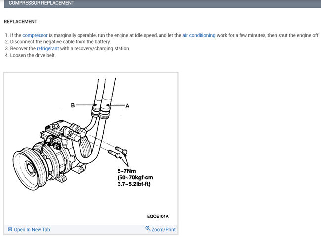

Hi, Fan velocity switch is defective. AC only turns ON if I hold fan switch with fingers. I deduce that with vibrations along the way, on a constant ON-OFF cycles, magnetic coil that engages AC compressor died. I know I need a new fan switch, and a new magnetic coil to compressor.
My questions are:

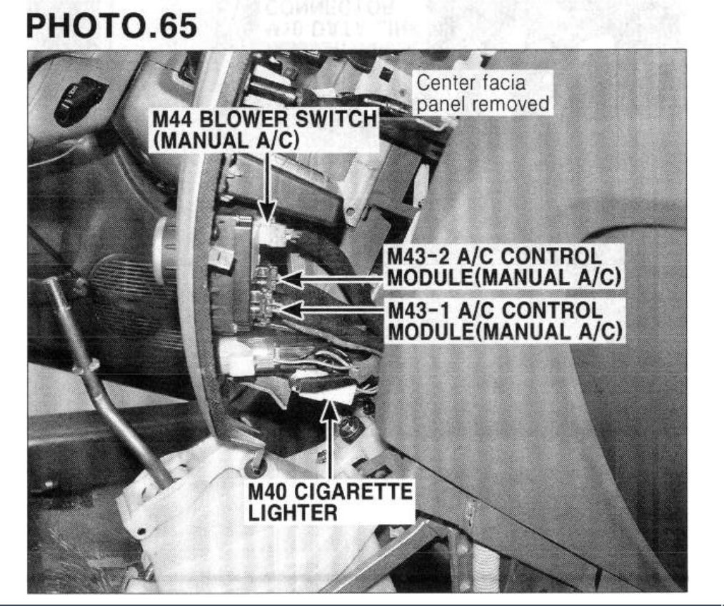

-How do reach fan switch? Can´t find on manuals how to remove center fascia...
Do I have to do the same steps as remove dashboard?
-Is it easy to pull out magnetic coil by hand?
Manual says it may be needed a "puller". But there's no space to use a puller without dismantling AC compressor.
So by hand and with a puller will be the difference between collecting gas, install new dryer, removing AC compressor, recharge gas, etc...
Will be the difference between replacing magnetic coil at home by me, or send the Starex to an auto shop.
Can you help me with some tips? Thanks in advance!

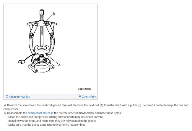

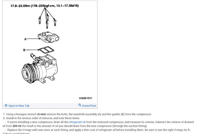

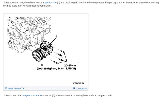

Here is how to change the switch out and it does not look like the compressor is not serviceable because they are telling us to replace the compressor. here is a guide to help walk you through the procedure and diagrams below to show you how on your car:
https://www.2carpros.com/articles/replace-air-conditioner-compressor

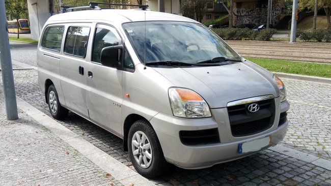

Pictures seems to be to a modern model than my H1/Starex. I know this model had different designations on different countries.
I'm going to upload a picture of my H1.
This model was released here (Portugal) at the end of 2005, up to 2007, maybe 2008.
It has diesel engine 2.5 CRDI 140hp/103Kw.

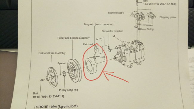

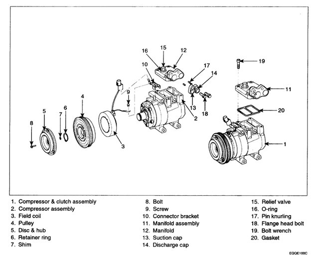

AC compressor part scheme.

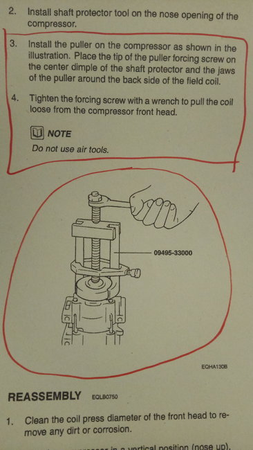

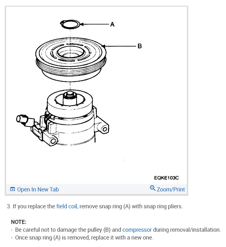

Puller to remove magnetic coil (scheme), no space to puller between AC compressor and radiator.

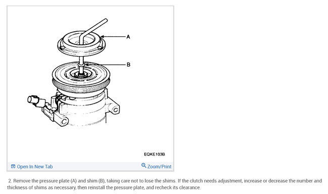

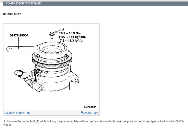

Yep, I had to improvise because we don't have that in our country. Here is how you change the clutch out. Can you please shoot a quick video with your phone so we can see what's going on? that would be great. You can upload it here with your response. Check out the diagrams (below). Please let us know what happens.
