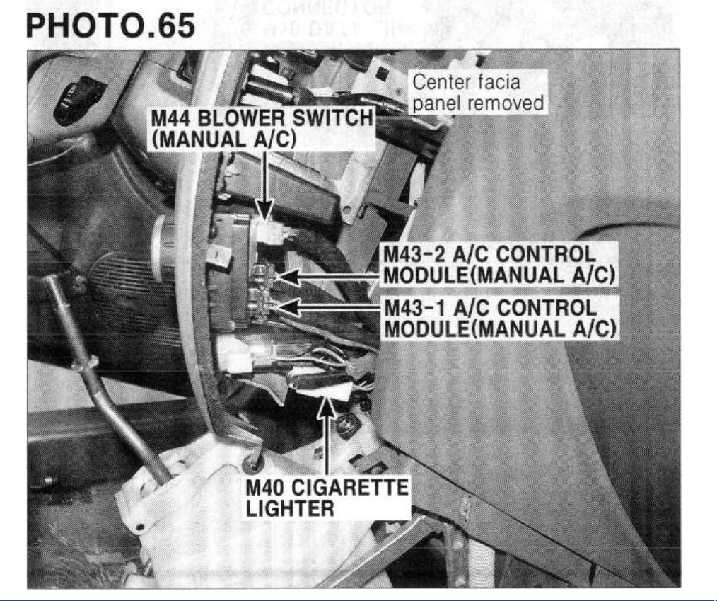

Hi, Fan velocity switch is defective. AC only turns ON if I hold fan switch with fingers. I deduce that with vibrations along the way, on a constant ON-OFF cycles, magnetic coil that engages AC compressor died. I know I need a new fan switch, and a new magnetic coil to compressor.
My questions are:
-How do reach fan switch? Can´t find on manuals how to remove center fascia...
Do I have to do the same steps as remove dashboard?

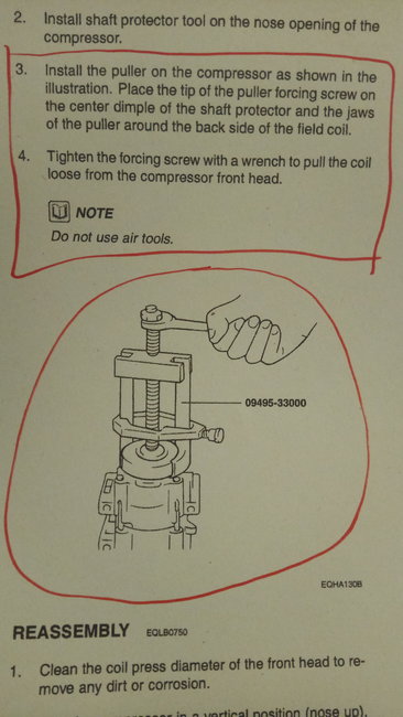

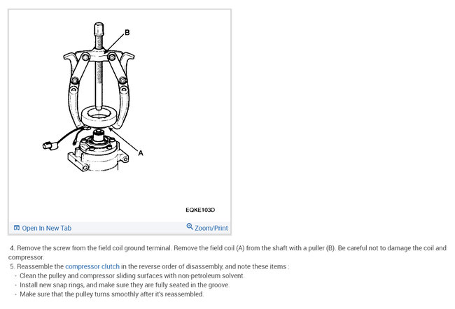

-Is it easy to pull out magnetic coil by hand?
Manual says it may be needed a "puller". But there's no space to use a puller without dismantling AC compressor.

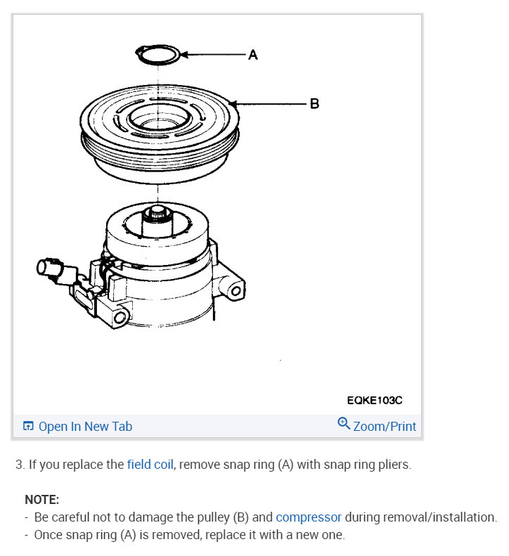

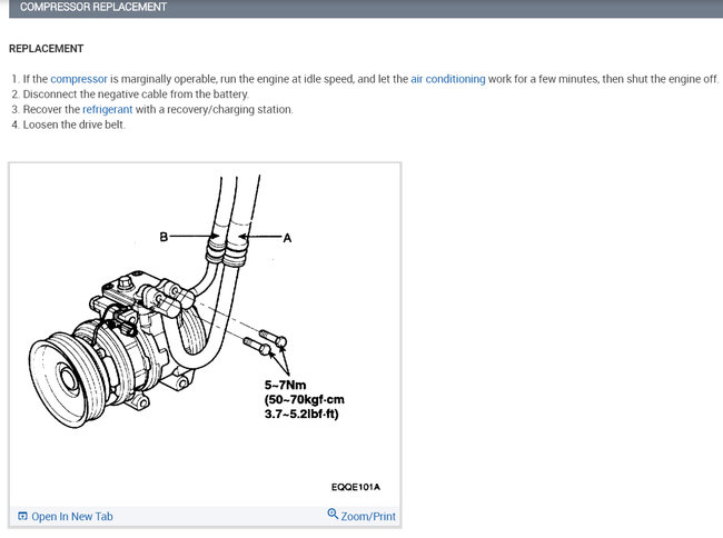

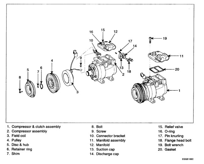

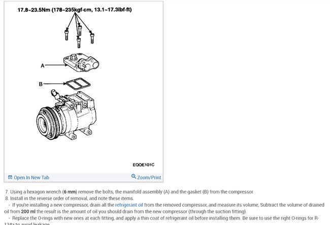

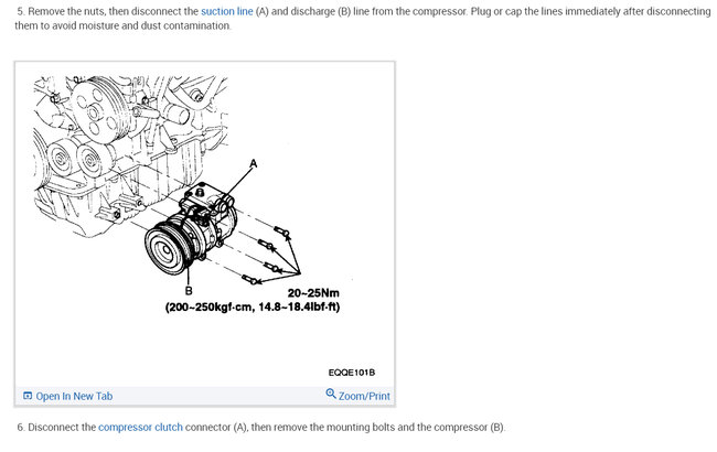

Here is how to change the switch out and it does not look like the compressor is not serviceable because they are telling us to replace the compressor. here is a guide to help walk you through the procedure and diagrams below to show you how on your car:
https://www.2carpros.com/articles/replace-air-conditioner-compressor

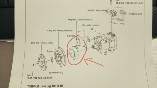

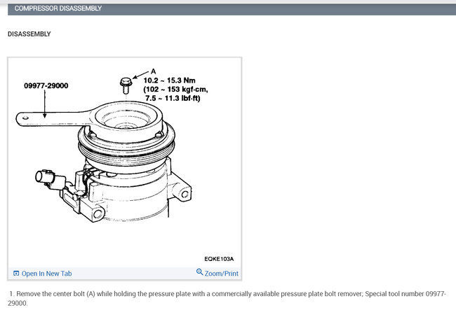

AC compressor part scheme.
Oct 22, 2019 at 8:27 AM

Puller to remove magnetic coil (scheme), no space to puller between AC compressor and radiator.

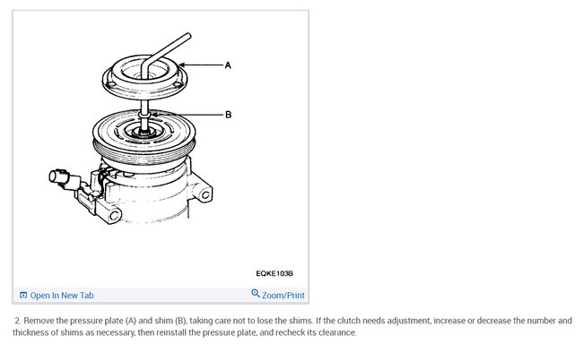

Yep, I had to improvise because we don't have that in our country. Here is how you change the clutch out. Can you please shoot a quick video with your phone so we can see what's going on? that would be great. You can upload it here with your response. Check out the diagrams (below). Please let us know what happens.

It was much more difficult replace fan switch.
