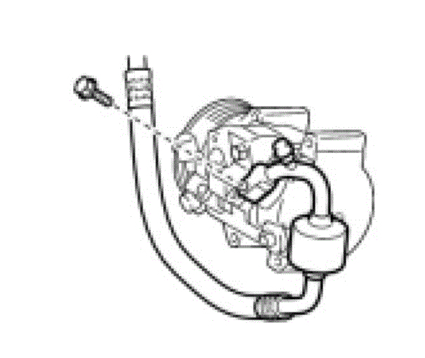

31. Disconnect no. 1 cooler refrigerant discharge hose
Remove the bolt and disconnect the No. 1 cooler refrigerant discharge hose from the compressor and pulley.
Remove the O-ring from the No. 1 cooler refrigerant discharge hose.
NOTICE:
Seal the openings of the disconnected parts using vinyl tape to prevent entry of moisture and foreign matter.

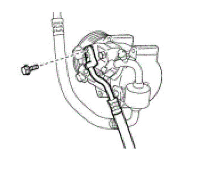

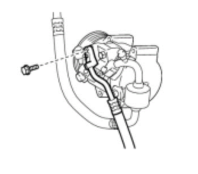

32. DISCONNECT NO. 1 COOLER REFRIGERANT SUCTION HOSE
Remove the bolt and disconnect the No. 1 cooler refrigerant suction hose from the compressor and pulley.
Remove the O-ring from the No. 1 cooler refrigerant suction hose.

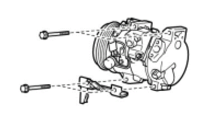

33. REMOVE COMPRESSOR AND MAGNETIC CLUTCH
Disconnect the magnetic clutch connector.
Remove the 4 bolts.
Remove the compressor and magnetic clutch.
