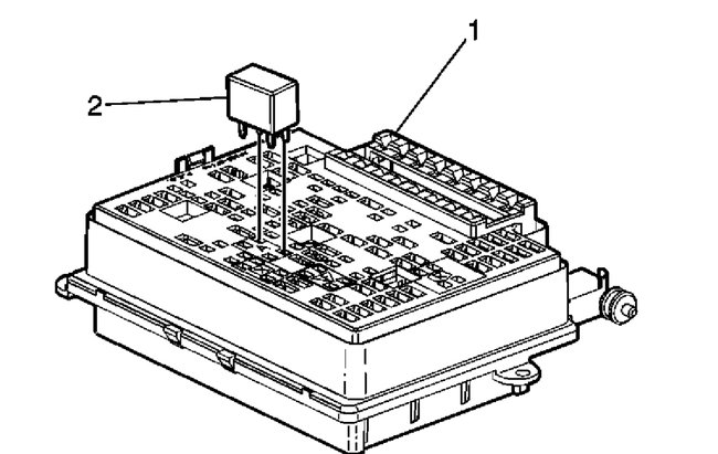

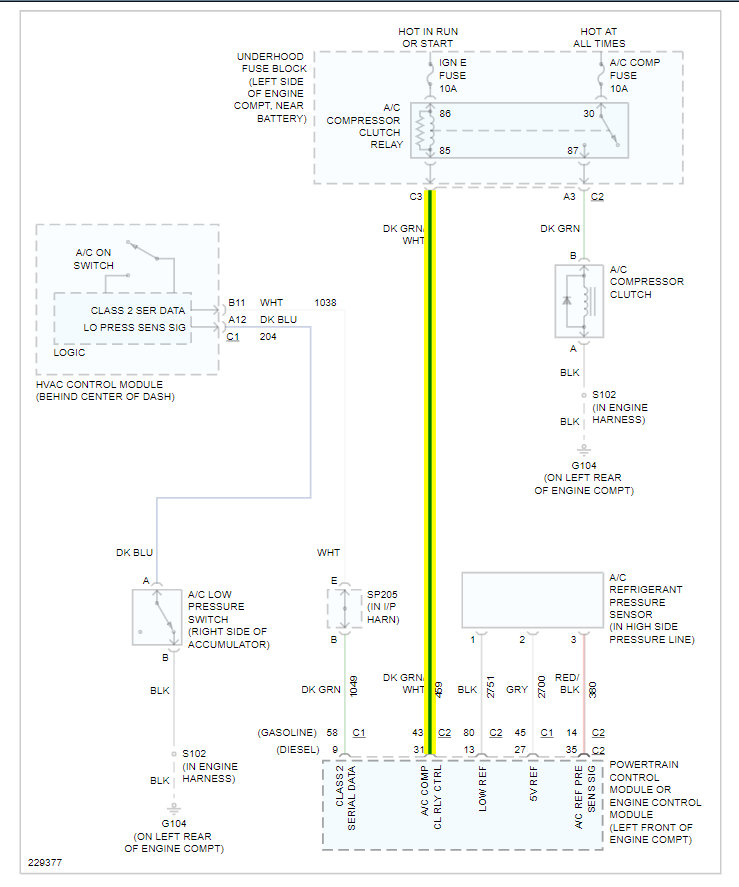

Truck listed above is a 2500 .Changed compressor, dryer, condenser, pulled vacuum, filled with Freon. Compressor won’t com on unless jumped at relay. Changed fuse block. Checked fuses. Need the article on how to check voltage on pressure switch and command to relay. Have 3 pin high pressure switch and 2 pin cycling switch. Took it to Knick car they said it had Freon. They used recover device, emptied, pulled down add Freon and couldn’t figure out. Can I check at pin 85 to see if PCM is signaling to ground. Fred

I attached the wiring diagram for you of the system.
Go to the relay and remove it. There should be 2 pins with voltage with the key on. You need to verify that.
The pressure switch should have 2 5 volt feeds and a ground.

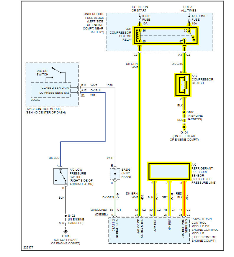

Okay. Here are a number of guides that will help with this:
The way to test the relay is getting grounded is to remove the relay and put your red meter lead on battery positive (or terminal 86) and the black lead on pin 85 and then start the engine and turn the A/C on. You meter should read 12 volts. This shows that the PCM is grounding the relay and is functioning properly.
Please run through this and let me know what you find. Thanks
