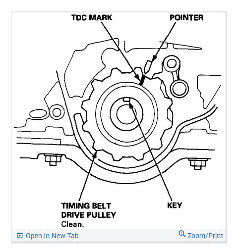

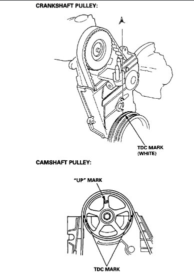

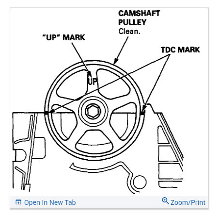

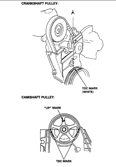

Yes, it just started running rough. I have pulled the valve cover off,the upper timing cover, alternator, power steering, and A/C belts. removed harmonic balancer, all that to check if the timing marks lining up. No engine noise and still cranks and runs on the 2 cylinders. Just no power and of course runs like crap. All valves appear to be opening and closing.

I attached the timing marks below that I have to confirm that is what you are seeing. If it is and you see the valves opening and closing, the head will have to come off.
