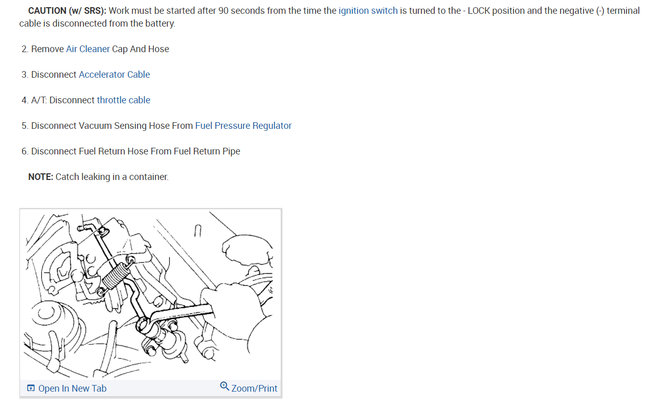

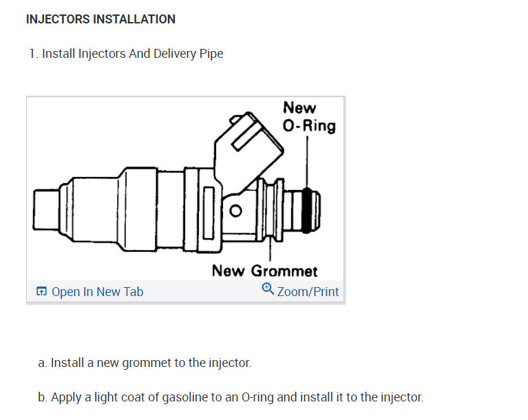

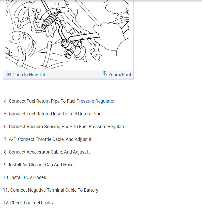

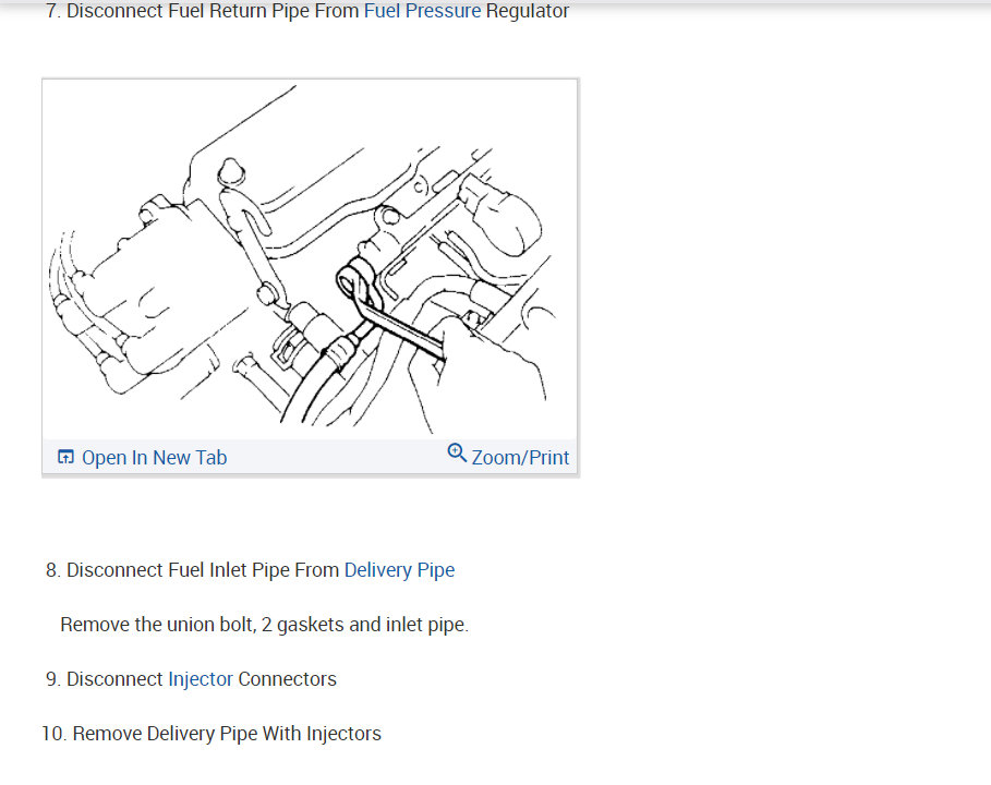

Good morning,
The compression is good. 20 pounds difference on one cylinder is not bad at all.
The cooling system should run about 1/4 of the way on the gauge. From your post, that is what you stated and that is good.

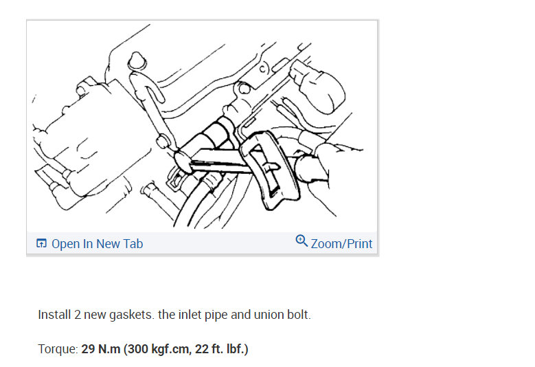

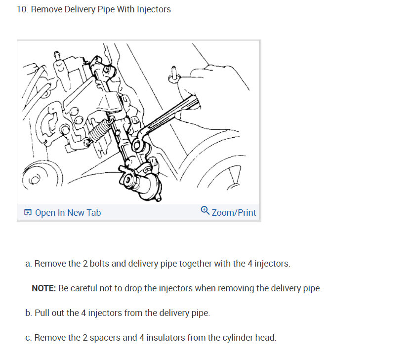

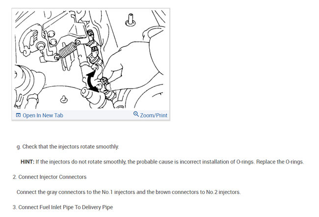

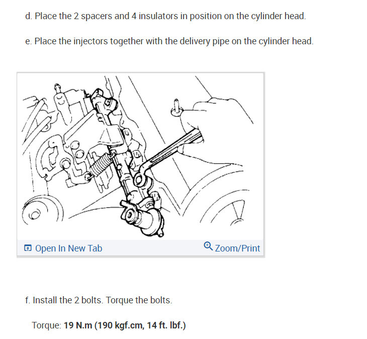

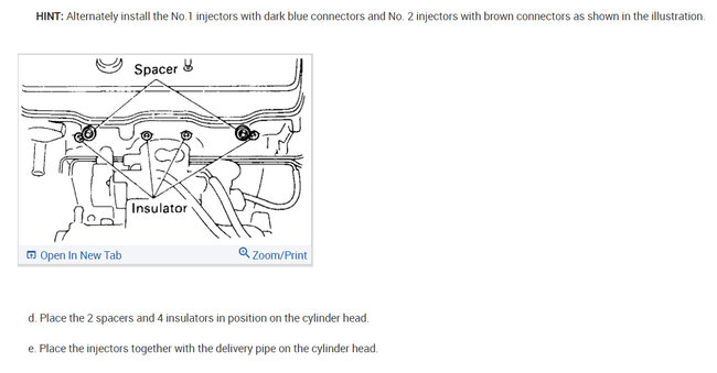

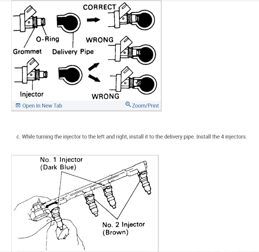

I would have the injectors checked. You may have dirty or bad fuel injectors causing the misfire issue.
https://www.2carpros.com/articles/how-to-test-a-fuel-injector
