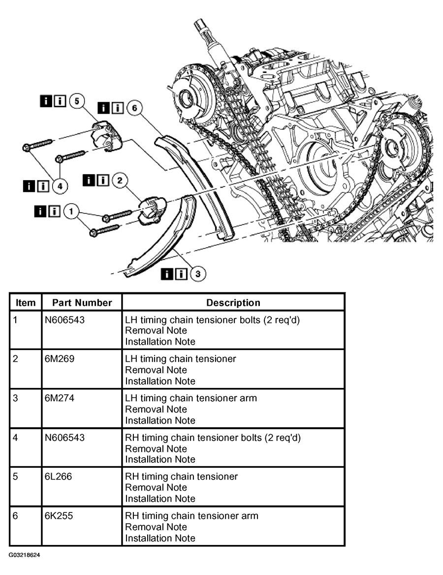

First, if all four of the cylinders with no compression are on the same side, I suspect you may have broken one of the two timing chains in the engine. It is not common for this to happen, but it has. Now, if that is the case, the worse news is that this is an interference engine. Basically, that means there is no room between the pistons and valves if timing is wrong. If one of the chains has broken, chances are there are several bent valves which usually means the head needs replaced at minimum.

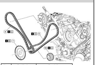

I have attached a picture for you to see how the timing chains run. You will see there are two, one for each side.
If you have other questions, let me know. However, if there is "no" compression (0), valves are stuck open or there is a hole at the top of all four pistons.

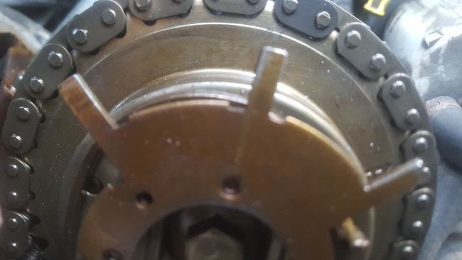

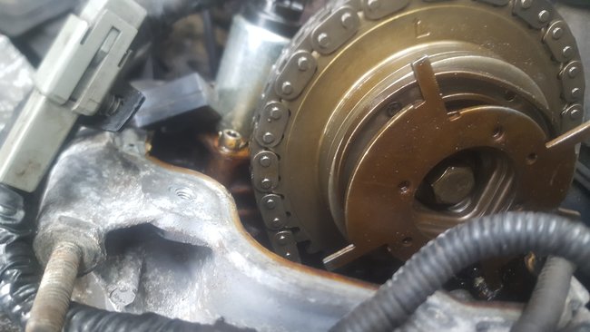

So today I checked the timing chain guides they are unable worn but I noticed the cam phaser gear I off the mark. I am sending a picture so you can see.
Jul 16, 2018 at 4:07 PM
STEVE W.
  • 15,345 POSTS
From the way that chain is setting on the left side of the sprocket I would say it has jumped time. The guides may be fine but the tensioner may be failing and let the chain move.
Only way to know for sure is to pull the front cover and set the chains in time and see if you get the compression back. I would also use a leak down tester on each cylinder to test for valve damage (likely) by gently rotating the crank and watching for the valves to close, then test. No reason to remove and install the new chains and parts only to discover that you need to pull the heads off to repair the valves.

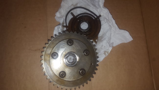

Did a leak down test did go well air was escaping like it was over lashing. So I took the phaser off and it fell apart in my hand. All pins were broken but before I took it off I set the timing at TDC no1 piston all the way up and the timing lined up.
Jul 22, 2018 at 5:02 AM
THOME9950
  • 6 POSTS

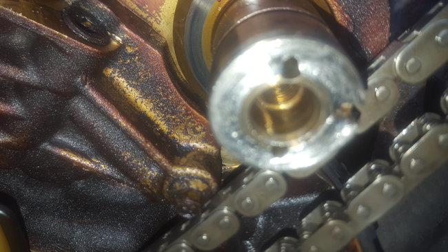

And the end of the cam got damage also.
Jul 22, 2018 at 5:29 AM
STEVE W.
  • 15,345 POSTS
Looks like it started to get loose and tore things up. Not a big fan of that design or VVT in general as it seems to cause as many problems as it solves. The engineering is getting more complicated by the day.
