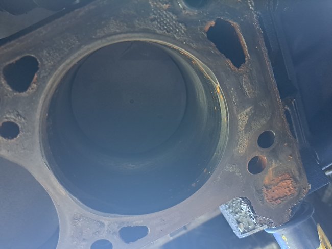

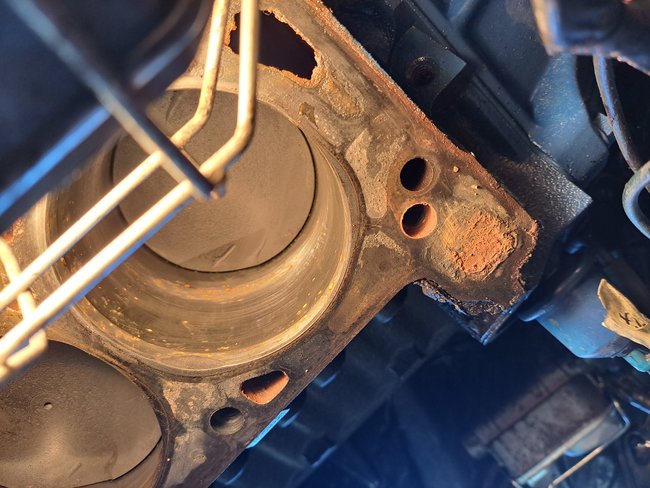

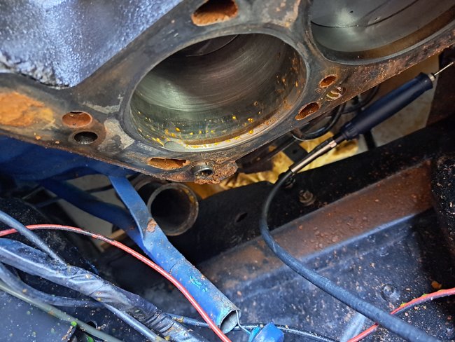

It looks like it was chamfered to slide the piston in, and the sleeve has a ridge at the top of where the piston ring stops on the changed sleeve or liner. The gaskets were put on wrong, so it did not get coolant from the second cylinder back. I was shown this on a YouTube video to be sure to put the gasket on correctly. So, this is most likely why this cylinder failed got overheated and melted.
So, this cylinder is not perfect but works to this point so I will connect back in the new piston is coming and will put everything back together. The shipper is overnighting the piston but where we live it takes 3 days LOL. Everything should be back together on Friday. I will have gaskets for the intake which should reduce the oil burn, a full piston should help reduce blow-by.

  • 110,241 POSTS
Thanks for the update. I'm looking forward to Friday to seeing how things turn out for you.
Let me know. Also, I would rub some oil on the cylinder wall to prevent it from rusting.

Yes, me too. the red you see is mostly old coolant dye that was stuck in the heads and block after sitting stagnant for years because the gaskets were wrong.

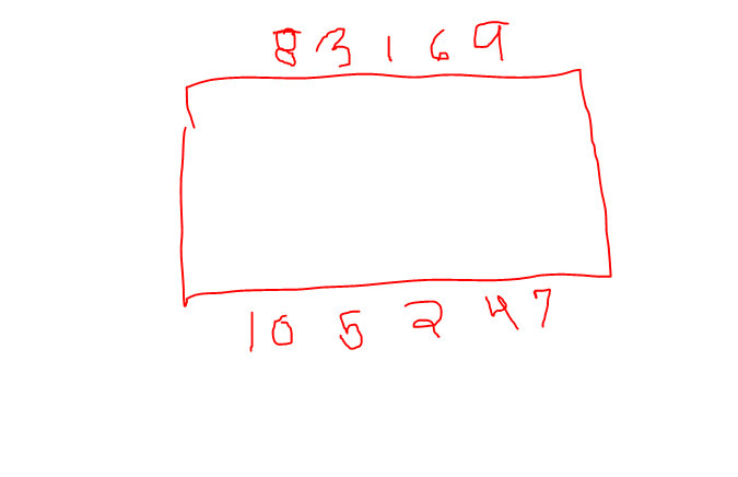

Is the oil pan torque?

Because of the model year, I don't have that info. What type of gasket is being used? Also, make sure to take a ball peen hammer and tap each of the bolt holes so they aren't bent upward towards the block. From being tightened over the years, they bend inward. Make them as flat as you can.
As far as torque, if you have a rubber gasket, I always work from the center outward (see the very generic pic below that I drew). Simply snug them first. Then, go around the pan in the same sequence and tighten them. I always use a 1/4" drive so I don't overtighten them. Pay attention when tightening. Make sure the gasket isn't squeezing out.
If you have a cork gasket, all I can say is Ugh. LOL Snug it, gently tighten it and wait for about 30 minutes and retighten it. Don't overtighten it because it will split. After it's installed, expect a leak within a year. LOL
Let me know if this helps.
See the pic below (sorry it's so elementary) I'm no artist. LOL
